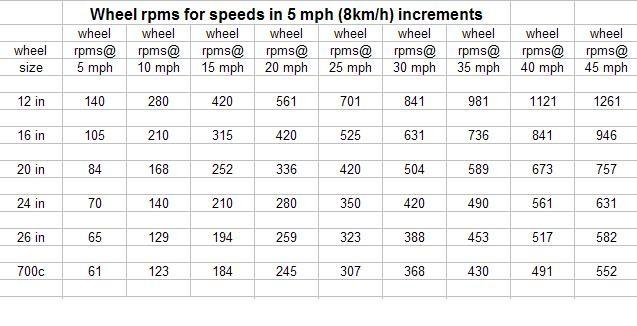

BOB ELLISON 2,983 #5 Posted August 19, 2018 (edited) My thoughts exactly as @JAinVA. The tires and rims used on the riding mowers or small tractors are not for hyway use. There made thinner then a regular trailer tire. And they exceed 1200 RPM’S at hyway speeds can and do separate when hot. Here's a chart and as you can see it only goes up to 45 Mph. Edited August 19, 2018 by BOB ELLISON 4 Share this post Link to post Share on other sites
illinilefttackle 399 #6 Posted August 19, 2018 Thanks Guys- I've been around pee patch a few times & would never just use a wheel or anything that was not approved. Thats why I asked those who know. Thanks again. My worries on the spacers is not that puts a lot on strain on the elongated lugs to mount them. - Al Share this post Link to post Share on other sites
