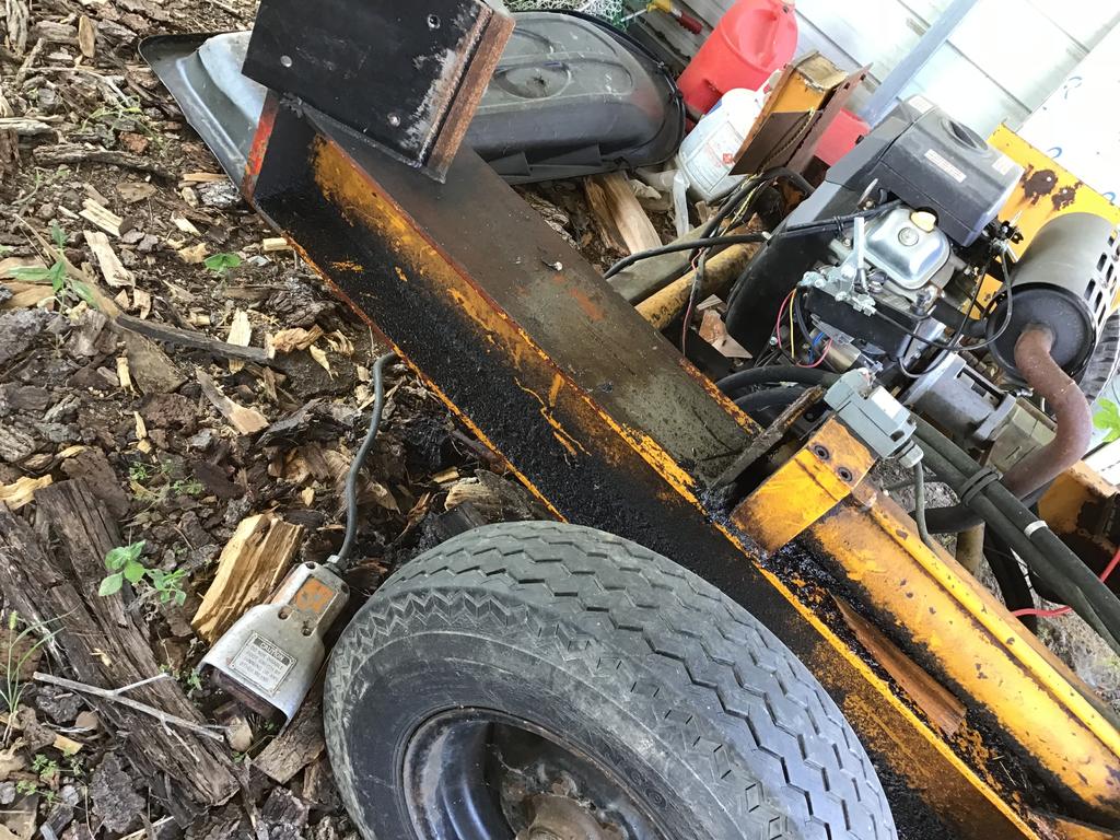

redbeard22 123 #78 Posted August 23, 2018 18 minutes ago, pullstart said: That splitter is awsome. Does it have a standard 2 stage pump or is it single? If its not single you deffinetly have enough power to run a single stage and split wood super fast. I bet that foot pedal is nice too not having to mess with a handle. Does it automaticly retract qhen you let off? 1 Share this post Link to post Share on other sites

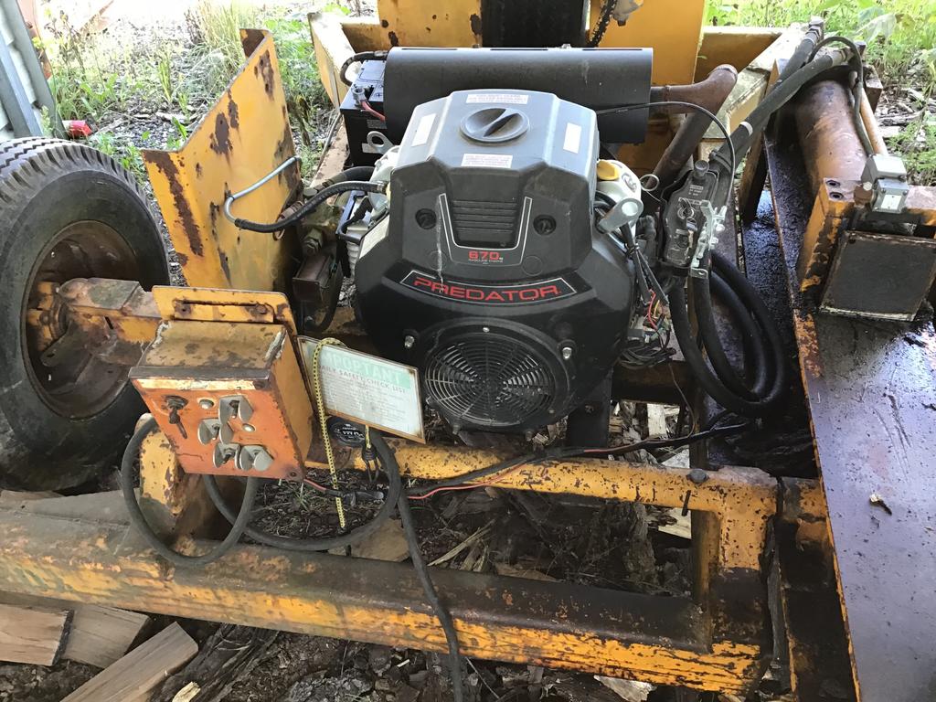

WHX?? 58,327 #80 Posted August 23, 2018 Since that motor is often replacing an Onan I would guess at least a 20 amp charge coil. Maybe 30? Couldn't find it in the manual. Share this post Link to post Share on other sites

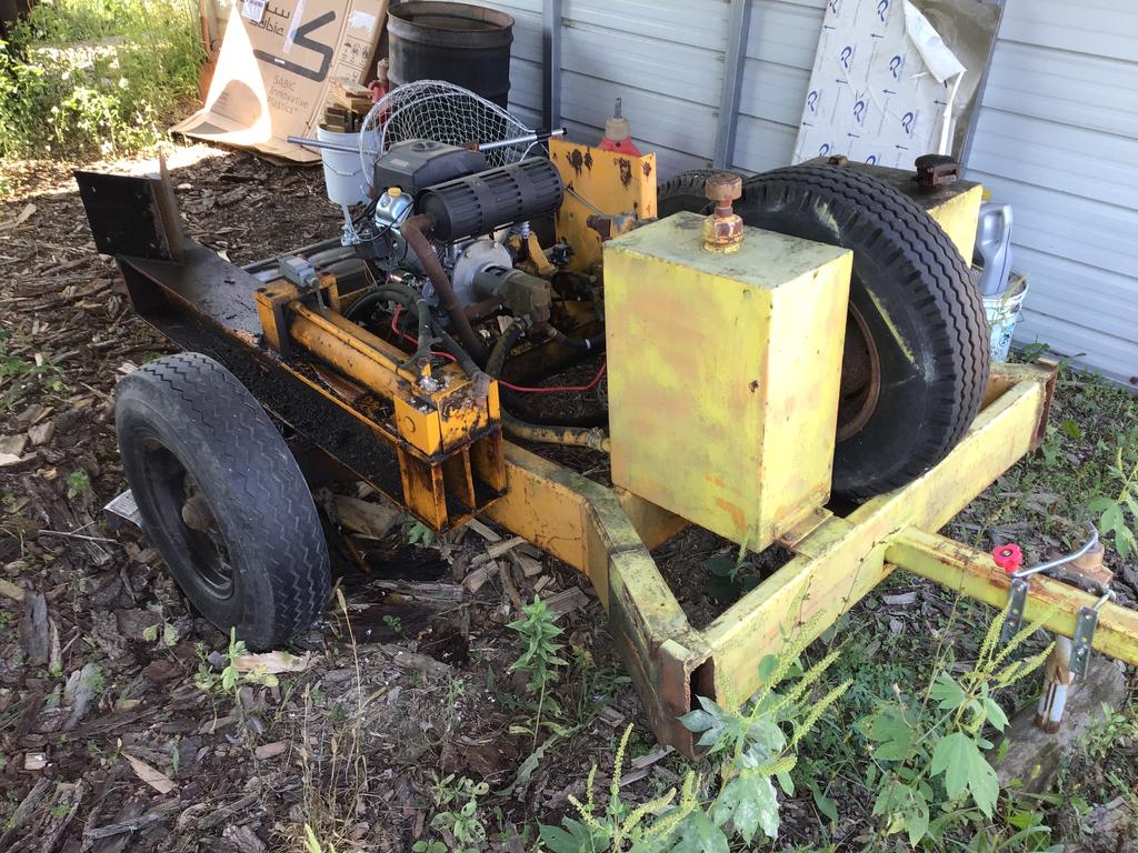

Pullstart 71,482 #82 Posted August 23, 2018 30 minutes ago, redbeard22 said: That splitter is awsome. Does it have a standard 2 stage pump or is it single? If its not single you deffinetly have enough power to run a single stage and split wood super fast. I bet that foot pedal is nice too not having to mess with a handle. Does it automaticly retract qhen you let off? Theres a proximity switch on the ram, so as soon as the foot pedal or switch is released, it automatically retracts until it hits that proximity switch again. I think it’s single stage, but I haven’t needed to work on it yet, so I couldn’t say for sure. The guy who built it used an old scissor lift as a start, so there are wires everywhere that are unused and should be cleaned out of the harness some day. 1 1 Share this post Link to post Share on other sites

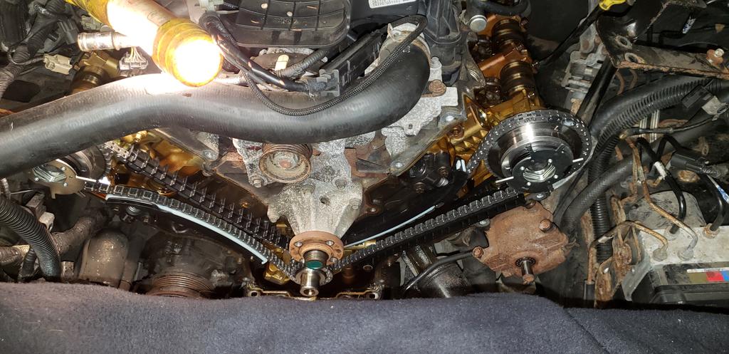

redbeard22 123 #84 Posted September 5, 2018 Dont worry i havent given up on this project just been busy working on a few customer vehicles trying to get them out of the way then its back to tractor building. How would you guys like to tackle this mess. 2 Share this post Link to post Share on other sites

redbeard22 123 #87 Posted September 6, 2018 14 hours ago, RandyLittrell said: No thanks! I work in the body shop of a chevy dealer and when they have some of those torn down, I'm glad I work in the dept. I do! Randy This job isnt to bad the worst part was getting the valve covers off. Everything else is a breeze. The timing components have little marks on them to get everything lined up and when your done spin the engine over 2 times with a big ratchet and if everything still lines back up then its good to go. I got another job coming in after this one new active fuel managment delete kit to put in a tahoe but hopefully ill get a few days in between to work on the horse build. Ill definitely have some new pics of whats goin on i want to get the jack shaft and engine mounted then hopefully the steering sorted out. 1 Share this post Link to post Share on other sites

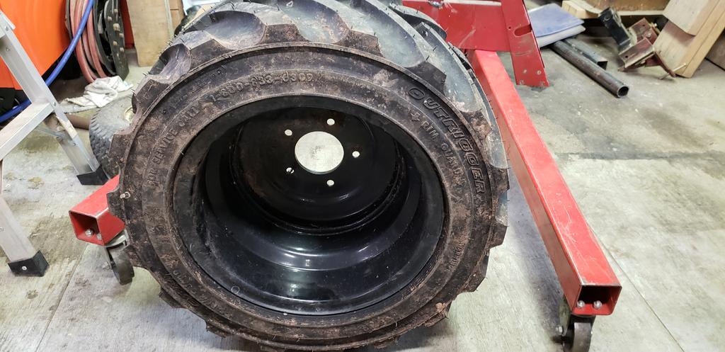

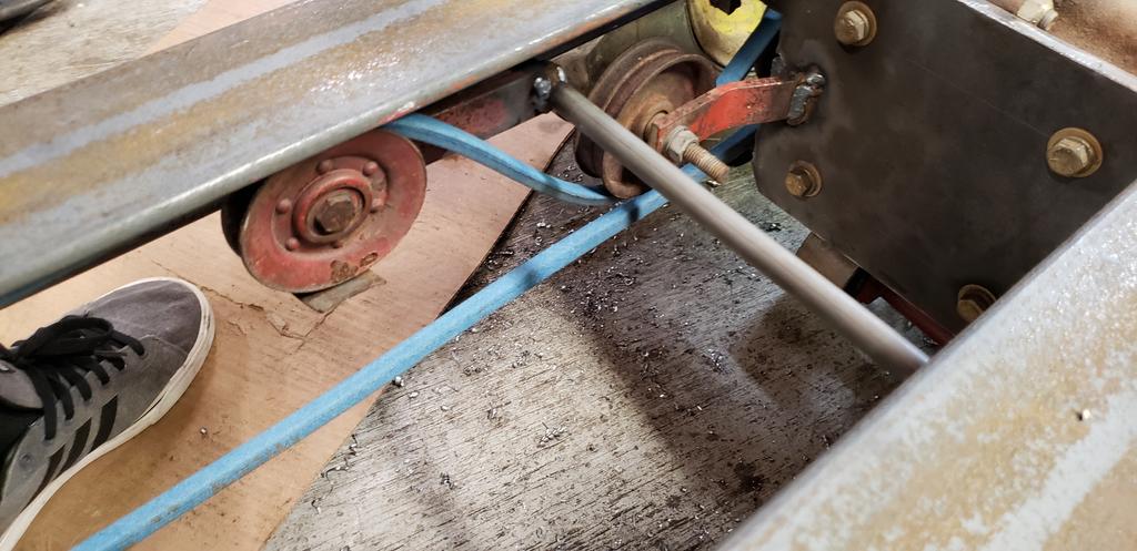

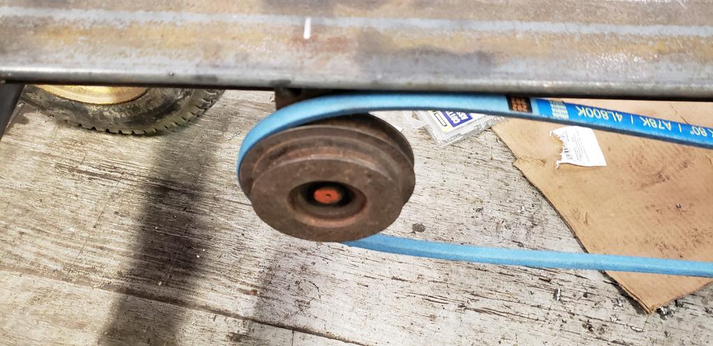

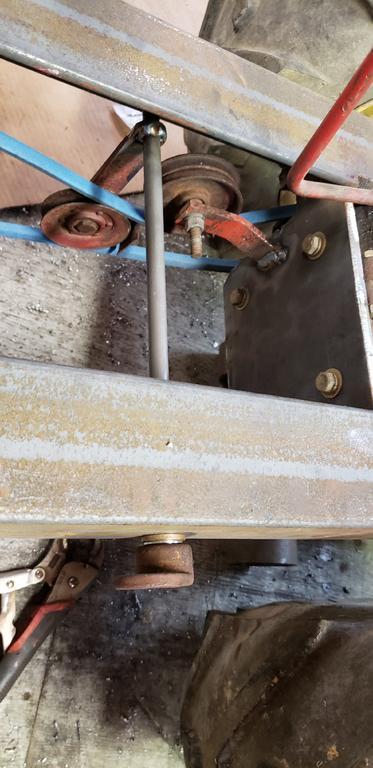

redbeard22 123 #89 Posted September 15, 2018 Got some more work done today clutch/belt tensioner is done similar to original style wheelhorse, drive belt runs inside frame to a seperate idler that will have a belt that runs up to crank pulley on engine. I will also be installing another idler to take up the slack in the drive belt. Also got the rear tires just need to redrill mounting holes to smaller pattern. The clutch shaft is removeable by taking out cotter pin and roll pin then removing brass bushings on either end then it slides out of the frame. Ill have pics of one of the tires bolted on tomorrw. Then i need to get started on the steering. 3 3 Share this post Link to post Share on other sites

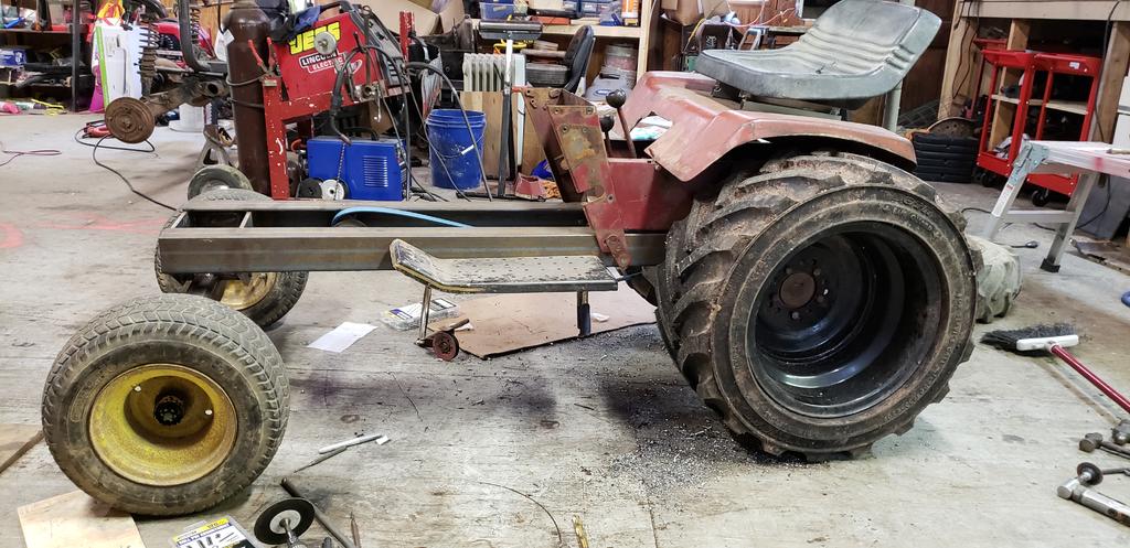

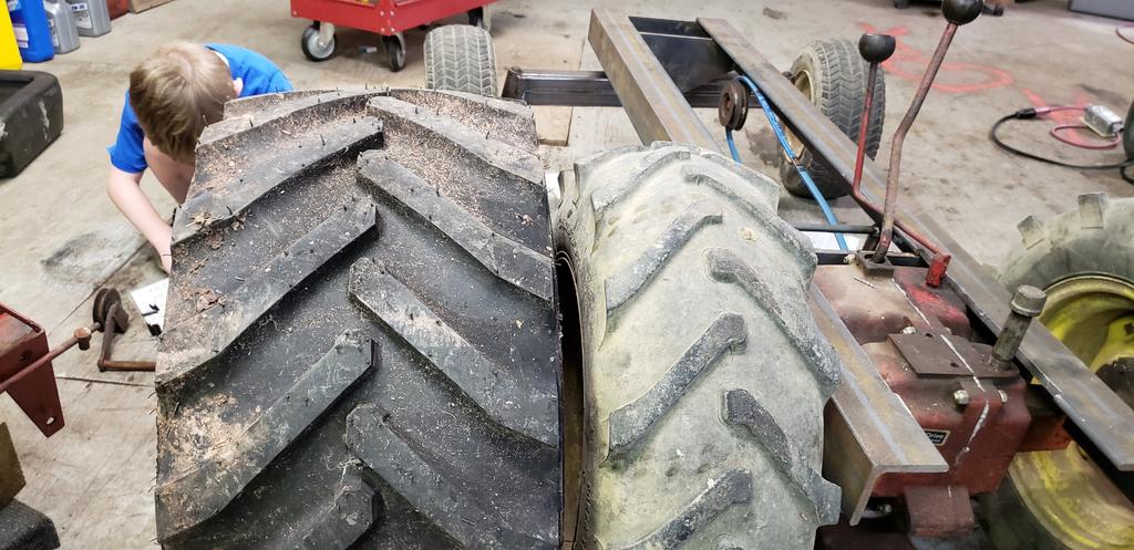

redbeard22 123 #93 Posted September 16, 2018 Ok got one of the wheels redrilled and bolted on ill get the other one done possibly tomorrow. Im gonna need to get some spacers as it sits in 1 inch farther than the front. The new tires are perfect. With those on the frame sits level and looks awsome this thing is gonna be a beast. Let me know what u guys think. By the way im case anyone was wondering that tire is on a 15x10 wheel and tires are 26x12 and they are heavy. Once i get them filled and find a set of weights I shouldnt have any traction problems 3 4 Share this post Link to post Share on other sites
