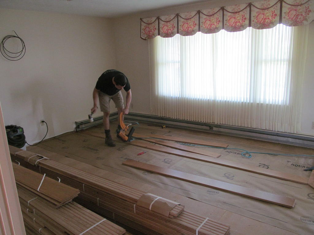

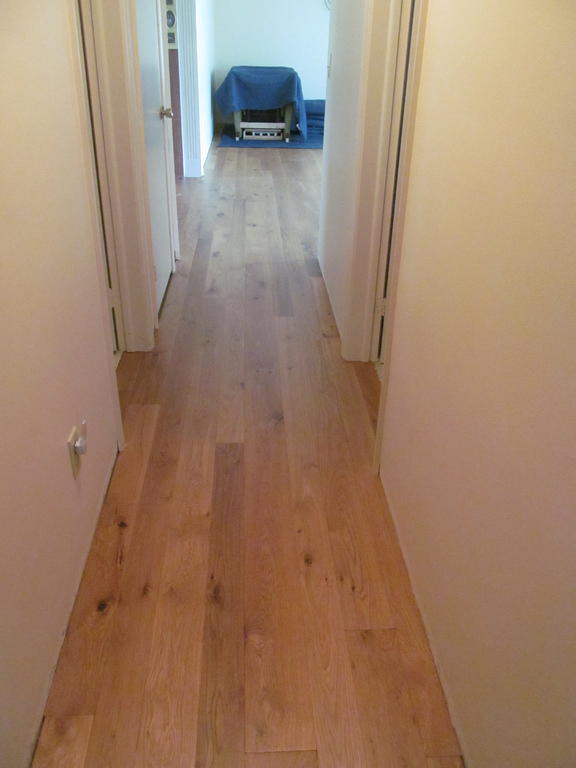

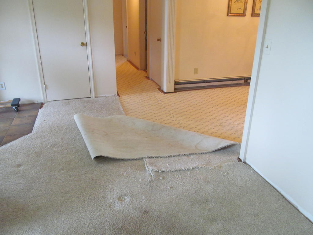

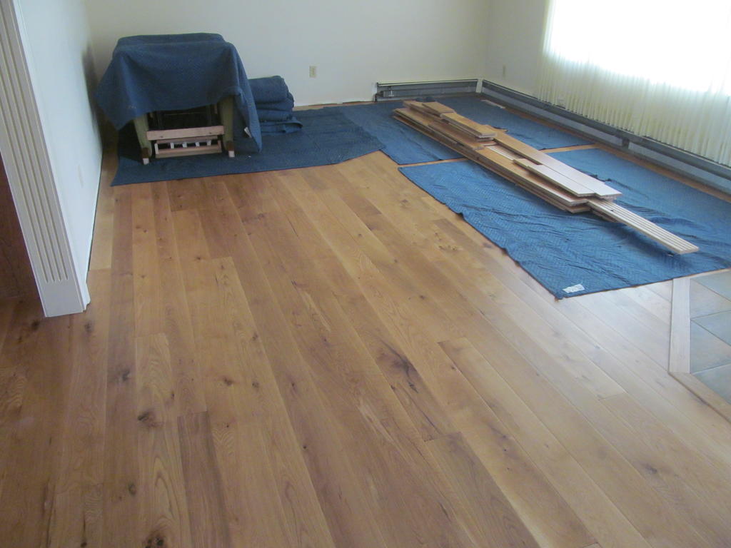

Ed Kennell 45,089 #1 Posted August 18, 2018 Finally completed a big item on the Honey - Do list. Mrs K decided she wanted to replace the worn carpeting with hardwood flooring. After several months of research, we decided to go with a local mill that makes custom flooring. We selected white oak lumber from Cameron Co Pa. The lumber was cut to 4,5, and 6" wide boards and planed to 3/4" thickness. The tongue and grooves were then milled on sides and ends of the boards and stress relief grooves on the under side. The boards were then prefinished with a hard wax oil finish that is instantly cured with an LED lighting system. The finish comes from Denmark where it has been used for decades. The boards then had to be stored in the house for 10 days until the moisture content in the new boards and the old subfloor stabilized and were within 1% of each other. I hired a finish carpenter to do the installation. My job was to remove all the furniture in the house.....remind me to never move. Although living in the garage for 6 weeks was interesting. Remove all the baseboard, trim, baseboard heater fronts, carpeting, padding, tack strips and staples, multiple layers of vinyl flooring and underlayment. Paint the entire house before installing the new flooring. Clean the feet of all the furniture and install felt pads to prevent scratching the floor. Sand, paint, and reinstall all the trim and heaters. A few pics of the project. 10 8 Share this post Link to post Share on other sites
ebinmaine 77,594 #2 Posted August 18, 2018 Ed, that looks absolutely fantastic! You folks are going to love that hardwood floor. Most of the upper story of my Ranch is covered with knotty yellow pine flooring. I love the look of it. 3 Share this post Link to post Share on other sites

WHX?? 55,357 #17 Posted August 20, 2018 Looks nice Ed. You guys are spot on about carpet be dirt magnets. Smooth floors much easier to keep clean not to mention when fido has an "accident" Looks like you got hydronic heat. Hope you had the presence of mid to clean those fin tubes while you had the covers off. Soft bristle paint brush & good shop vac work best. How did the covers line up after flooring? Tool crib is right smooth floor let the convection process work better. You might be able to lower your water temp saving $$ on fuel. 2 Share this post Link to post Share on other sites
Ed Kennell 45,089 #18 Posted August 20, 2018 Yeah, Mrs K pretty much follows me with the Swiffer. I did brush the heat pipe fins Jim...they were loaded with dust. I didn't have to alter the end covers. The new wood floor is the same height as the carpet and padding was, so I have the same height opening at the bottom of the heater fronts. 1 Share this post Link to post Share on other sites
WHX?? 55,357 #19 Posted August 21, 2018 15 hours ago, Ed Kennell said: they were loaded with dust Those baseboards are designed to put out 560 btu @ 180 degree hot water flowing through them. As they get dirty this drops off dramatically making one increase the water temp to decently heat meaning more $$ in home heating costs. The good news is back in the day these single story ranches were often over radiated. These baseboards were cheap in the day so installers often used way too much footage of it. As homeowners replaced windows, doors, weather seal, insulation etc. making the house more efficient meaning you can cut the water temp back to say 160-170, a huge decrease in fuel costs. Your front room appears to be an example of being over radiated. 2 Share this post Link to post Share on other sites
