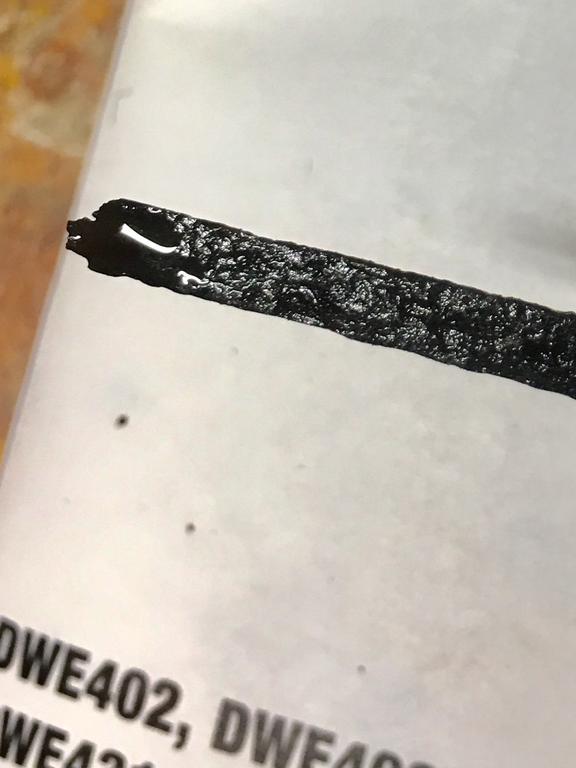

 Here's a pic of my dipstick out of my 312-8 that I just picked up. I called this  tractor my hundred dollar turd but it obviously was abused and sat out in the weather a lot. The dipstick was rusted out really bad so I wasn't sure  if any water got into the transmission. After a couple of diesel fuel fill ups  and drive arounds the trans seems to be ok. The old fluid  didn't have a lot of water in it. So  hopefully he's OK !
