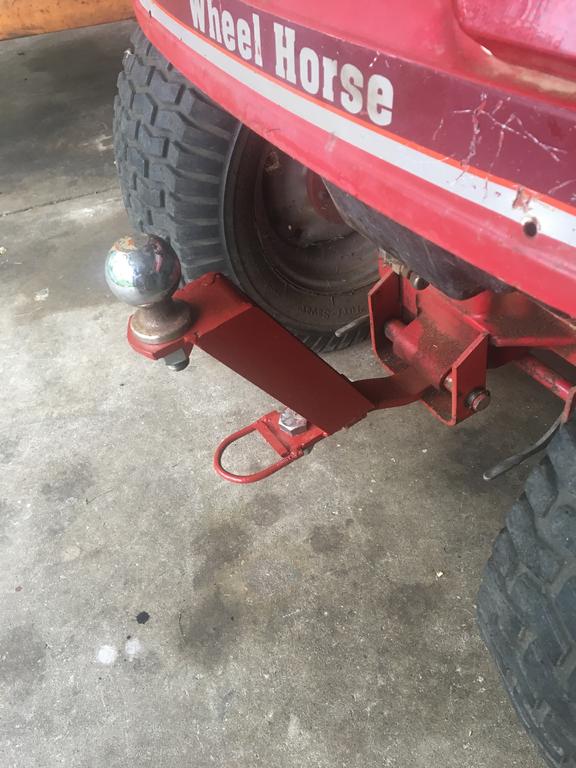

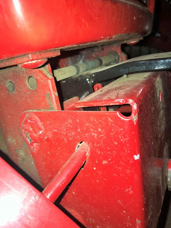

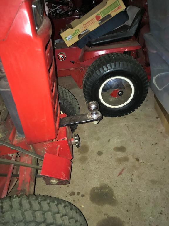

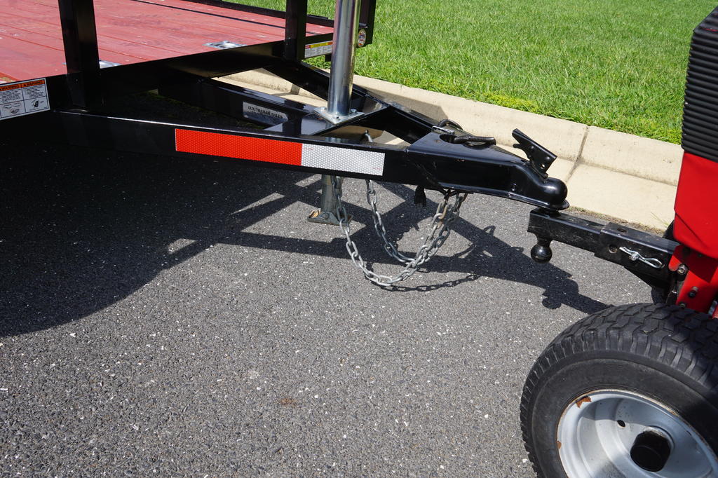

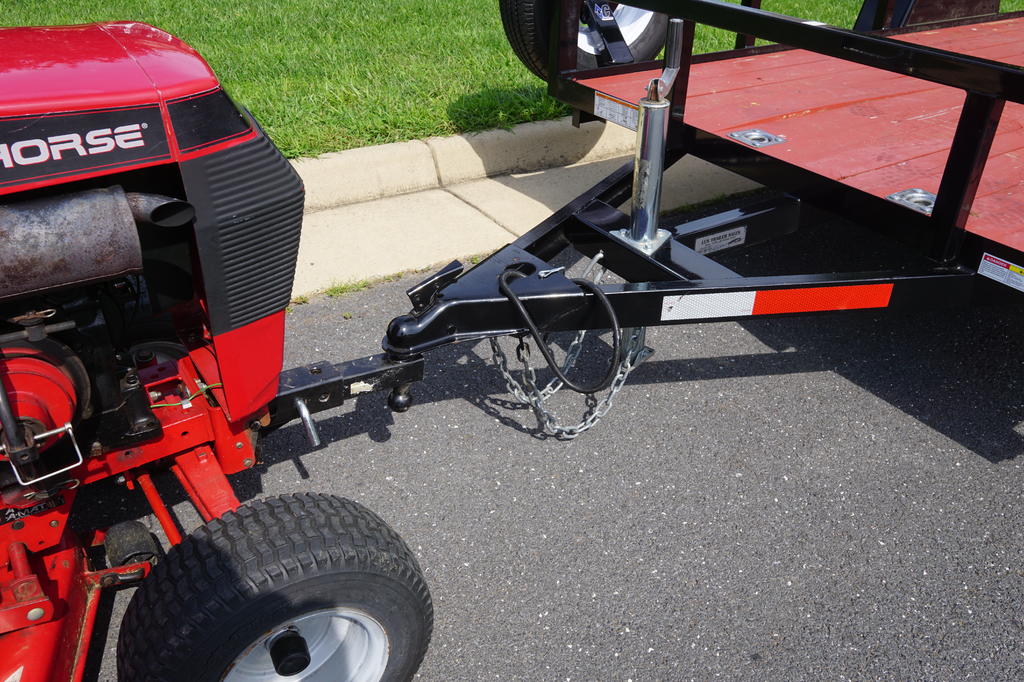

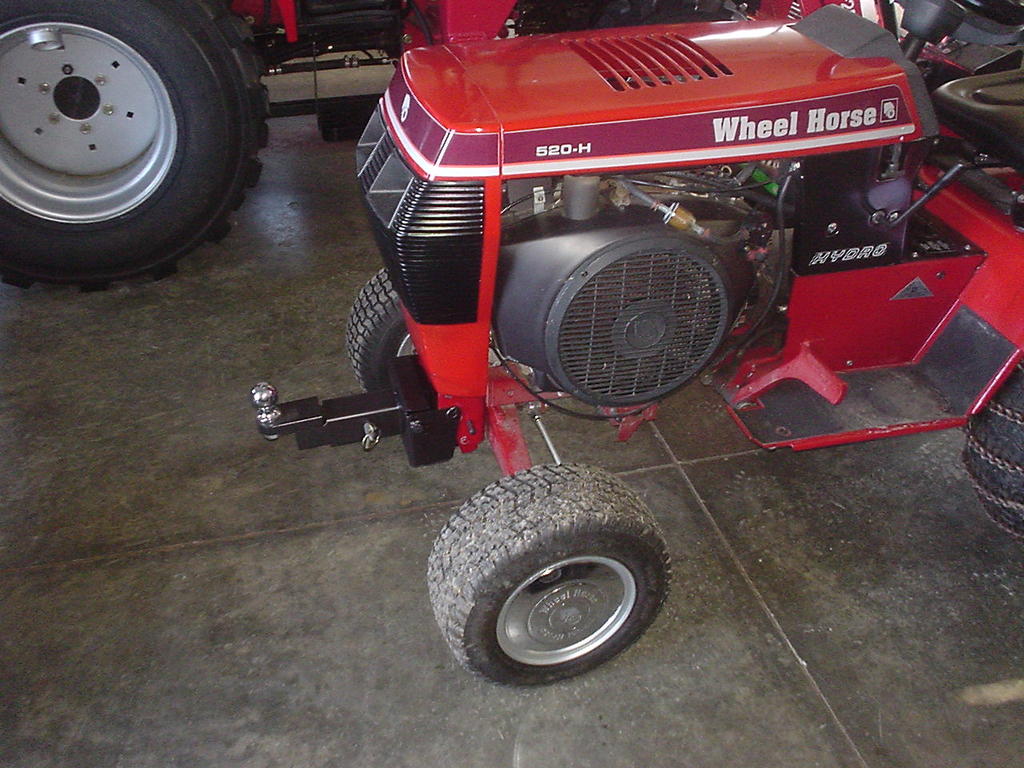

Lane Ranger 12,167 #4 Posted August 16, 2018 I bought two of the front ball hitches sold by a guy in Rhode Island making and selling them on Ebay. First one I installed on my 314 -8 tractor that I use with a tilelr in my garden. I went on easy. This hitch has a flat plate that bolts up to the bolt holes on the front attach-a-matic. Works great and you can keep your mower mule drive on the tractor. The second one I bought went on my B-80 and I did have a clearance problem and the guy in Rhode Island fixed it. The first four photos are of my 1975 B-80. The fifth photo shows the hitch on the front of the 314. These front hitches make moving a trailer a breeze! 2 Share this post Link to post Share on other sites

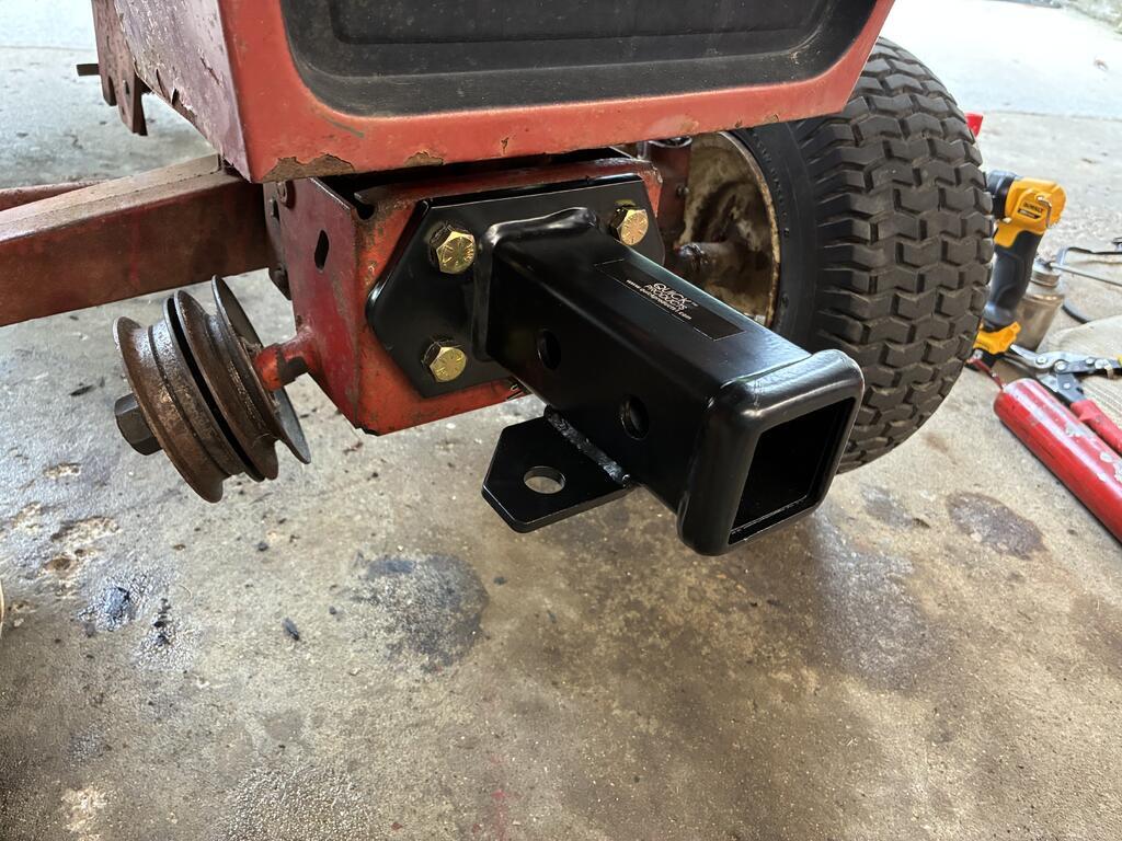

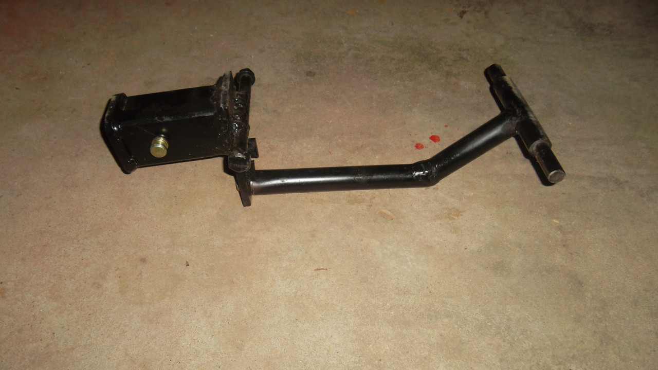

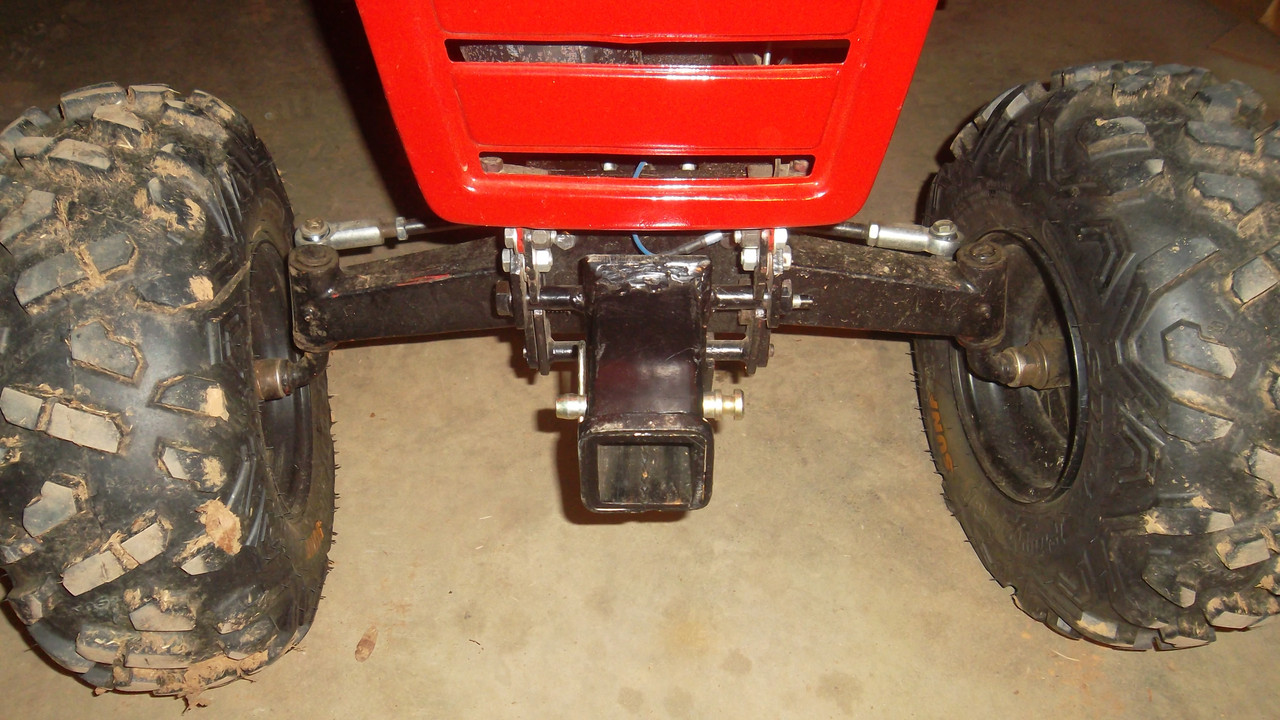

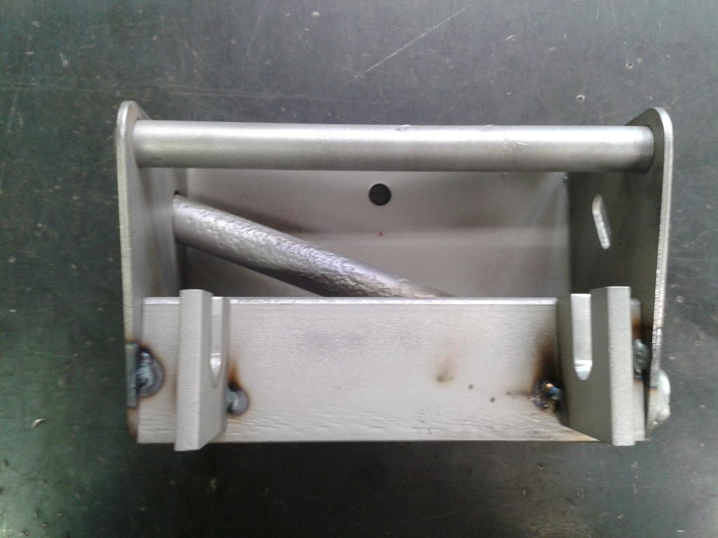

cleat 9,450 #5 Posted August 16, 2018 (edited) I built this one from an old mule drive. Works great, the only problem is that if the trailer is too heavy the front end can get pushed sideways. Here it is tacked together for trial fit (it fit great). Here it is installed with a receiver and ball installed into it. Here are the plans I drew up. Receiver tube measurements.pdf Wheel Horse measurements for front hitch.pdf Wheel horse parts list for front hitch.pdf Cleat Edited August 16, 2018 by cleat 3 Share this post Link to post Share on other sites
clueless 3,440 #6 Posted August 16, 2018 8 hours ago, Lane Ranger said: I bought two of the front ball hitches sold by a guy in Rhode Island making and selling them on Ebay. First one I installed on my 314 -8 tractor that I use with a tilelr in my garden. I went on easy. This hitch has a flat plate that bolts up to the bolt holes on the front attach-a-matic. Works great and you can keep your mower mule drive on the tractor. The second one I bought went on my B-80 and I did have a clearance problem and the guy in Rhode Island fixed it. The first four photos are of my 1975 B-80. The fifth photo shows the hitch on the front of the 314. These front hitches make moving a trailer a breeze! Got one of those on my 312 works great. Can handle 300 lb tongue easily, move my power and sail boat around and my 5 x 10 trailer. I have moved my neighbors 24 ft RV with it, tongue was probably 400 +lb, don't know if I would do that often, but it did move the RV easily. The guy also sells front hitches that attach to front after you remove the mule-drive, one is for 2" receiver, I have that one also, but I really like the one that attaches permanently without removing the mule-drive. E-bay/ wheel horse hitches. 1 Share this post Link to post Share on other sites

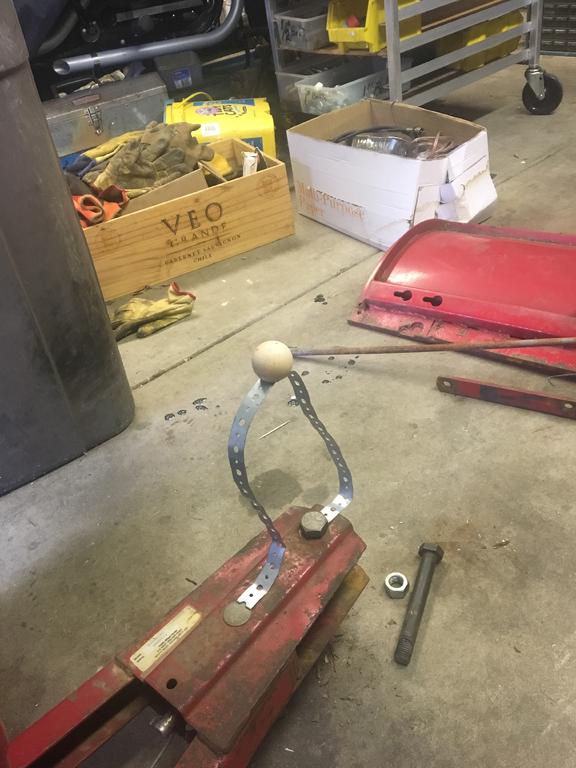

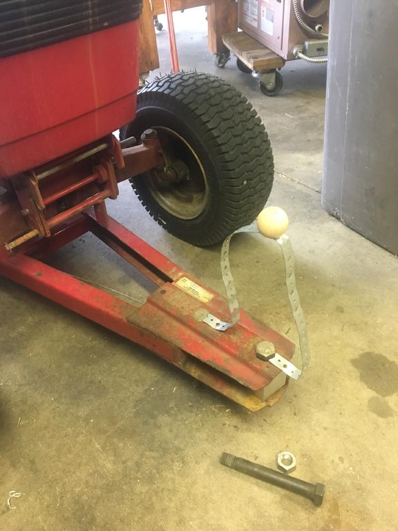

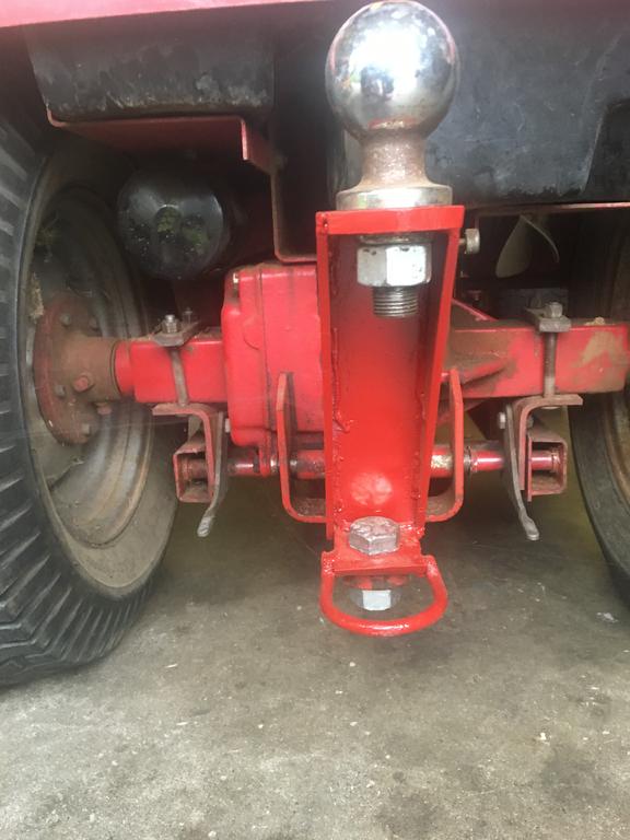

56servi 67 #9 Posted August 16, 2018 Thanks for all the pictures I did a mock-up of I am going to try. If it doesn't work I am on to plan B. I only need to move my boat back into the tent, When I pull it out I can attach it directly to my truck The last 2 pictures are the one I made for the rear. I made a rear hitch that attached to the rear axle but I couldn't use it with the plow frame attached to the back 2 Share this post Link to post Share on other sites

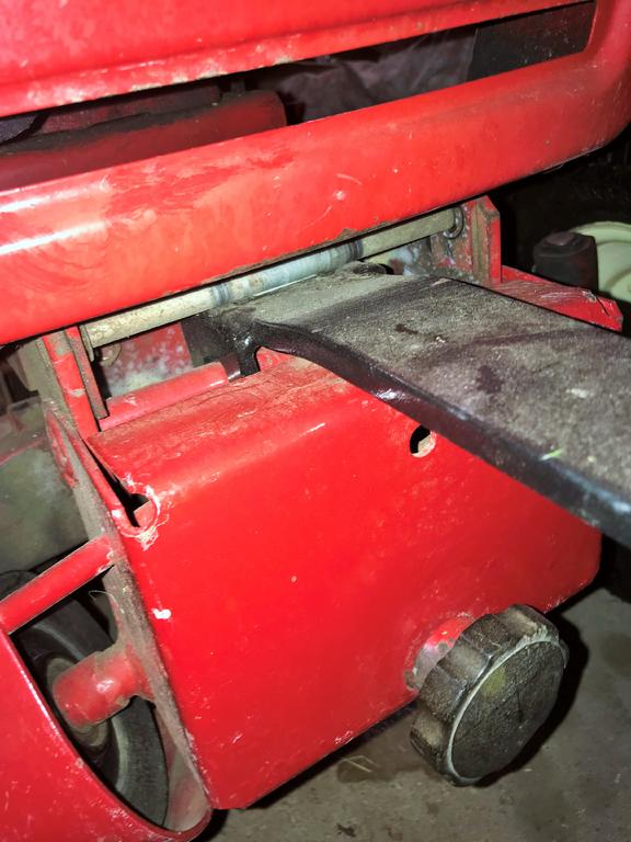

SylvanLakeWH 32,921 #12 Posted October 11, 2025 Here's one I just made out of an old front mule drive... Works like a charm. 1 Share this post Link to post Share on other sites

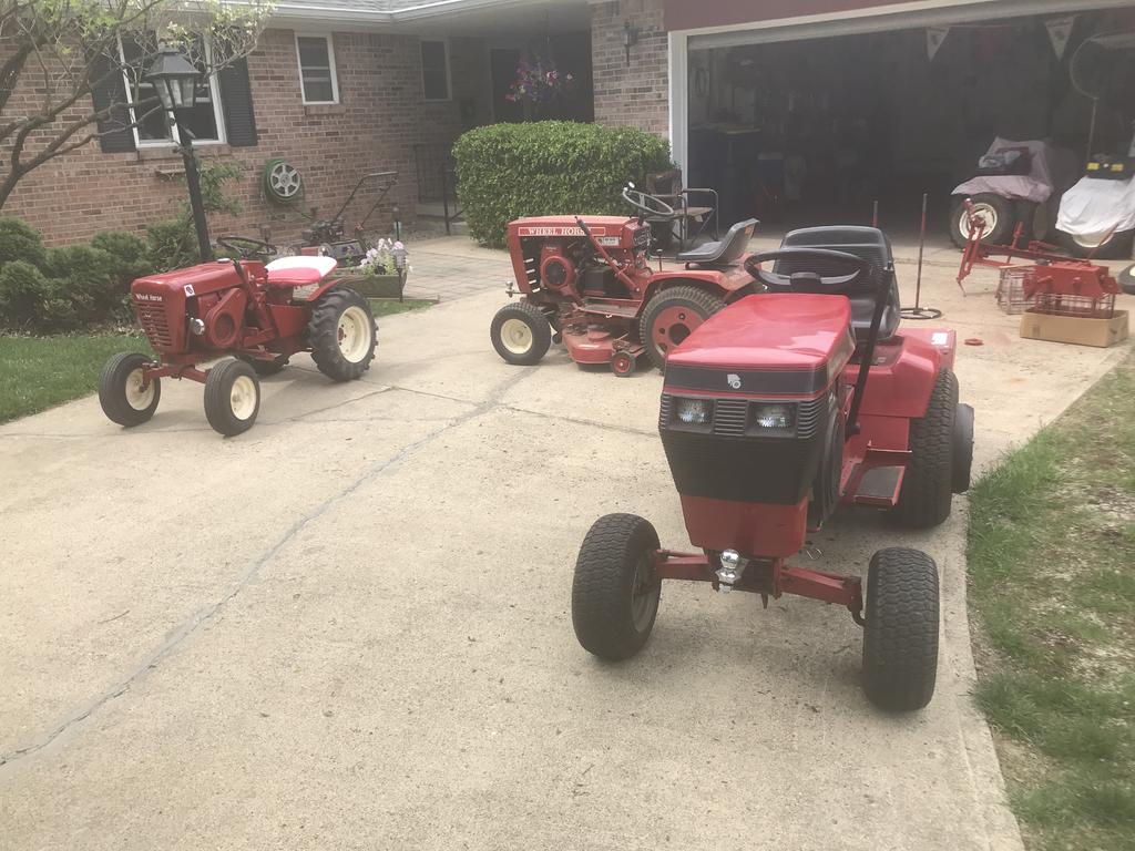

Bill D 3,213 #15 Posted November 14 Here's my entry. Not as easy to install and remove as I'd like, but I was in a hurry and it works well. 1 Share this post Link to post Share on other sites

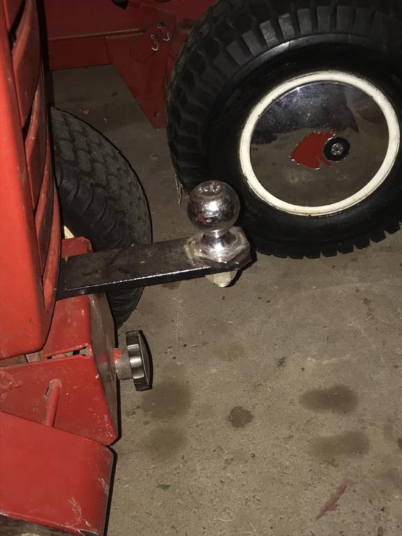

Bar Nuthin 3,645 #16 Posted November 15 (edited) This one I made works really well (despite the hideous welds) I also have one of the permanent mount ones like in @Lane Ranger's post, that I would part with if someone needs it. On 8/15/2018 at 10:46 PM, Lane Ranger said: I bought two of the front ball hitches sold by a guy in Rhode Island making and selling them on Ebay. Edited November 15 by Bar Nuthin 2 1 Share this post Link to post Share on other sites
