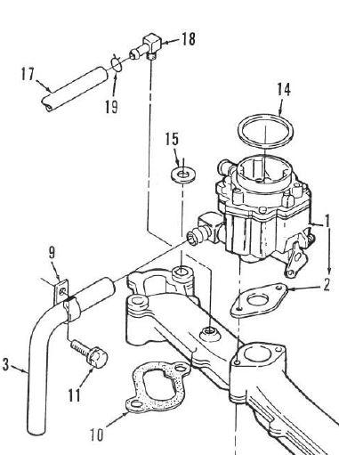

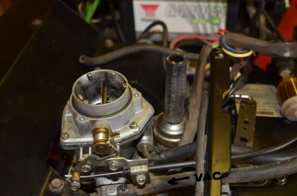

Schrec050584 2 #1 Posted August 15, 2018 Where does the hose off the vaccum guage run to on a 520h Share this post Link to post Share on other sites
WHX?? 54,501 #2 Posted August 15, 2018 First off Schrec It runs to a port on the intake manifold under the air cleaner. There will other members chiming in to welcome and will hopefully post a pic. @cleat may have a photo. Share this post Link to post Share on other sites

WHX?? 54,501 #4 Posted August 15, 2018 4 minutes ago, Schrec050584 said: anyone have a wiring diagram No problem, post the model & serial number and we can get you the whole manual. Light problem is most likely the switch but do check the fuses, A manual would help you out with that. Not a pic but from the IPL. The hose connection just in front of the carb. #18 You must take off the air cleaner to get at it. Share this post Link to post Share on other sites

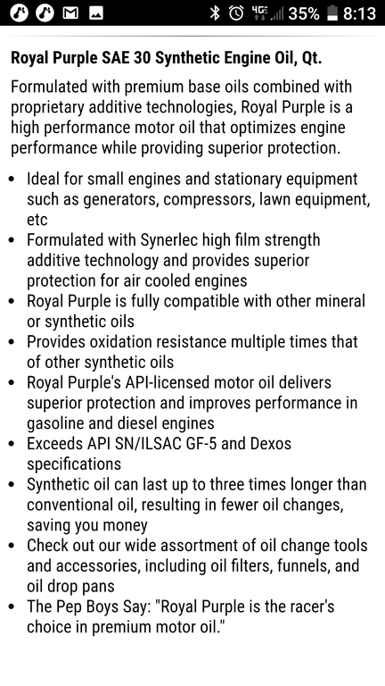

Kurt-NEPA 756 #19 Posted August 16, 2018 1 hour ago, WHX20 said: Kurt and I run them in winter for sno blowing. So right you are Jim. I use my 522xi for mowing and my 520H for snow blowing. Leave then set up that way all year. The other problem I have is that you cannot buy 30 wt synthetic oil. At least I can't find it. And I like to use synthetic oil for the hot summer mowing. 1 1 Share this post Link to post Share on other sites
Arthur England 5 #20 Posted August 16, 2018 (edited) Not the best picture as it was taken for one of my own problems on my 520H. Looking from the front with the air cleaner base removed.the vacuum line is at the bottom of the pic. Arthur Edited August 16, 2018 by Arthur England Incorrect file format 2 Share this post Link to post Share on other sites

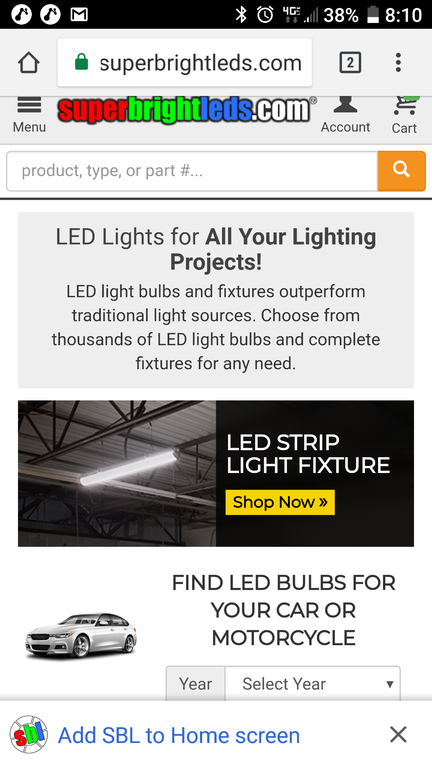

oneroadkingman 53 #22 Posted August 16, 2018 Hello,if you go to superbrightlites.Com they are great people to work with,and search for part #par 36 that's what u need for your headlights. And while your at it u might want to change out your dash lights to led part #BA9S-90-120VAC, I have done this also with mine and wow what a difference they make. Share this post Link to post Share on other sites
953 nut 63,920 #23 Posted August 17, 2018 58 minutes ago, oneroadkingman said: go to superbrightlites.Com Can you post a link please, did a search and came up empty. Share this post Link to post Share on other sites
WVHillbilly520H 10,377 #24 Posted August 17, 2018 7 minutes ago, 953 nut said: Can you post a link please, did a search and came up empty. Maybe it's "superbrightleds.com"... 1 Share this post Link to post Share on other sites
WVHillbilly520H 10,377 #25 Posted August 17, 2018 9 hours ago, Kurt-NEPA said: So right you are Jim. I use my 522xi for mowing and my 520H for snow blowing. Leave then set up that way all year. The other problem I have is that you cannot buy 30 wt synthetic oil. At least I can't find it. And I like to use synthetic oil for the hot summer mowing. @Kurt-NEPA try this... Share this post Link to post Share on other sites
