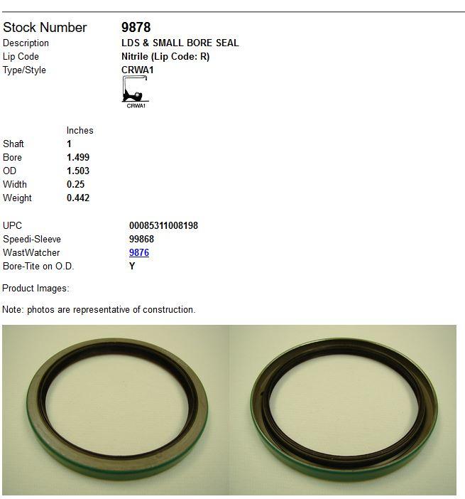

gwest_ca-(File Mod) 12,519 #5 Posted August 13, 2018 Click on the pictures 1974 tractor model 1-0510 axle seal WH # 100607 = SKF/Chicago Rawhide # 9878 - 1" ID, 1.5" OD x 1/4" wide 1975 tractor model 1-0511 axle seal WH # 100607 = SKF/Chicago Rawhide # 9878 - 1" ID, 1.5" OD x 1/4" wide WH # 6449 = SKF/Chicago Rawhide # 11124 - 1-1/8" ID x 1-5/8" OD x 1/4" wide Here is a SKF/Chicago Rawhide interchange for all seals http://www2.chicago-rawhide.com/popup_parts_lookup_457012.htm Garry Share this post Link to post Share on other sites

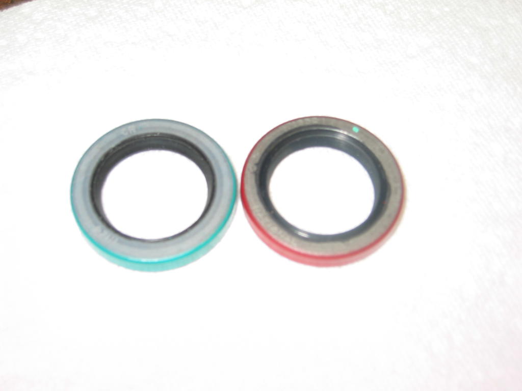

pfrederi 21,274 #7 Posted August 13, 2018 You might also try National (Timken) 471652. I started using those on my Sundtrands. The outer lip seems more pronounced...may keep more crap out CR green Timken red 1 Share this post Link to post Share on other sites

gwest_ca-(File Mod) 12,519 #15 Posted August 15, 2018 The 1974 B-100 Automatic parts list above states the transmission model is a 5090 on the second page that lists all the transmissions including the C120 and C-160 Auto models. So there is at least 2 automatic models with 1" axles. The 1975 manual is for the B100 Auto model only. Found 1972 Charger 10 model 1-0410 uses 5090 transaxle with 1" axles. 1973 10hp Auto model 1-0475 uses 5090 transaxle with 1" axles. 1973 10hp Auto model 1-0470 uses 5087 transaxle with 1" axles. Total now 5 automatic models using 1" axles I posted links to both B-100's because I did not know which B100 Auto he had. Garry 1 Share this post Link to post Share on other sites

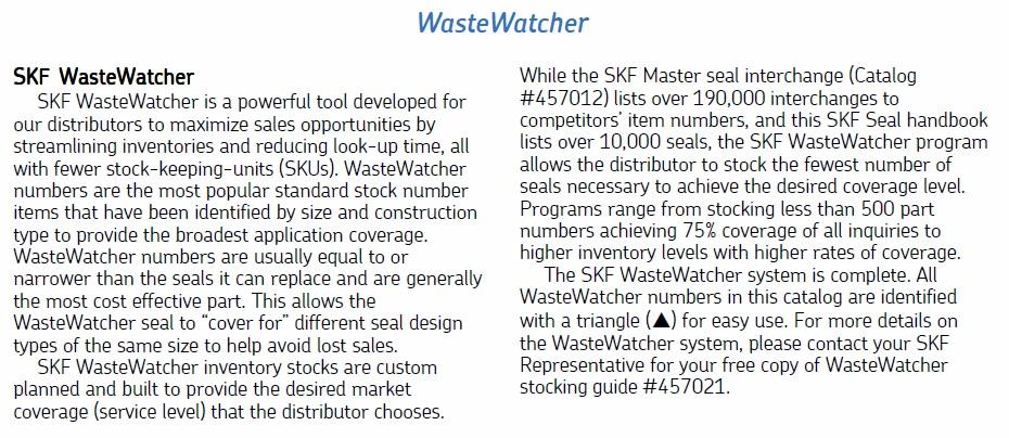

gwest_ca-(File Mod) 12,519 #16 Posted August 15, 2018 Always wondered what the WasteWatcher seals were. You will see it listed on the 9878 seal page posted above. Garry Share this post Link to post Share on other sites
