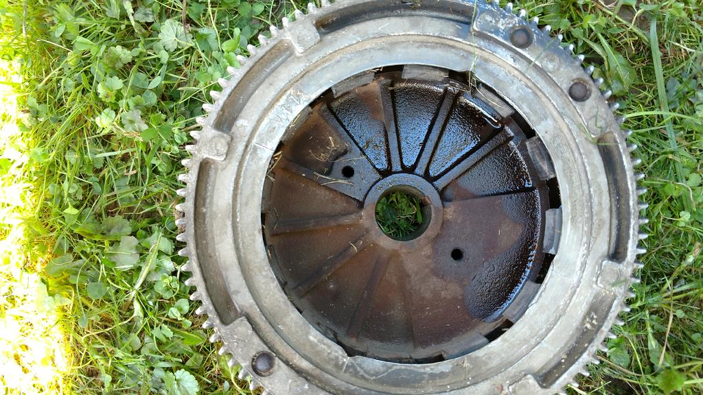

CountryRock 199 #28 Posted August 12, 2018 I'm actually starting to think that there may be a magnet that came out under the flywheel. I'm going to buy the puller and a strap wrench to hold the flywheel and pull it off and see. Share this post Link to post Share on other sites

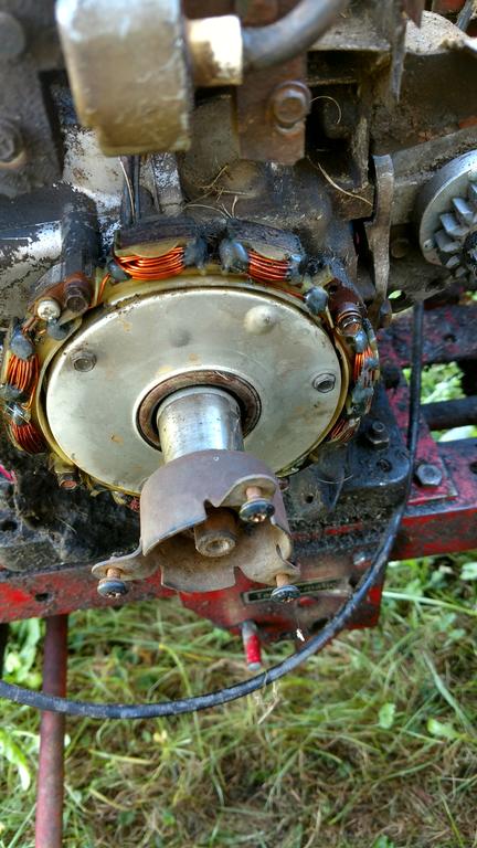

CountryRock 199 #32 Posted September 23, 2018 A little bit of an update on this engine. I pulled the flywheel today, didn't find anything out of the ordinary under it. Theres definitely something going on inside it. I had thought I dropped the flywheel key in the grass when I took it off, so I swept around with a magnet, but got nothing. It seemed like the flywheel could spin freely when it broke loose from the shaft. I'm almost wondering if someone else had it apart before and forgot the key and things went way out of time inside. We'll tell soon enough, I got all the external stuff off the engine, just need to power wash the gunk off and I can pull it off and bench it. 1 Share this post Link to post Share on other sites

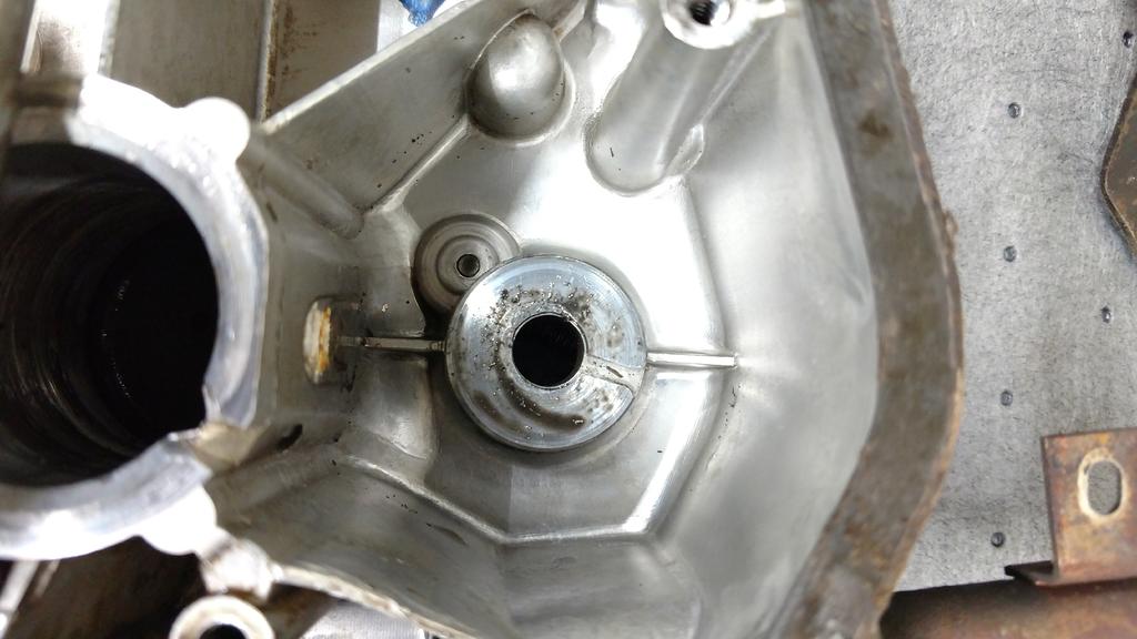

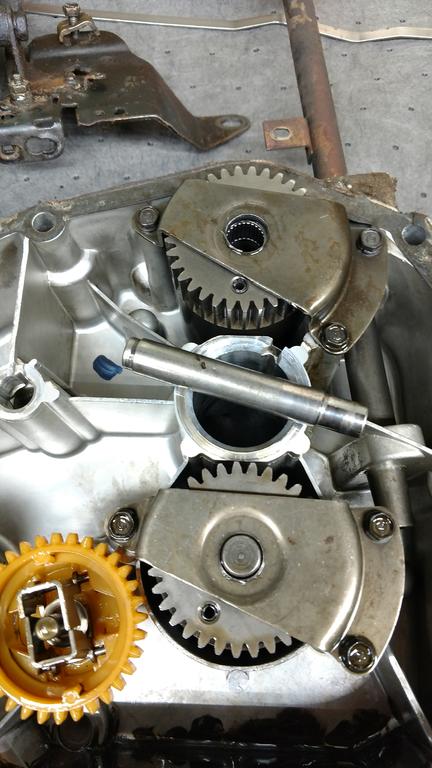

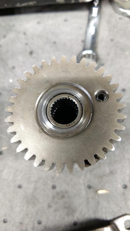

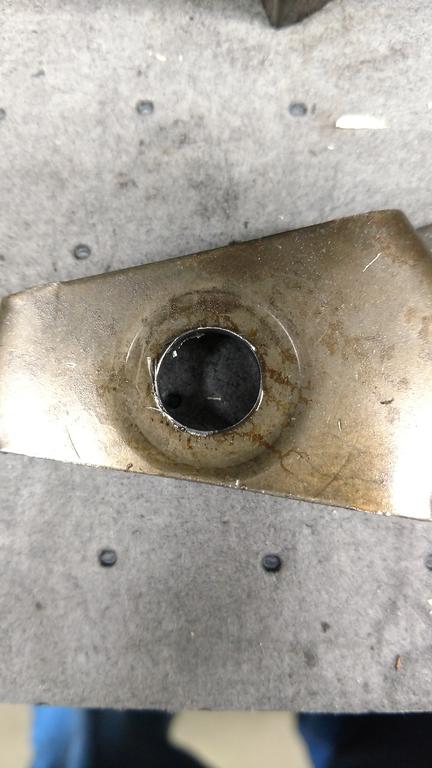

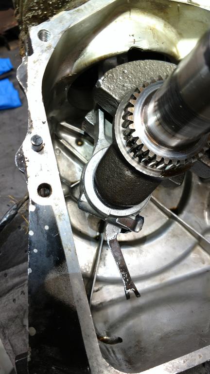

CountryRock 199 #38 Posted October 7, 2018 (edited) Got the engine on the bench and split apart. The issue was in the crankcase cover. Part names escape me at the moment, but there was a shaft that fell out into the sump when I split it. It looks like the hole it went into lost a bushing or something and jammed the gear up. Take a look at the pics. EDIT: The hole in the counterweight retainer got worn and the shaft mustve moved just enough to cock the counterweight gear and lock it up. Edited October 7, 2018 by CountryRock Added info. Share this post Link to post Share on other sites

CountryRock 199 #41 Posted October 8, 2018 Do I need to buy a whole new crankcase cover or does that shaft just press back into it? Share this post Link to post Share on other sites
