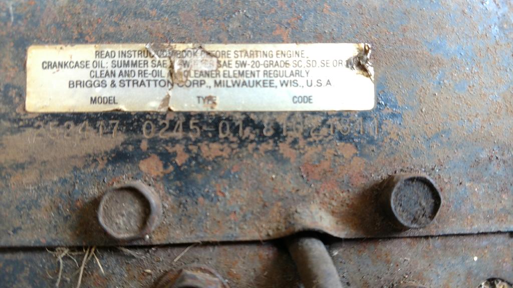

CountryRock 199 #1 Posted August 11, 2018 I have a Briggs & Stratton 11hp, model 252417-0245-01. When I turn it over by hand, via the flywheel cover, it rotates about a half turn and then stops dead on something, does it no matter which way I turn it. Does this sound like a broken connecting rod or is it something else, that I could possibly fix? If it's not fixable, what could I use to repower the tractor it's on, a 1981 GT2500? I have 2 of these tractors, one of them does run, I would like to get this one running if possible. Thanks. Share this post Link to post Share on other sites

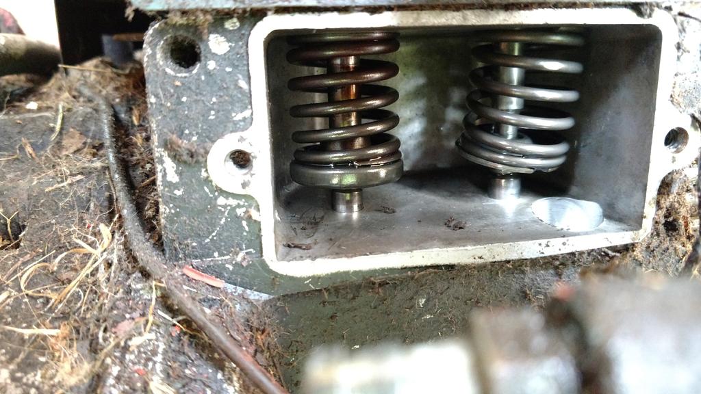

CountryRock 199 #15 Posted August 11, 2018 Under the breather cover. Share this post Link to post Share on other sites
cleat 9,056 #16 Posted August 11, 2018 I would pull the flywheel and make sure nothing is jammed under it, maybe stuck to a magnet. Share this post Link to post Share on other sites
The Gman 476 #17 Posted August 11, 2018 (edited) Maybe it's the angle but that exhaust spring doesn't look right. It's banked to the right. Almost like the keeper plate is shifted part way out of the slot. For sure pull the flywheel. Edited August 11, 2018 by The Gman Share this post Link to post Share on other sites
CountryRock 199 #18 Posted August 11, 2018 The exhaust valve does look off. I don't have tools to pull the flywheel. Share this post Link to post Share on other sites
