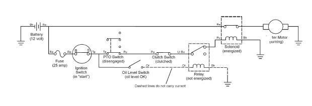

Red Bull Stripe 5 #9 Posted August 7, 2018 last night I was jumping it directly from the battery straight to the starter - not off another vehicle. Admittedly, I've jumped it off a running car, won't do that again! Before replacing the starter, I would get a single click or two, then it would start sometimes. Other times, it would click and nothing. Now there's nothing at all, and the voltmeter (on the tractor) doesn't move at all when in the start position. Both the 15 and 25 amp fuses are good. Share this post Link to post Share on other sites
FatJackDurham 318 #10 Posted August 7, 2018 47 minutes ago, Red Bull Stripe said: last night I was jumping it directly from the battery straight to the starter - not off another vehicle. Admittedly, I've jumped it off a running car, won't do that again! Before replacing the starter, I would get a single click or two, then it would start sometimes. Other times, it would click and nothing. Now there's nothing at all, and the voltmeter (on the tractor) doesn't move at all when in the start position. Both the 15 and 25 amp fuses are good. That sounds like the solenoid to me. ANyone else think so? Rotory starter solenoids are about $12 bucks at tractor supply. Have a look at how yours connects, see if its all bolts and nuts on all four terminals, or if the lower terminals are spades. Disconnect the batter while changing it, make sure your screws get a good ground connection. Share this post Link to post Share on other sites
Pullstart 71,008 #11 Posted August 7, 2018 My belief when it comes to electrical is to follow sequence of operations. This works with anything that is a circuit... water heaters, furnaces, vehicles, tractors, etc. Prove power, and prove parts, then you’ll find the problem. I think that accidentally jumping from the battery to the starter stud only proves that there is a ground and the battery is charged. Otherwise, there is no “I think” in troubleshooting... if you have a meter. In this case, a test light would do the trick. 1 Share this post Link to post Share on other sites

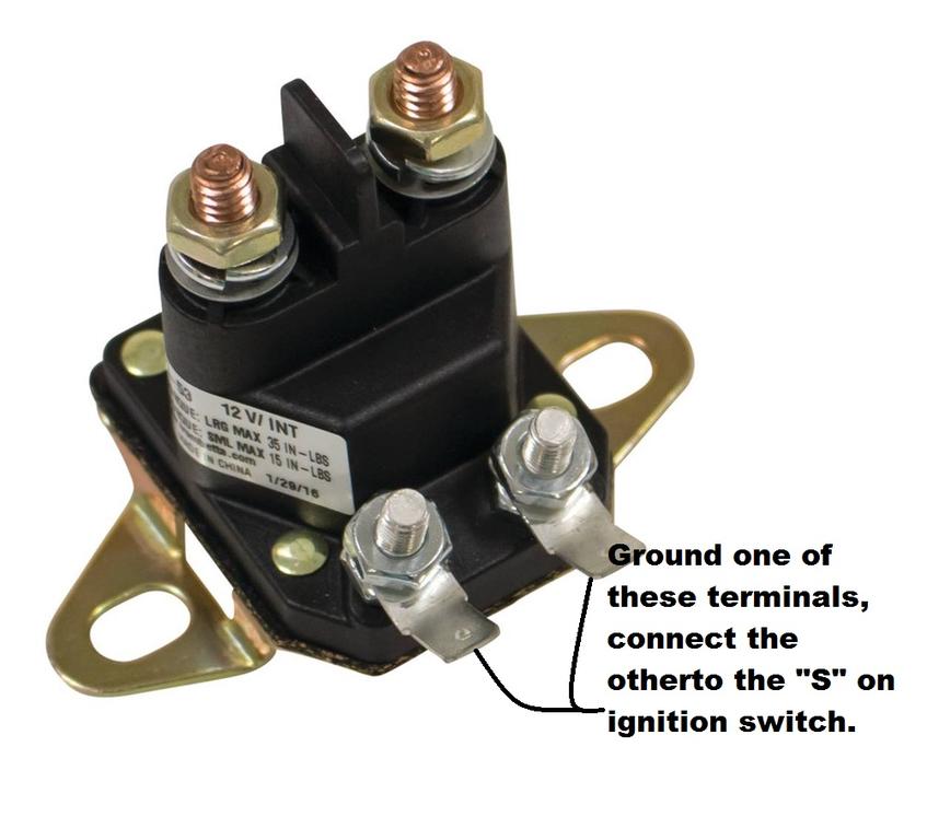

Red Bull Stripe 5 #12 Posted August 7, 2018 Thanks FJD - one of my local shops has one for $13 and I'll get it this afternoon - This is what is shown in the manual, but mine has the tangs, although the posts are vertical, not horizontal. Share this post Link to post Share on other sites
Red Bull Stripe 5 #13 Posted August 7, 2018 Replaced the solonoid and it’s getting power but still no power to the starter. Ordered new ignition, should be here in a few days. I don’t see any obvious breaks or corrosion at all the wire fittings! Share this post Link to post Share on other sites
pfrederi 20,997 #14 Posted August 8, 2018 there are two small terminals. Only one will make it work. the other is either a ground or a bypass for ignition. If you put 12 volts on the small terminal does it click??? if not try the other one. Share this post Link to post Share on other sites
Red Bull Stripe 5 #15 Posted August 8, 2018 Sorry, which terminals are you referring to? Share this post Link to post Share on other sites
Red Bull Stripe 5 #17 Posted August 8, 2018 No click - will swap them tomorrow and try again. Share this post Link to post Share on other sites
Red Bull Stripe 5 #18 Posted August 8, 2018 no click either way! the work continues tonight...btw battery reads 12.45 volts...I know that's not max, but do you guys think that's too low? Share this post Link to post Share on other sites
pfrederi 20,997 #19 Posted August 8, 2018 Have you mounted the solenoid? Make sure the mounting bracket is well grounded as well as one of the spade terminals. 12.45 is more than adequate 1 Share this post Link to post Share on other sites
Red Bull Stripe 5 #20 Posted August 8, 2018 solenoid is mounted securely and everything was good and clean. Share this post Link to post Share on other sites
FatJackDurham 318 #21 Posted August 8, 2018 THe battery is good enough at that charge. So now, it's time work the other parts. Now, when you say "ignition" you mean the key switch? Well, once that is done, it only leaves the fuse, the safety switches and the relays. Pullstart is right, though. DO you have a testing meter? You can get an autosensing voltimeter from radio shack or sometimes an auto parts store cheaply. Or you could just get some alligator clips and use a small light like the headlight with some wires. Goodluck. Share this post Link to post Share on other sites
Red Bull Stripe 5 #22 Posted August 8, 2018 I picked up a multimeter yesterday, just need to find a way to test the safety switches and relays. The fuses are both good. And yes, by ignition I mean the key switch. I ordered a new one - even if the old one isn't the problem, it's next to impossible to get the key in and out, and turn so now is a good time to replace it. My neighbor's dad knows these machines well and we discussed it a bit last night, eliminating starter, battery, solenoid and fuses as we have here. He's going to help to test the safety switches and see if we can get her running again. Share this post Link to post Share on other sites
