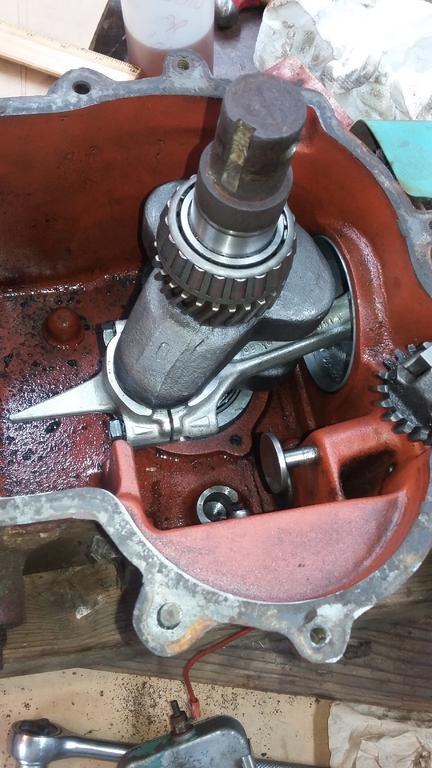

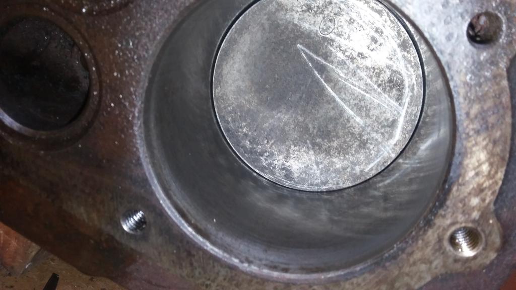

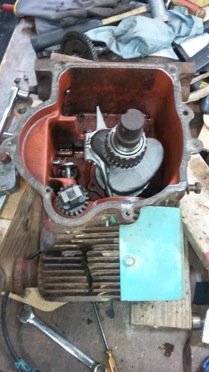

BOB ELLISON 2,983 #1 Posted August 5, 2018 I started working in my 1966 L157 Lawnranger trying to see what I can salvage on it. It has a S7d Wisconsin engine that would not turn either way but maybe 3 inch's and stick solid. I turn it the other way and same thing so I thought maybe a broken rod. I pulled it apart and it has a stuck piston and stuck intake valve. I removed the valve and crank then worked the piston out. The top ring which is the compression ring was stuck solid. I tried to free it and it broke (a dumb thing on my part). I should have soaked it first but I didnt. I have 2 questions. (1) I'm going to take the piston to a repair shop close by and see it I can get a ring put on it. Can this work ? I'll hone the cylinder first a little to kill the glaze. I don't want to put much money into this engine. I know it needs a carb also but there not that expensive. (2) I need a repair manual to see how the cam and crank timing is set. It's a clean engine the bearings are good Cam and crank not warn. Nothing that bad. I think it would be a good engine if I can get it back together. 3 Share this post Link to post Share on other sites
