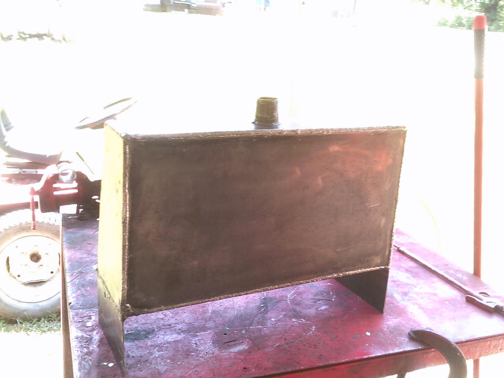

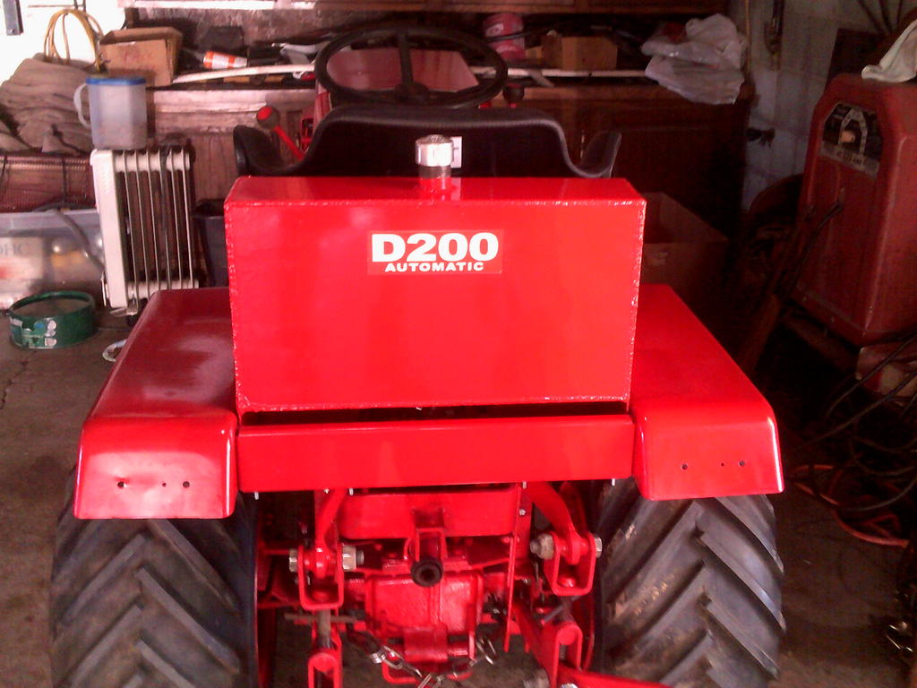

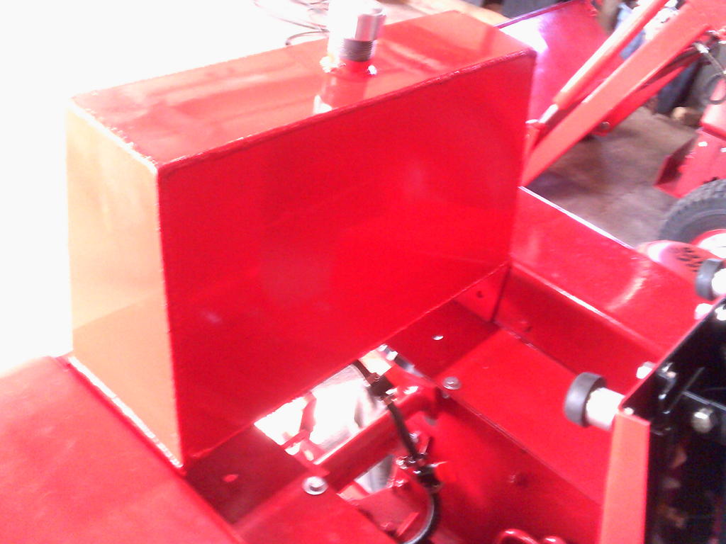

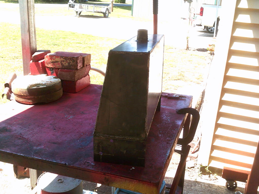

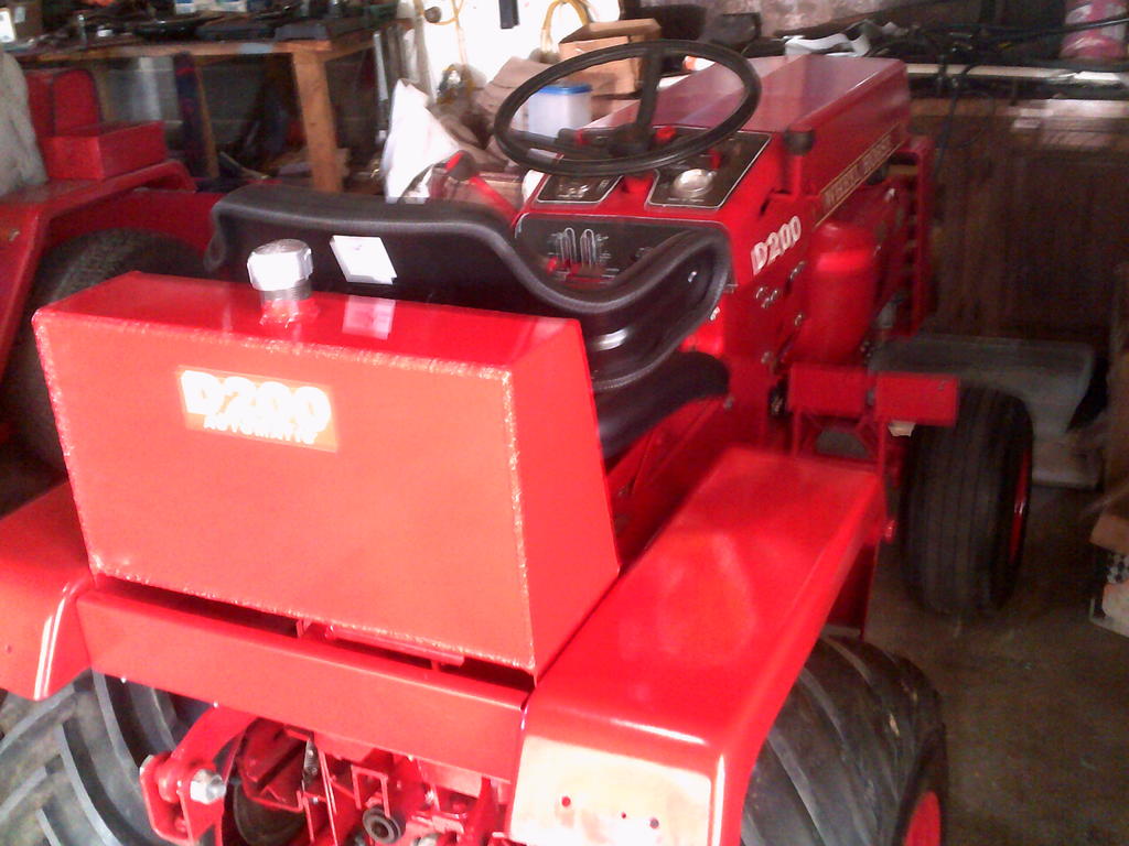

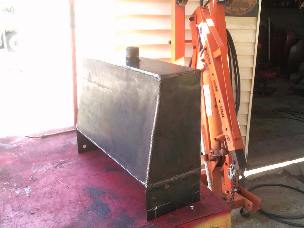

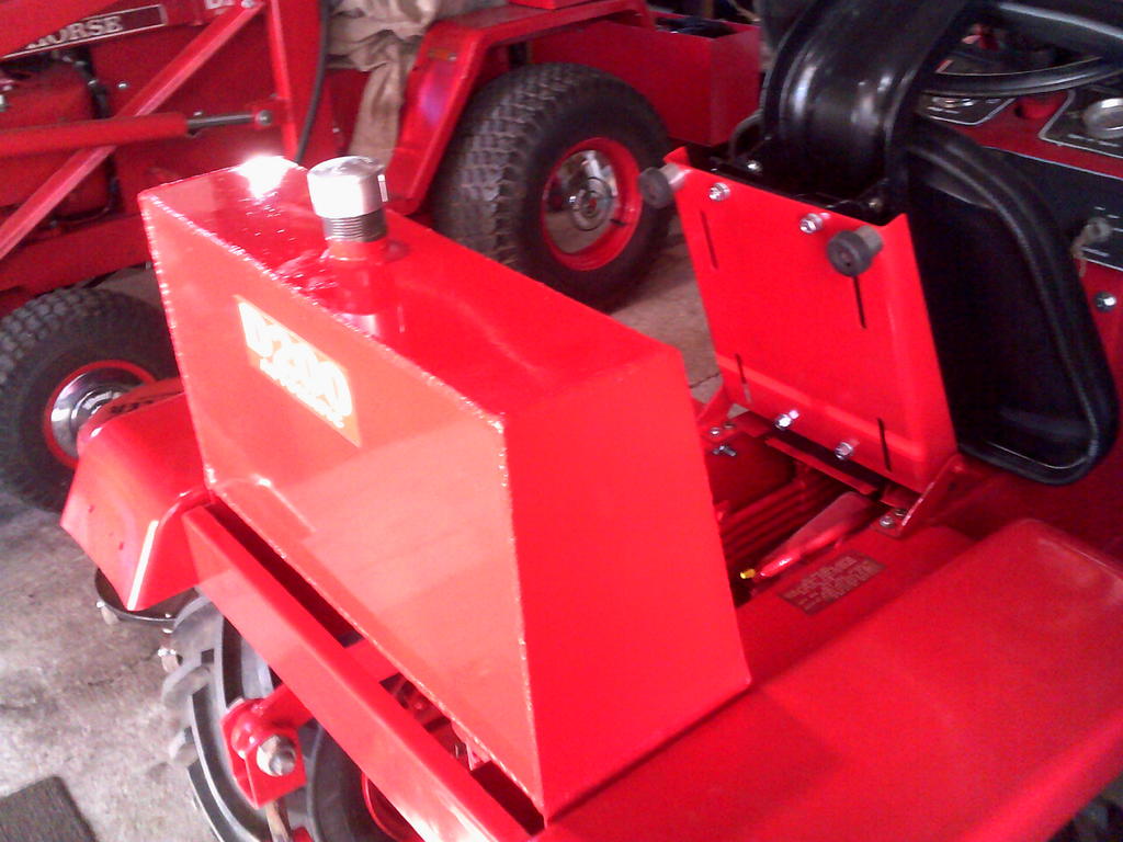

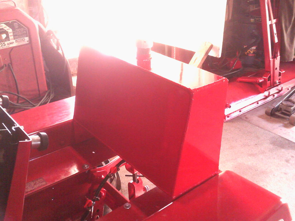

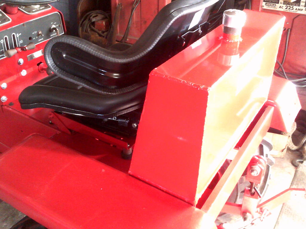

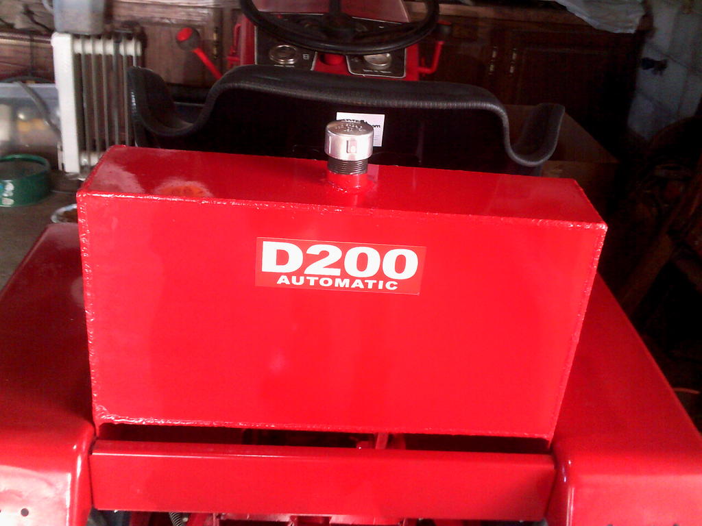

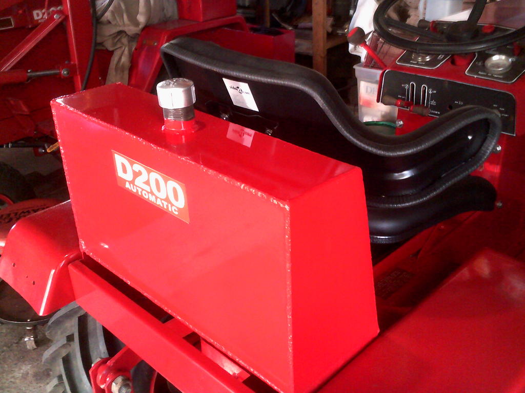

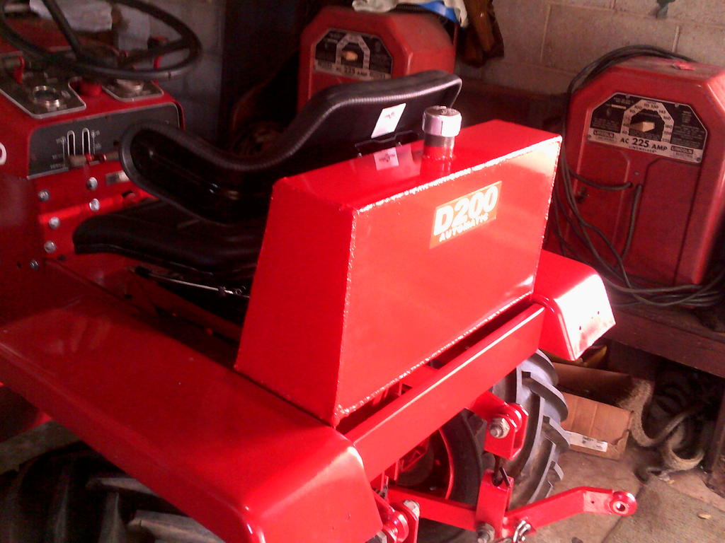

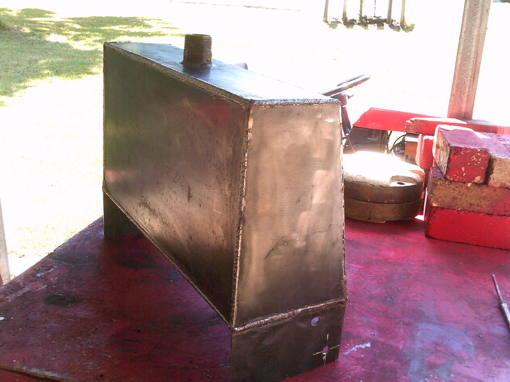

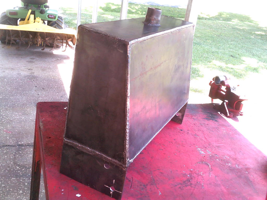

elliot ness 1,916 #1 Posted August 2, 2018 Made a fuel tank for on of my D200, 1/8 in. plate. And no leaks. 3hours and some plate that was laying around. It hold about 8 gallons of fuel. It bolts to the sides of the fenders and don't sit on the bottom of the tank. 4 9 1 Share this post Link to post Share on other sites
cleat 8,902 #2 Posted August 2, 2018 Looks really good. The seat looks just like the one on my big tractor. Does it have suspension as well ? Did you do a pressure test on the tank ? 2 Share this post Link to post Share on other sites
pfrederi 20,227 #3 Posted August 2, 2018 Does your seat hit the tank...The comfort ride ones always seem to 1 Share this post Link to post Share on other sites
RandyLittrell 3,944 #4 Posted August 2, 2018 Looks good @elliot ness, is that just a close nipple and galvanized cap? Also, did you put a vent in? I am likely going to go the same route for my GT14. Randy 1 Share this post Link to post Share on other sites
elliot ness 1,916 #5 Posted August 2, 2018 1 hour ago, RandyLittrell said: Looks good @elliot ness, is that just a close nipple and galvanized cap? Also, did you put a vent in? I am likely going to go the same route for my GT14. Randy Yes on the nipple, and yes on a vent and no it is not galvanized, I painted a plastic one silver. 1 Share this post Link to post Share on other sites
elliot ness 1,916 #6 Posted August 2, 2018 5 hours ago, pfrederi said: Does your seat hit the tank...The comfort ride ones always seem to No the seat moves back and forth that is why I slanted one side of the tank. 1 Share this post Link to post Share on other sites
elliot ness 1,916 #7 Posted August 2, 2018 6 hours ago, cleat said: Looks really good. The seat looks just like the one on my big tractor. Does it have suspension as well ? Did you do a pressure test on the tank ? No on the suspension and no on the pressure test, I left it full of fuel over night and no leaks, good enough for me. 1 Share this post Link to post Share on other sites

Pullstart 69,608 #9 Posted August 3, 2018 What kind of welder did you use? Looks nice! 1 Share this post Link to post Share on other sites

elliot ness 1,916 #11 Posted August 3, 2018 8 hours ago, pullstart said: What kind of welder did you use? Looks nice! I used a AC buzz box, with 6011 stick rod. 1 Share this post Link to post Share on other sites

RandyLittrell 3,944 #14 Posted August 5, 2018 If you wouldn't mind, let us know after you have used it awhile, if it works like you wanted or if you would make changes. I think that is just what I want to do for a fuel tank on my GT14. Thanks, Randy 1 Share this post Link to post Share on other sites
