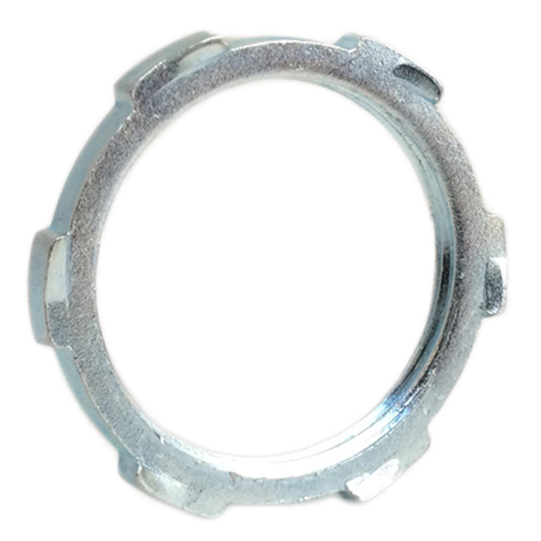

KC9KAS 4,746 #2 Posted July 23, 2018 I have seen many a muffler pipes being held tight with a conduit nut. 2 2 1 Share this post Link to post Share on other sites
wallfish 20,231 #3 Posted July 23, 2018 Too tight and it can certainly crack that aluminum block. Get your self a "nut" and cinch the pipe. Also couldn't hurt to support it as well 1 2 1 Share this post Link to post Share on other sites
ebinmaine 79,740 #4 Posted July 23, 2018 Just now, KC9KAS said: I have seen many a muffler pipes being held tight with a conduit nut. I thought that would work too so I did put one on. Thing is, the direction of loosening is also the direction that is in favor of gravity. So when the motor got hot, the muffler just started to fall. 1 Share this post Link to post Share on other sites
KC9KAS 4,746 #5 Posted July 23, 2018 2 minutes ago, ebinmaine said: I thought that would work too so I did put one on. Thing is, the direction of loosening is also the direction that is in favor of gravity. So when the motor got hot, the muffler just started to fall. Then a bracket is probably your best bet! We have to be fabricators sometimes to keep these horses alive and kicking! 5 Share this post Link to post Share on other sites

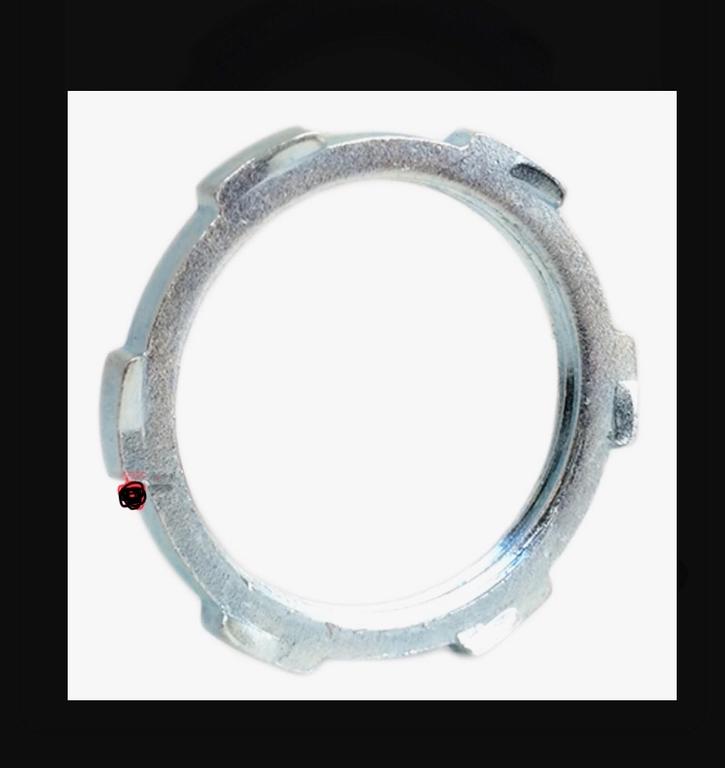

Machineguy 877 #8 Posted July 23, 2018 If you have room on the block at the exhaust port. You may be able to drill and tap a small grub screw hole to jam lock the conduit nut after it’s tightened. An 8-32 set screw with high temp copper anti-seize on it would allow it to be removed later. That would stop the rotation after it’s hot. For sure though, a tapered pipe thread on a steel pipe can definitely strip and or fracture aluminum blocks. 2 1 Share this post Link to post Share on other sites

Machineguy 877 #11 Posted July 24, 2018 (edited) @953 nut Basically I was talking about putting a small screw tight against the conduit nut after it’s tightened flush to the block. Basically the little dot I crudely added to the pic is where a small set/grub screw could go in jamming the nut. Provided there’s enough room on the block. I hope that helps clear up my jibberish! Lol Edited July 24, 2018 by Machineguy 1 Share this post Link to post Share on other sites
