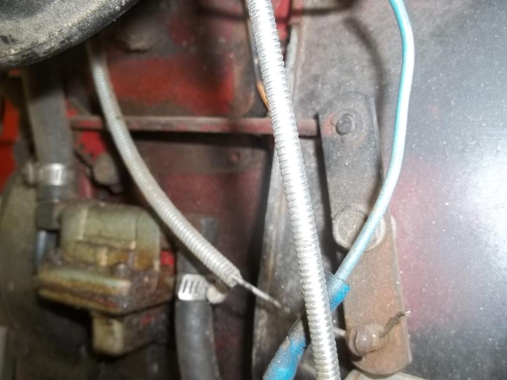

roadapples 6,987 #11 Posted July 23, 2018 Should of had the in the contract.... Fuel pump is directly under Carb..... Share this post Link to post Share on other sites
Tractor boy 239 #12 Posted July 23, 2018 21 minutes ago, roadapples said: Should of had the in the contract.... Fuel pump is directly under Carb..... Hmm. For some reason I had it stuck in my mind that it would be roughly halfway in between the tank and carb. I’ll take a closer look. Share this post Link to post Share on other sites
953 nut 69,117 #13 Posted July 24, 2018 Lower left corner is the fuel pump, it lives on the front of the engine. 1 Share this post Link to post Share on other sites
