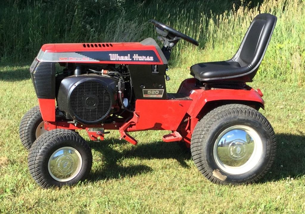

The Onan in my 520H was running poorly so last month I took the heads off, decarboned, cleaned/reseated the valves, checked valve seats and reassembled with new gasket set. When installing intake manifold, I realized last year (carb cleaning) I forgot to hook up vacuum line from manifold to gauge. Hooked it up correctly this time and ran great. First blizzard yesterday and started snow blowing. After about 15 minutes the became noticeably louder with less power.
I was wondering firstly if anyone has any idea what went wrong?
Also, I was thinking about repowering with a Honda or Vanguard and would love opinions on which way to go? Also, should I go with an engine or kit and which company? I’m good at fabrication, etc.
Thanks in advance!
Happy NewYear

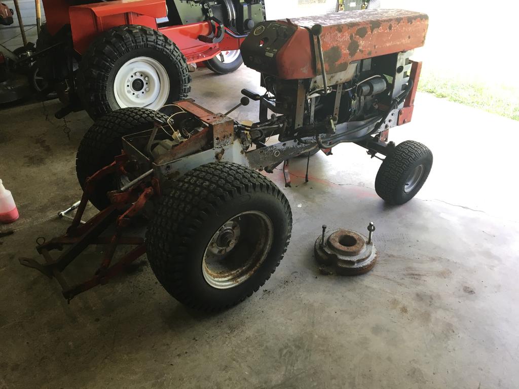

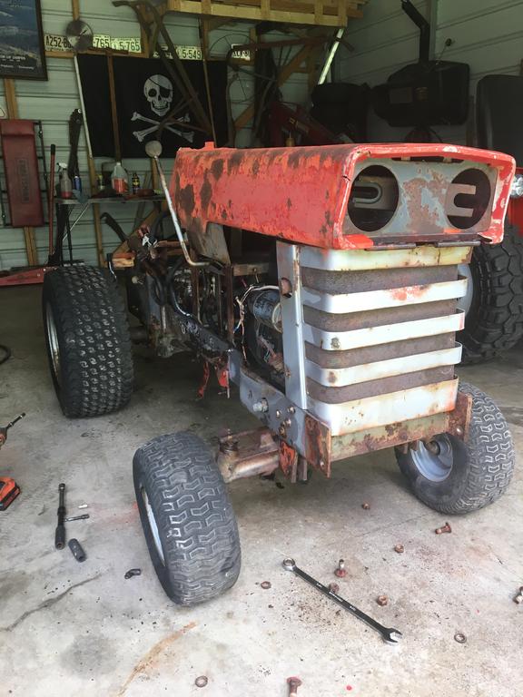

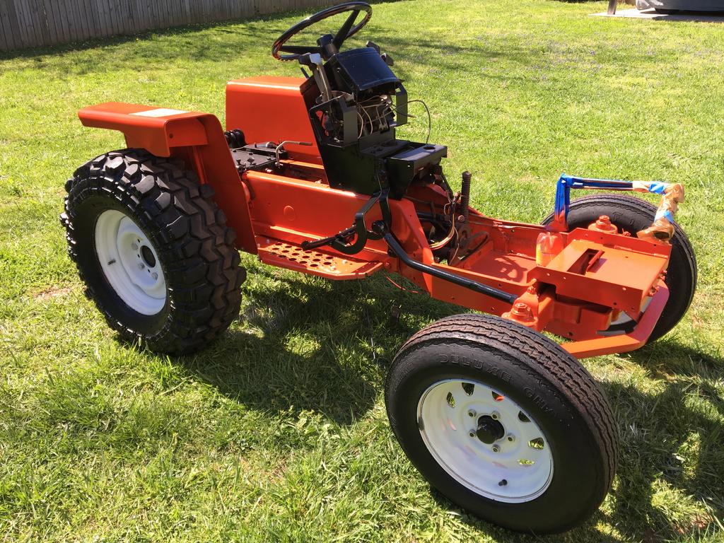

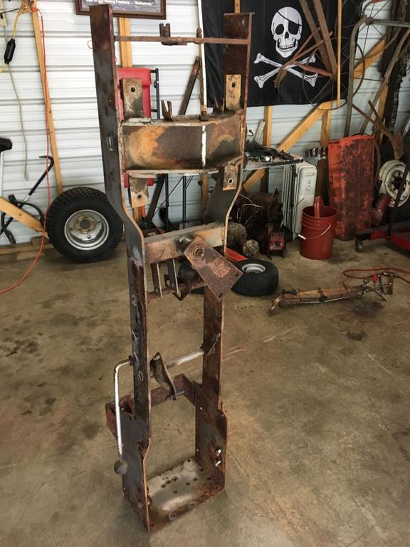

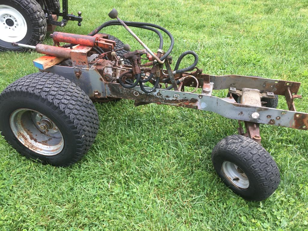

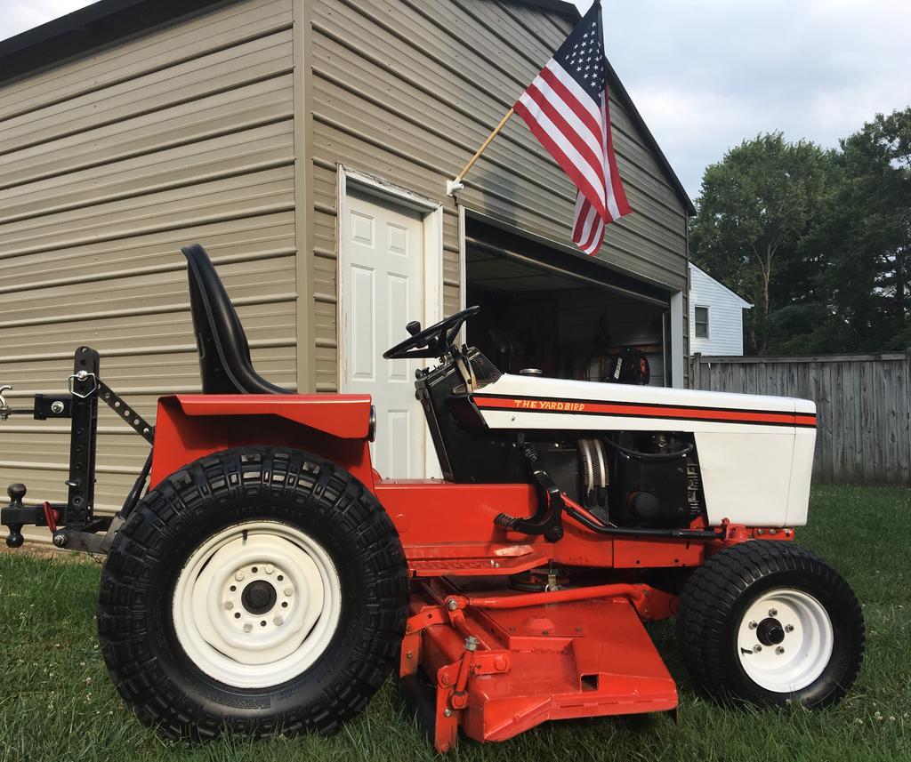

This is my first born custom and is still under construction. Only one of the hoods, gutted frame, seat tray and seat are from my recently acquired 551 Suburban. A newer 3 speed transaxle and belt guard will round out the remaining Wheel Horse parts. The front axle is flipped and moved forward 6 inches. Its origin along with the tie rods and steering column comes from a 102 Cub Cadet. Taking 2 steps back for every advance is part of the fun. But now I'm at a loss and overwhelmed at all the V drive pulleys available at Phoenix pulleys. Can anyone suggest what pulley I should use with the 13 hp Predator? Thanks in advance

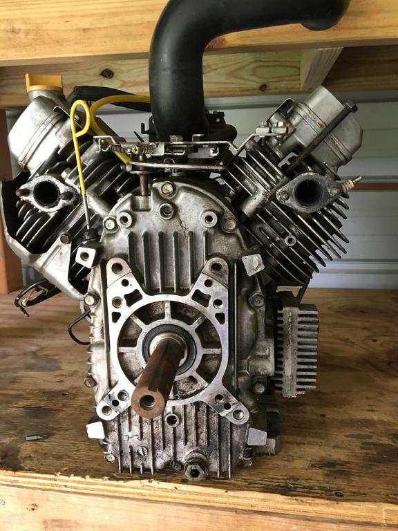

I am considering repowering my 522xi (for various reasons, but that's not the issue here) and I need the help of some experienced people. Sorry this post is a bit disjointed, I wanted to condense my thoughts without creating a bunch of new topics.
I believe that the Kohler CH730 is a near direct fit for the Kohler CH22S that is in the unit, does anyone know this for sure? Best I can tell it is.
My first issue is with the PTO shaft. The replacement engine I have a lead on has a (proper diameter) 4" long shaft with a 7/16-20 1.5" deep threaded hole on it, the one that came in the 522xi has a 3-5/32" shaft. I am hoping to run it as is, but it looks like it might come dangerously close to the battery, and I dont know if that 27/32" difference will cause the PTO belts to run all amok.
How does the PTO attach to the driveshaft, just bolted straight on?
If it is an issue, has anyone cut a crankshaft before? If so, how? Will there be enough threads left for the PTO bolt if I don't have the crankshaft re-drilled and tapped?
I called one machine shop that rebuilt my K341 and they said they couldnt do it, but I may check with others.
Thanks in advance everyone!
