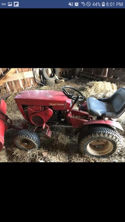

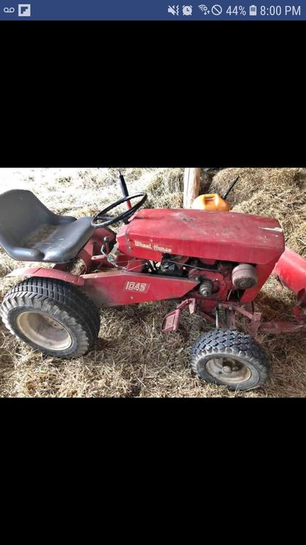

Sethd31 18 #1 Posted July 19, 2018 (edited) Just purchased my first wheel horse and the previous owner says it's a 1964 1045. I've done a lot of research and seems this forum has the most Info across the board. Can anyone help with the identity of this WH Edited July 19, 2018 by Sethd31 Upload photos 3 Share this post Link to post Share on other sites

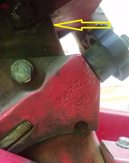

rmaynard 17,644 #2 Posted July 19, 2018 Look under the dash where the arrow is pointing for the model ID tag. Also, the 1045 should have individual round rear fenders. Post some more pictures if you could. and Welcome... Share this post Link to post Share on other sites
Sethd31 18 #3 Posted July 19, 2018 It does have individual round fenders. I looked all over under the dash and found no model ID tag 😟 perhaps it was removed or painted over.. Share this post Link to post Share on other sites
Sparky-(Admin) 26,688 #4 Posted July 19, 2018 The seller was close, it's a 1965. Other than the wrong seat it looks great! You even have the original front tires 1 Share this post Link to post Share on other sites
953 nut 70,343 #5 Posted July 19, 2018 Your 1045 even has the hard to find original front tires! It is sort of a crossover model that retained the rear fenders from previous years but incorporated the "new" square hood. Very nice find. 1 1 Share this post Link to post Share on other sites

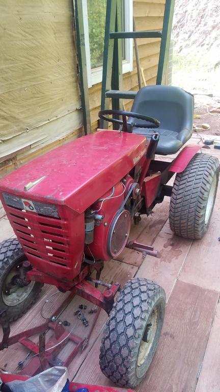

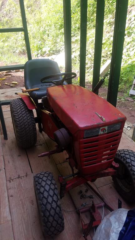

Sethd31 18 #9 Posted July 19, 2018 Also came with 40" snow blade and mower deck.. deck needs some bolts and blades.. all in all for $300 I'm super happy and she runs like a top! 2 1 Share this post Link to post Share on other sites

The Tuul Crib 7,354 #18 Posted July 20, 2018 If you need parts contact AtoZ tractors. These people are wonderful! Your first pic looks like the little ear is broke off the bracket that holds the implement arm in position. They should have one! good luck and welcome board!😀 1 1 Share this post Link to post Share on other sites

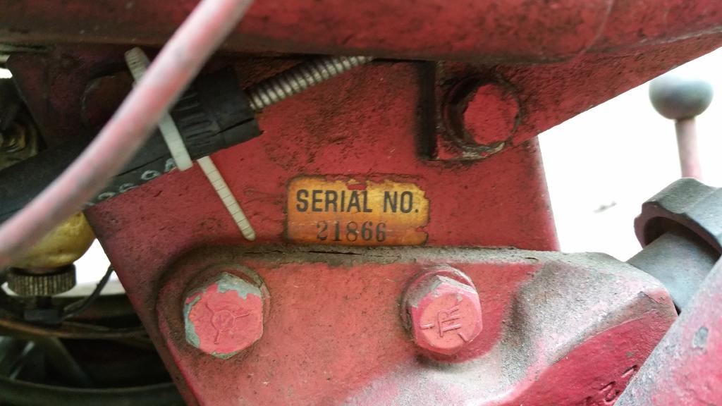

Mike'sHorseBarn 3,704 #21 Posted July 20, 2018 Great find!! I've had two 1045's over the years and passed both of them on to other horse lovers. The 1045 has not id plate on the dash tower, but instead it has a sticker above the lift assembly as pictured below. I see the outline of the sticker in your picture, but it is covered with dirt. Your 1045 is a great survivor and those front tires are very sought after! 1 1 Share this post Link to post Share on other sites
Sethd31 18 #22 Posted July 20, 2018 34 minutes ago, Mike'sHorseBarn said: Great find!! I've had two 1045's over the years and passed both of them on to other horse lovers. The 1045 has not id plate on the dash tower, but instead it has a sticker above the lift assembly as pictured below. I see the outline of the sticker in your picture, but it is covered with dirt. Your 1045 is a great survivor and those front tires are very sought after! Thanks! I saw that outline as well but was hesitant to go scraping at it since it was covered in paint to reveal the number.. BUT, I went ahead and cleaned it off and got my #! 22214 2 1 Share this post Link to post Share on other sites
gwest_ca-(File Mod) 12,535 #23 Posted July 20, 2018 Have kept the serial numbers in the 1964 file because I believe it was released as a late 1964 model. Added the 1965 file because it does show up in a 1965 parts manual. Click on the picture. If they had used their normal formula for a model number it would be a model 1054 but they already had a 1054 model at the time. They may have just reversed the last 2 digits and carried on. Garry 1 Share this post Link to post Share on other sites
