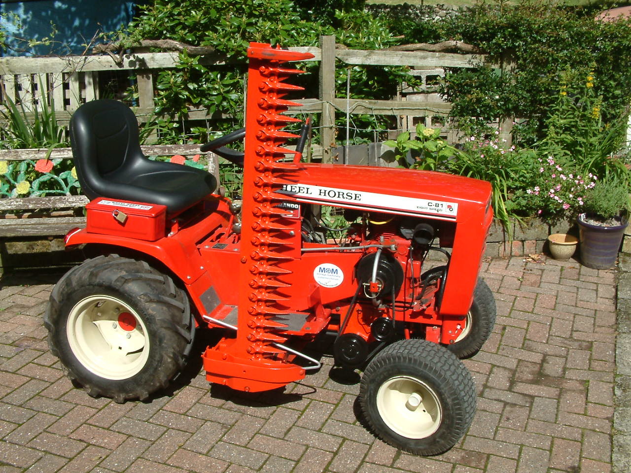

953 nut 68,531 #6 Posted July 20, 2018 Here is one from our Gallery that uses a tensioner that pivots forward. Looks good to me. 3 Share this post Link to post Share on other sites
martinarcher 59 #7 Posted July 20, 2018 Thanks for the pic! That one looks very well implemented. 1 Share this post Link to post Share on other sites
martinarcher 59 #8 Posted July 21, 2018 Is that your Horse 953nut? Share this post Link to post Share on other sites
953 nut 68,531 #9 Posted July 22, 2018 22 hours ago, martinarcher said: Is that your Horse 953nut? No! I found the photo in our gallery. It belongs to @Stormin. http://www.wheelhorseforum.com/gallery/category/3-mower-decks/ Share this post Link to post Share on other sites
Stormin 9,988 #10 Posted July 22, 2018 That's my '79 C-81 with a '62 sickle bar. There was no mule drive with it when I got it and would have been of no use if there had. Foot rests on the tractors it was designed for and foot plates on the C-81. Don't know how to add links, but if you go on our sister site, myoldmachine (top of page) you'll find my topic on the rebuild and fitting. Wheel Horse Sickle Bar. October 2015. Maybe give you some ideas. Norm. Share this post Link to post Share on other sites
953 nut 68,531 #11 Posted July 22, 2018 4 hours ago, Stormin said: Don't know how to add links, but if you go on our sister site, myoldmachine (top of page) you'll find my topic on the rebuild and fitting. Wheel Horse Sickle Bar. October 2015. Maybe give you some ideas. Here you go Norm, thanks for passing this on to us. http://myoldmachine.com/topic/2361-wheel-horse-sickle-bar/?tab=comments#comment-26123 1 Share this post Link to post Share on other sites
martinarcher 59 #12 Posted July 23, 2018 You guys rock! Thanks for the pics and the thread link. That will be a huge help getting my C-160 set-up. I really appreciate it. 1 Share this post Link to post Share on other sites
