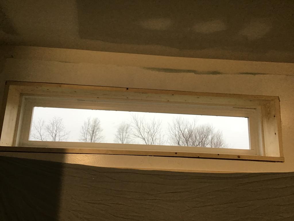

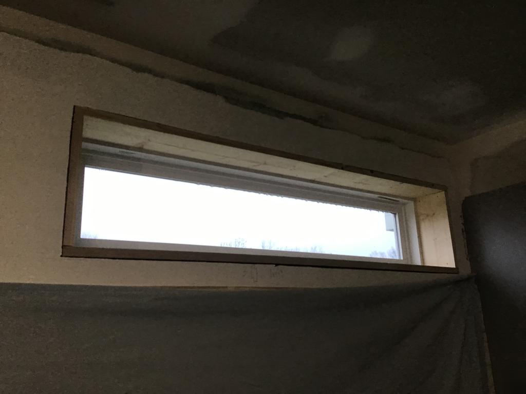

Pullstart 71,455 #151 Posted December 9, 2019 My window boxes are done. Now to cut the shiplap pieces to fit the windows and trim... 2 1 Share this post Link to post Share on other sites

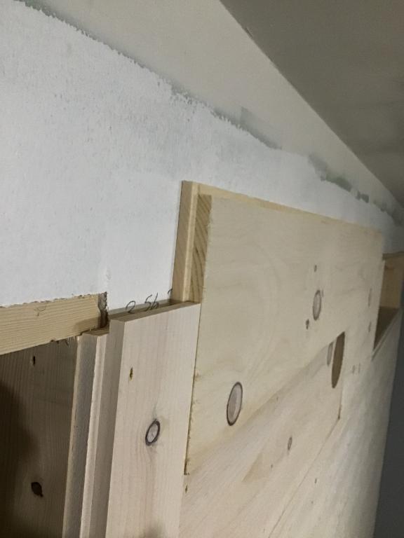

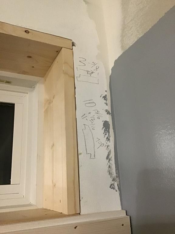

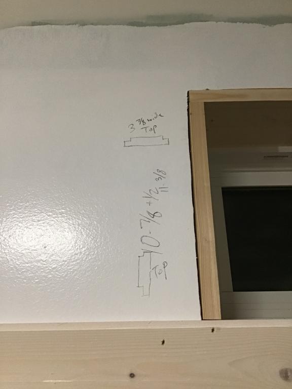

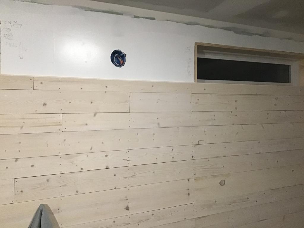

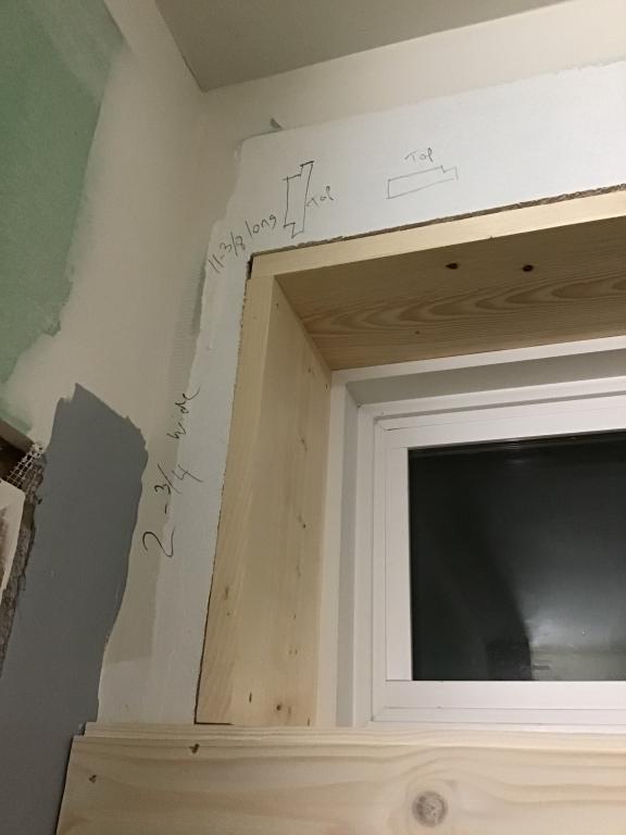

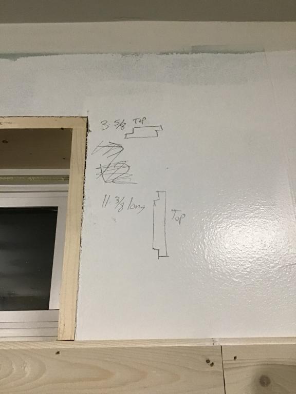

Pullstart 71,455 #152 Posted December 9, 2019 I’m waiting for final bits of drywall mud to dry and for the shower mortar bed to finish curing. I whipped up a different width piece of shiplap to come up to the bottom of the window boxes. To “trim” the sides, I’ll have to make 4 different shaped pieces for uprights. The area around the light will be cut to fit the picture frame and the next top piece will be cut differently too. This will essentially allow the shiplap undercut to be a molding for the window boxes. 2 1 Share this post Link to post Share on other sites

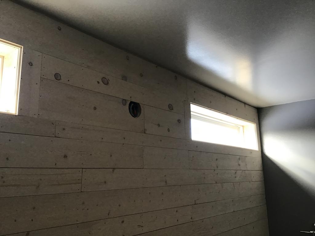

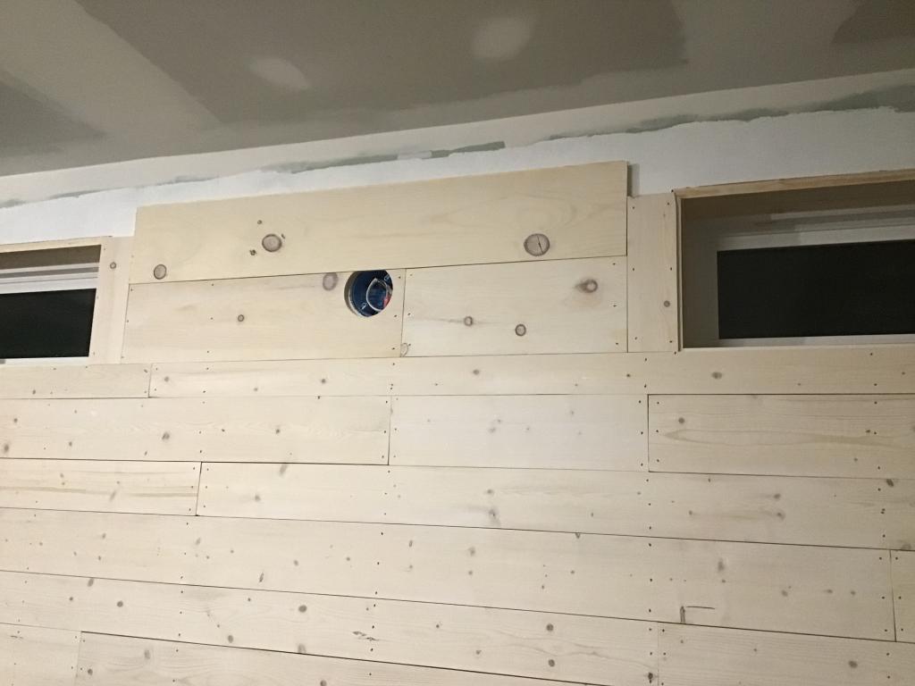

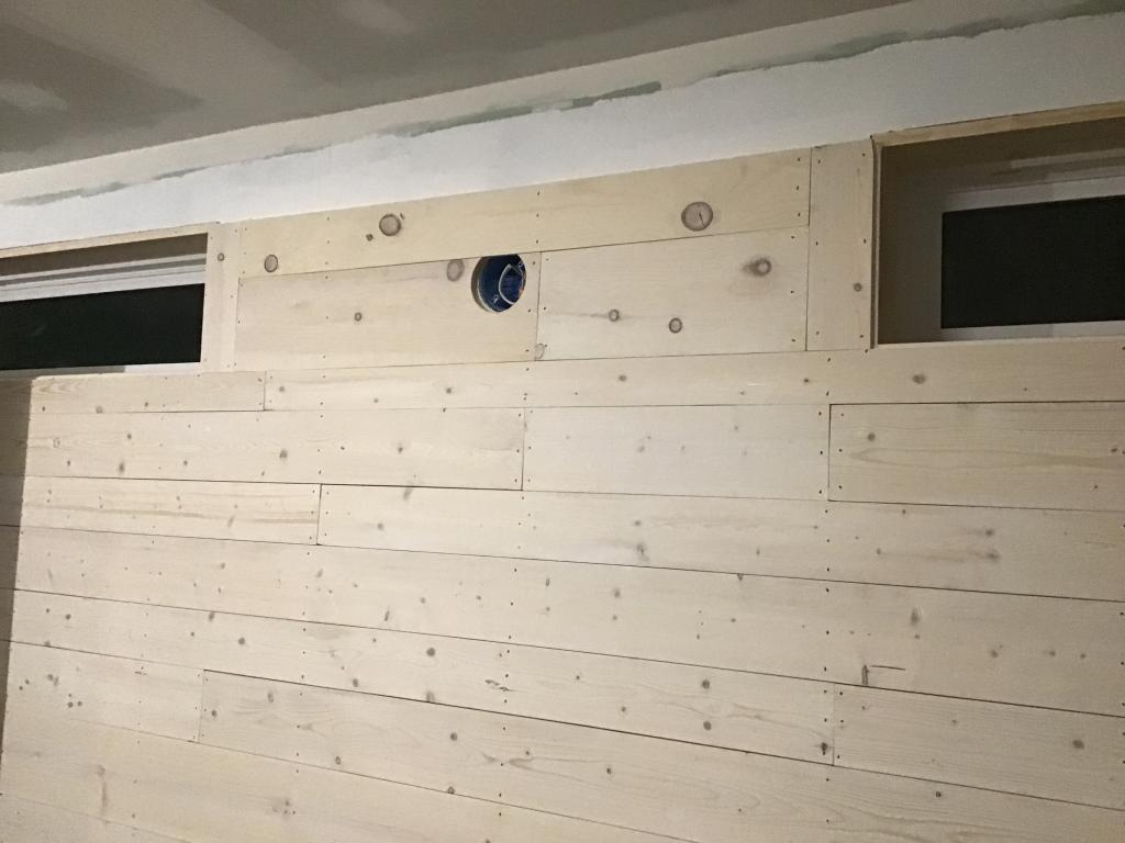

Pullstart 71,455 #153 Posted December 10, 2019 It’s working! I’ll trim the upper piece and that will pretty much be the end of the customized pieces.... I’ll just install the last few pieces upside down. 1 1 Share this post Link to post Share on other sites

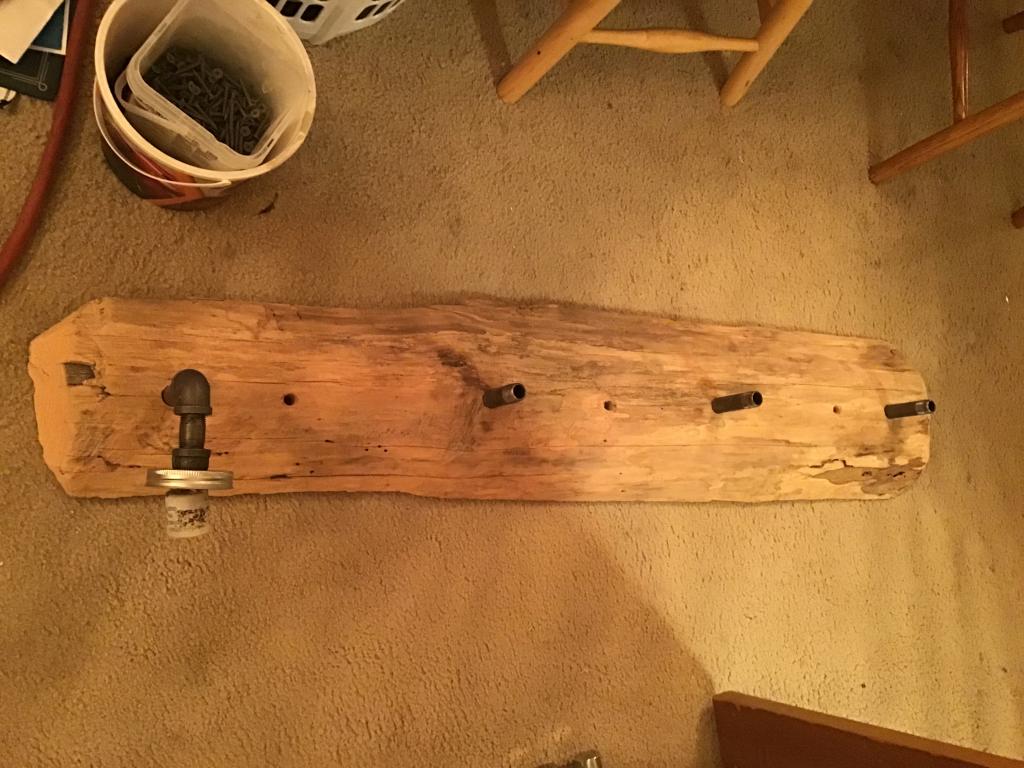

Pullstart 71,455 #154 Posted December 10, 2019 It’s cut down to height and will work out just swell. Here is the light “fixture” that’ll be over the vanity. It is from a dead ash tree that I felled about 10 years or so ago. I hand milled a few slabs with my chainsaw for a shelf and this was the first cut. I have the rest of the pieces to house the bulbs in mason jars. 1 1 1 Share this post Link to post Share on other sites

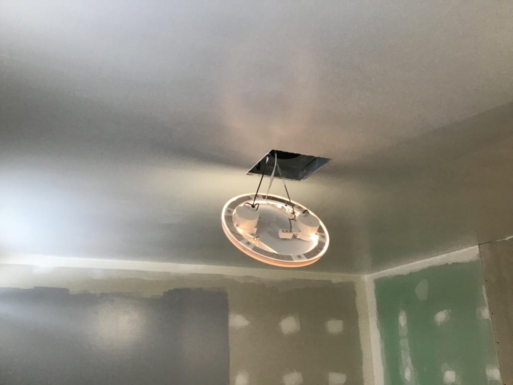

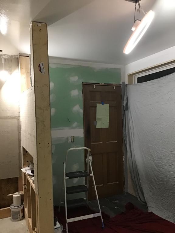

Pullstart 71,455 #157 Posted December 10, 2019 I am not 100% satisfied with the drywall mud. There are a few low spots. The blanket of snow outside really brightened up the room to make all the flaws really pop. I decided to paint, then skim a few spots as needed then touch up the paint. This’ll keep my progress moving forward. I’ll let this coat dry, then cut in the walls and paint them up too. Then grout, finish the wood wall, install vanity and continue on the shower! There is still some color coming out of the last shower mud job. 2 Share this post Link to post Share on other sites

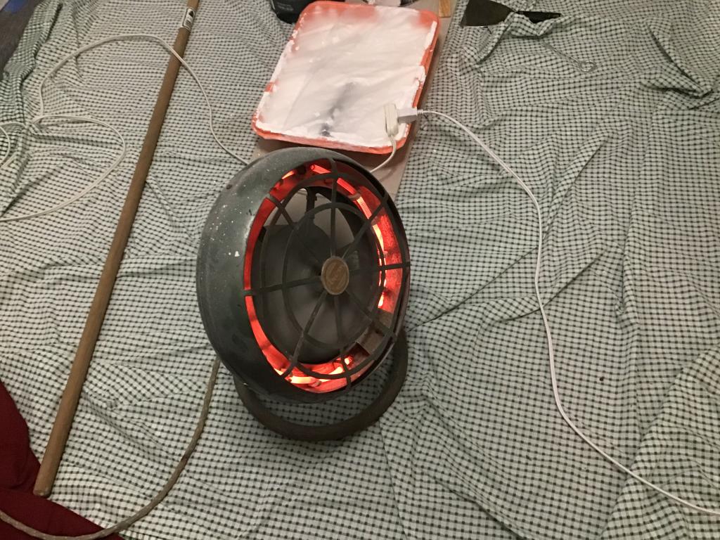

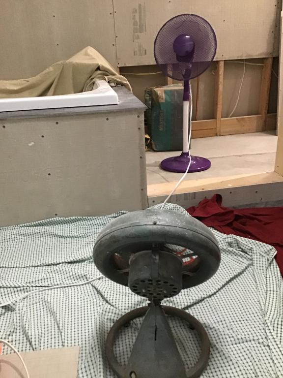

Pullstart 71,455 #158 Posted December 10, 2019 This old fan/heater is amazing for curing paint. I have it blowing into the oscillating fan for adequate air movement in the entire room. 1 1 1 Share this post Link to post Share on other sites

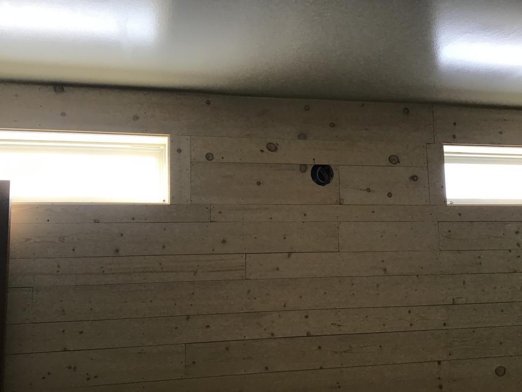

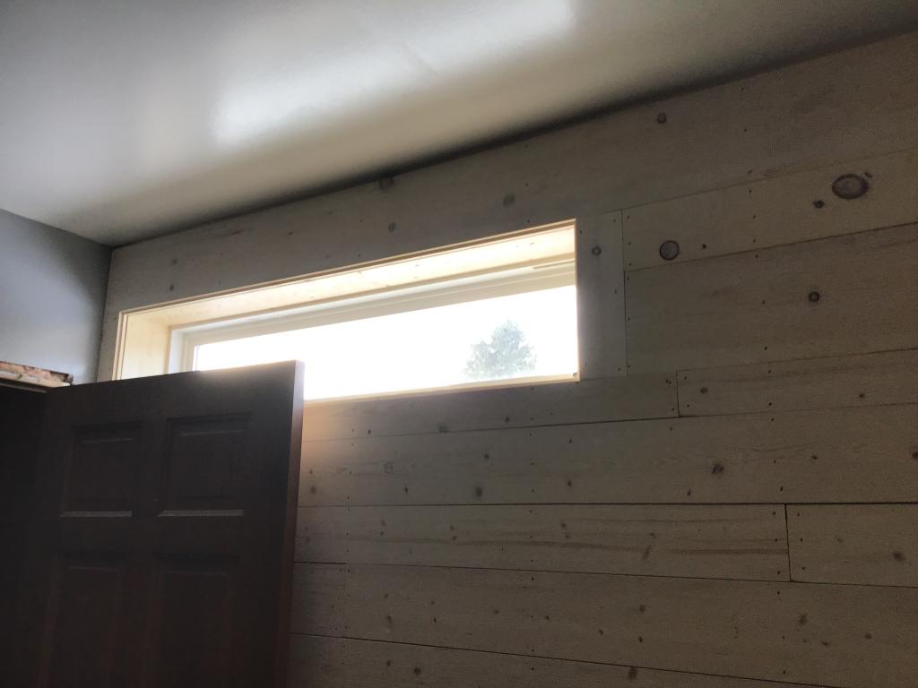

Pullstart 71,455 #159 Posted December 11, 2019 Trying not to make a complete career out of this project but so be it! I finished the paint and the wood wall is complete. I have a 1/2” or so gap at the top. I feel like it will get a similar trim treatment as the rest of the baseboard. My favorite 1-by common board! Now I’m scrubbing the tile in preparation for grout. Yay! 🥴 1 Share this post Link to post Share on other sites

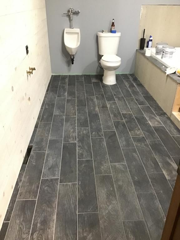

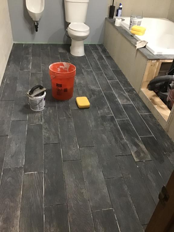

Pullstart 71,455 #161 Posted December 11, 2019 The grout is coming along! 3 Share this post Link to post Share on other sites
953 nut 69,921 #162 Posted December 12, 2019 4 hours ago, pullstart said: I have a 1/2” or so gap at the top. From the Now he tells me this file When I do a project like that wall I will mock up the layout from the top down so any gap will be concealed behind the base board. Share this post Link to post Share on other sites
Pullstart 71,455 #163 Posted December 12, 2019 7 minutes ago, 953 nut said: From the Now he tells me this file When I do a project like that wall I will mock up the layout from the top down so any gap will be concealed behind the base board. Well... I was kind of flying by the seat of my pants with that part. I figured that because of my shiplap design, I’d cut the last boards to fit. Then at the window when I flipped the top board, I sort of shot myself in the foot on that plan. It’ll work out just fine 1 Share this post Link to post Share on other sites

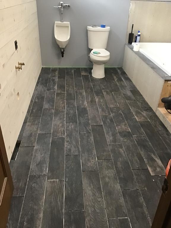

JCM 11,419 #164 Posted December 12, 2019 Kev, I can honestly say in almost 44 years in the Plumbing trade I have never installed a urinal in a residential application, I like your style, Bidet yes, urinal no.I commend you on your efforts to go it alone on the bath remodel. Back many years ago I did rough in a lot of urinals, and in a commercial application, all the 2'' waste piping had to be lead and oakum joints as per code with Cast Iron pipe, It was a lot of work but I kinda miss doing that, when Men were Men so to speak. Good luck with the completion of your new Master Bath. 1 2 Share this post Link to post Share on other sites

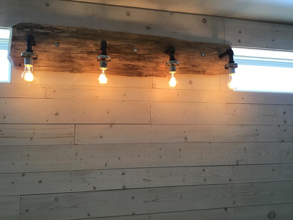

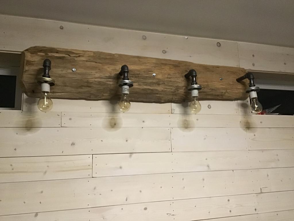

Pullstart 71,455 #165 Posted December 12, 2019 2 hours ago, JCM said: Kev, I can honestly say in almost 44 years in the Plumbing trade I have never installed a urinal in a residential application, I like your style, Bidet yes, urinal no.I commend you on your efforts to go it alone on the bath remodel. Back many years ago I did rough in a lot of urinals, and in a commercial application, all the 2'' waste piping had to be lead and oakum joints as per code with Cast Iron pipe, It was a lot of work but I kinda miss doing that, when Men were Men so to speak. Good luck with the completion of your new Master Bath. Thanks Jim! It’s pretty practical, even if I’m the only man in the house! Flooring is grouted and the light fixture is hung! For some reason, I have no lights though. I’ll grab my meter and check wiring in the AM. 3 1 1 Share this post Link to post Share on other sites
Pullstart 71,455 #166 Posted December 12, 2019 I’m chalking this up to a late night, maybe some fatigue and the fact that I don’t always like wire nuts. The hot wire had partially pulled from the bundle and needed a fresh snug. We have lights! 3 1 Share this post Link to post Share on other sites

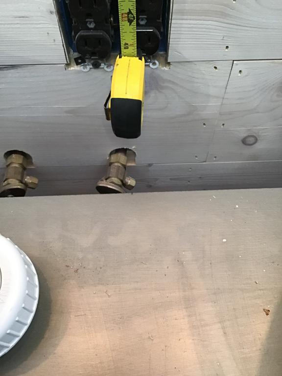

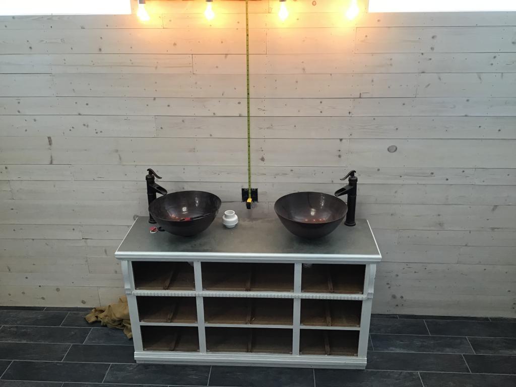

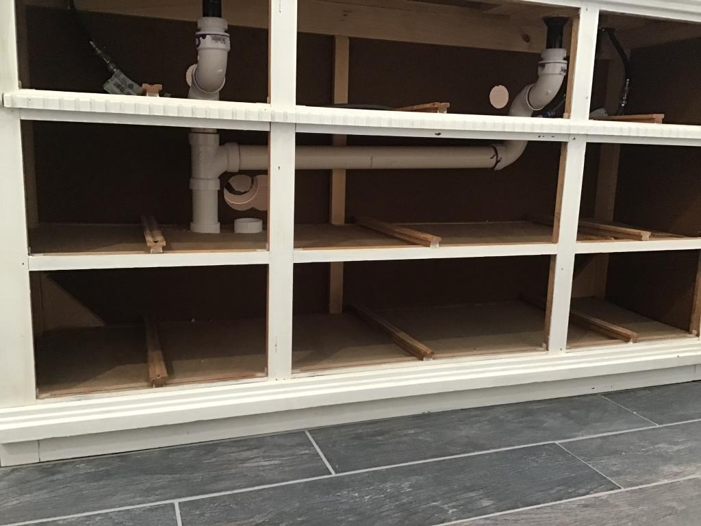

Pullstart 71,455 #169 Posted December 12, 2019 The vanity is close to being in place. Here shows the drains integrated into the dresser. The affected drawers are trimmed and shortened as needed. I hung my tape as a plumb bob to center it as close as I can to finish popping holes for water connections, etc. it’ll be anchored to the wall then the drain will be glued together. I have a pvc union if the vanity ever needs to be removed for any reason. I’LL ALSO POINT OUT... the outlets are wired to a GFCI breaker in the basement. Share this post Link to post Share on other sites

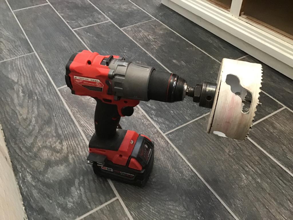

Pullstart 71,455 #170 Posted December 12, 2019 I’ll also go ahead and say I’ve had this new Milwaukee drill and super huge M-18 XC5.0 batteries for a few weeks or so now. I haven’t yet needed to charge a battery, they are lasting so much longer than their smaller M18 predecessors. Share this post Link to post Share on other sites
82Caddy 851 #171 Posted December 12, 2019 6 minutes ago, pullstart said: I’ll also go ahead and say I’ve had this new Milwaukee drill and super huge M-18 XC5.0 batteries for a few weeks or so now. I haven’t yet needed to charge a battery, they are lasting so much longer than their smaller M18 predecessors. I picked up a couple of those batteries as well. They're monsters. Share this post Link to post Share on other sites
Tractorhead 9,217 #172 Posted December 12, 2019 Very cool bathroom, i would also decide to have an Urinal. Even because it‘s more practicable for the „fast“ doing. Also the light is a pretty cool and genius idea. It looks a bit of Steampunk, i like it. Share this post Link to post Share on other sites
Pullstart 71,455 #173 Posted December 12, 2019 12 minutes ago, Tractorhead said: Very cool bathroom, i would also decide to have an Urinal. Even because it‘s more practicable for the „fast“ doing. Also the light is a pretty cool and genius idea. It looks a bit of Steampunk, i like it. Thanks Stefan, we we will finish the light fixture by cutting the bottoms off of Mason Jars and using them as lamp shades.. Share this post Link to post Share on other sites
Tractorhead 9,217 #174 Posted December 12, 2019 Cool, a friend of mine did this in the past with a 5DM coin, but not as lampshade. he put it in and swirl it few minutes, after 20 min he shake it 2 times and the bottom was released. a lightly sanding cuttes the sharp edges. but i never tried it. he also show me this practise with a empty beer bottle. the only restriction he had, was at Jack Daniels bottles, because they had no rounding in the bottle. 1 Share this post Link to post Share on other sites

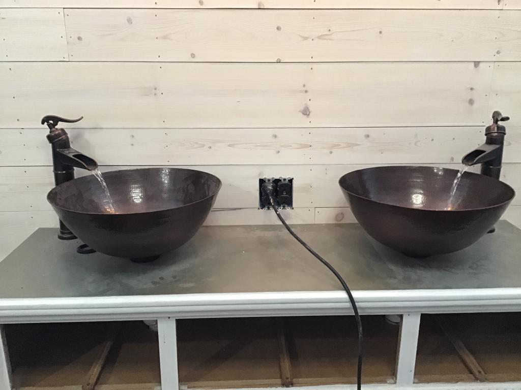

Pullstart 71,455 #175 Posted December 12, 2019 We’ve got a working sink in our bathroom! It’s been so long brushing teeth in the kitchen, my mouth tastes like dish soap! 1 1 Share this post Link to post Share on other sites
