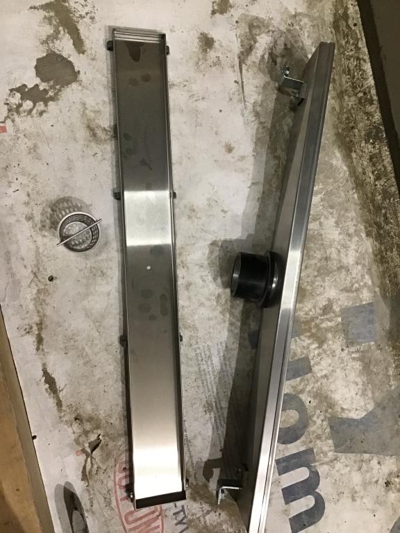

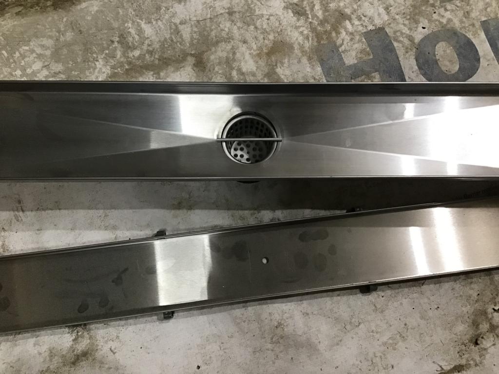

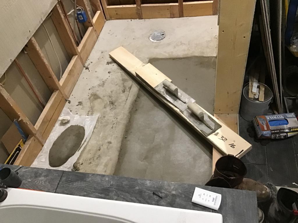

The Tuul Crib 7,354 #126 Posted December 4, 2019 5 minutes ago, pullstart said: It’s 2” PVC with a trap directly under the floor. That one long piece in that picture looks like a wall drain. I just saw one the other day on this old house and it was pretty cool how it went in and went together . Share this post Link to post Share on other sites
Pullstart 71,452 #127 Posted December 4, 2019 Oh... I’m not sure what kind it is. I’ll look into that, maybe it’ll help me do it right! Share this post Link to post Share on other sites
Pullstart 71,452 #128 Posted December 4, 2019 Retaining wall drain? That would make more sense than a drain in the wall! I was so confused... yeah, it’s similar to that in a way. This drains to the center and has a rubber seal and a basket to catch hair from clogging the drain. The center just lifts out and the 1/4” gap around the perimeter will catch the water. 3 1 Share this post Link to post Share on other sites
953 nut 69,917 #129 Posted December 5, 2019 Do you plan to use a waterproof isolation membrane under the tile? I found the Scluter System to be easy to use and worked well for my house. https://www.schluter.com/schluter-us/en_US/Membranes/Uncoupling-(DITRA)/c/M-U 1 Share this post Link to post Share on other sites
Pullstart 71,452 #130 Posted December 5, 2019 8 minutes ago, 953 nut said: Do you plan to use a waterproof isolation membrane under the tile? I found the Scluter System to be easy to use and worked well for my house. https://www.schluter.com/schluter-us/en_US/Membranes/Uncoupling-(DITRA)/c/M-U I have a big rubber shower pan membrane that’ll be laid down next, then another layer of mortar before tile. I believe they should essentially do the same job 2 Share this post Link to post Share on other sites
PeacemakerJack 11,080 #131 Posted December 5, 2019 Looking great Kevin! I’m excited for you and Taylor to see this project coming together. You have good pitch on the base “mud” and you made sure to float it out smoothly. The guy who installed mine didn’t do a good job on that portion of the install and it cost the finish stages of the project problems. 10 years later and I’m still not satisfied with the results on the floor. Water pools in some of the uneven portions of my floor and it always irritates me. Two👍🏻 For doing a good job on this part of the install...keep up the great work, I’m following along. Good to see Rylee in on the action too😉 2 Share this post Link to post Share on other sites
Tractorhead 9,217 #132 Posted December 5, 2019 (edited) The only thing i asked myself, why not bring some piping into motar bed, for a controlled underfloor heater?. Nothing is more comfortable, than jump in a preheated Shower with a underfloor heater. Simple to make (just a pipe (copper or Steel) bend to a maeander and hooked with a thermostat onto Heater circle.) So you be able to preheat the Shower and the room, once to dry quickly secondary for warm feet. Another great benefit was the comfort early in the morning, to stay on a warm floor until Shower.. I like that... Edited December 5, 2019 by Tractorhead 1 Share this post Link to post Share on other sites
Pullstart 71,452 #133 Posted December 5, 2019 1 hour ago, Tractorhead said: The only thing i asked myself, why not bring some piping into motar bed, for a controlled underfloor heater?. Nothing is more comfortable, than jump in a preheated Shower with a underfloor heater. Simple to make (just a pipe (copper or Steel) bend to a maeander and hooked with a thermostat onto Heater circle.) So you be able to preheat the Shower and the room, once to dry quickly secondary for warm feet. Another great benefit was the comfort early in the morning, to stay on a warm floor until Shower.. I like that... I haven’t mentioned heat source in the room, but you’re close! I plan to have a heat loop under the floor in the entire bathroom, controlled by a thermostat and some cool pumps through a heat exchanger. I have 130 gallons of stored hot water when the outdoor wood boiler is running, 80 gallons during the summer. There is an air duct heating and cooling the room currently, but I’ll stick a shut off in that for winter months. 2 1 Share this post Link to post Share on other sites

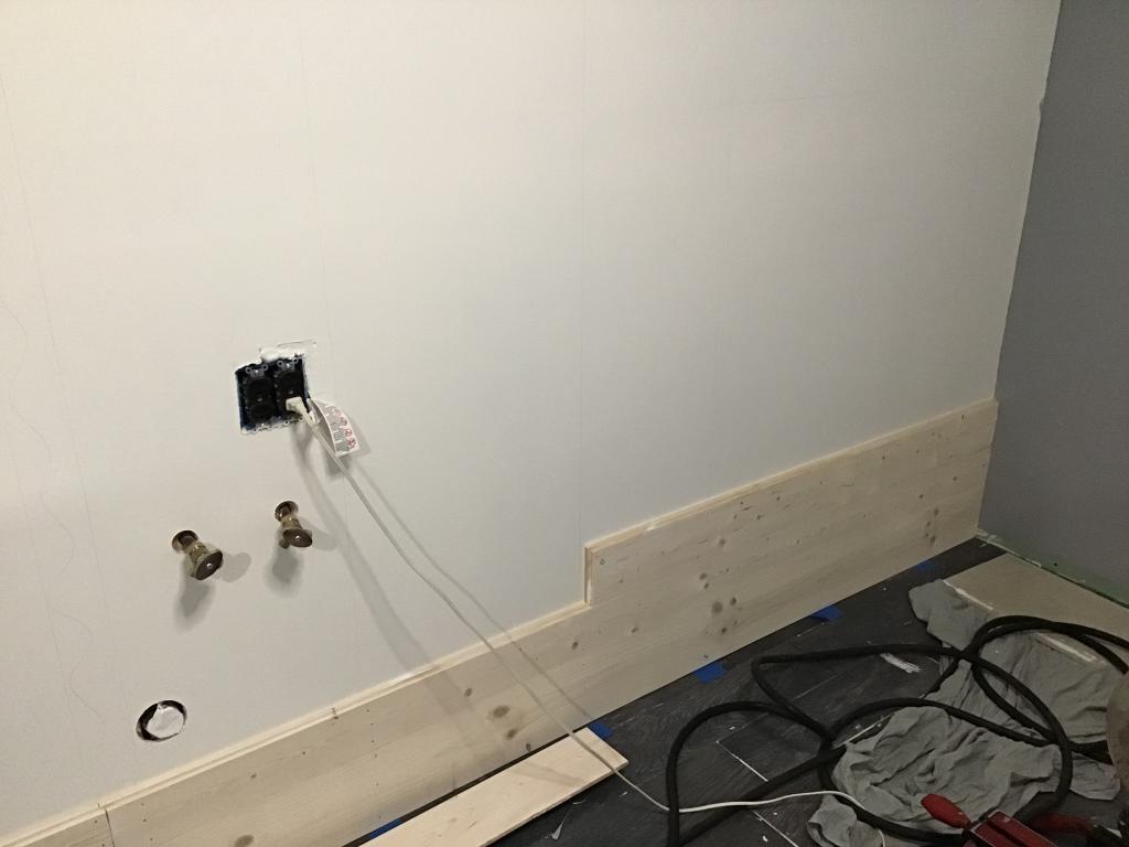

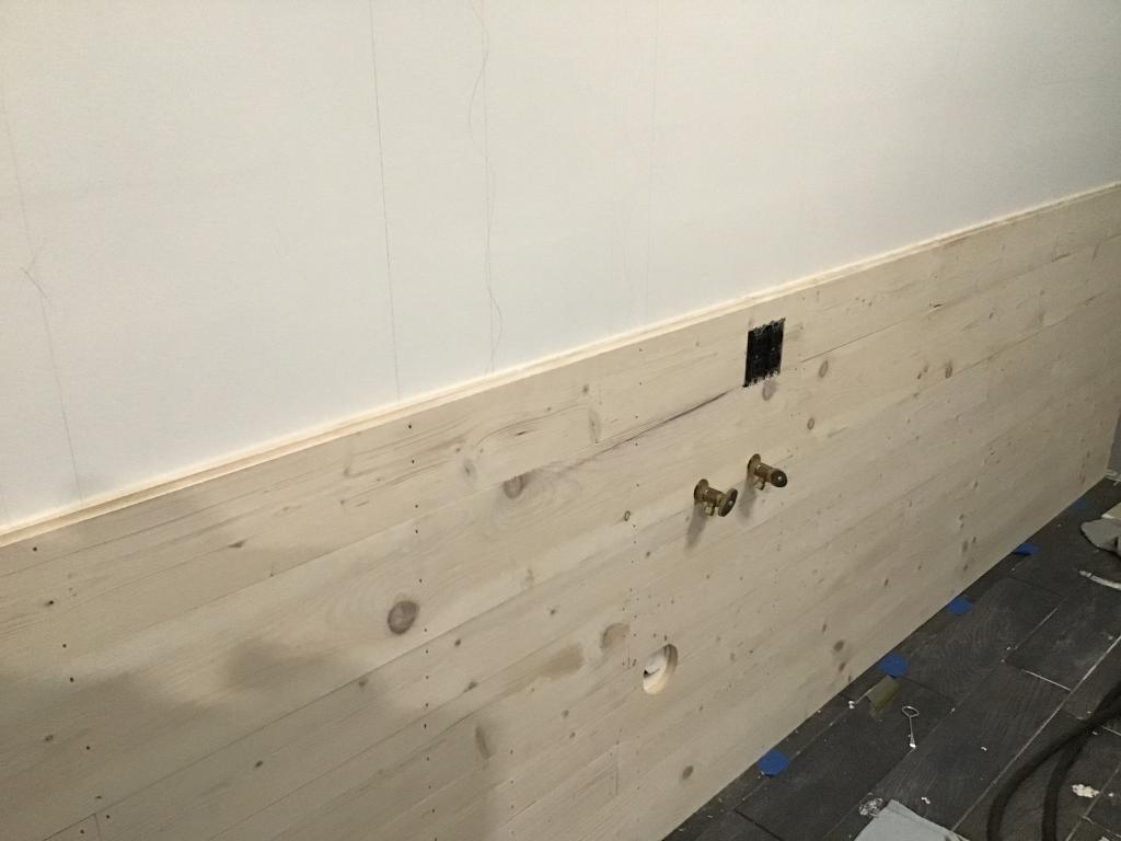

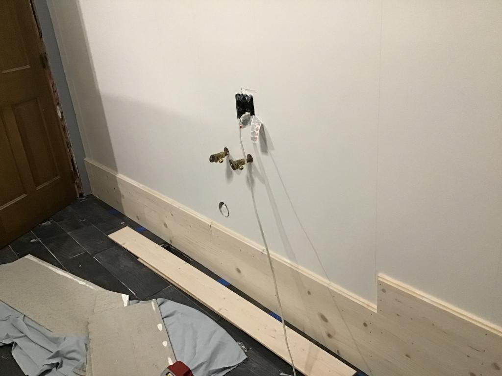

Pullstart 71,452 #134 Posted December 6, 2019 I threw up some paint to seal the wall and started putting up the boards. Shy of trimming and here and there, we’re in business! I had to take a trip to Harbor Freight last night to grab some 2” finish nails to get into the studs... and low and behold I wondered around a bit. DID YOU KNOW THEY HAVE A DISCOUNT TOOLS RACK!!!!??? The cashier said when they have a single item warranty that comes from a kit, the rest of the kit gets marked down 35-50% just for one missing tool! 1 1 Share this post Link to post Share on other sites

Pullstart 71,452 #139 Posted December 6, 2019 Trimm’er here, drill’er there... 1 1 Share this post Link to post Share on other sites

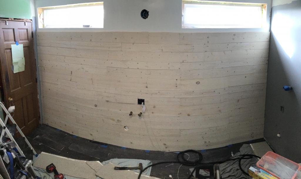

Pullstart 71,452 #140 Posted December 6, 2019 I’m making pretty good progress today, in between teaching about improper factions, mixed numbers and reducing fractions. See @WHX24 I’ve got a day job, just don’t pay for squat! I need to build my window boxes and plan the trim in order to continue. 1 1 Share this post Link to post Share on other sites

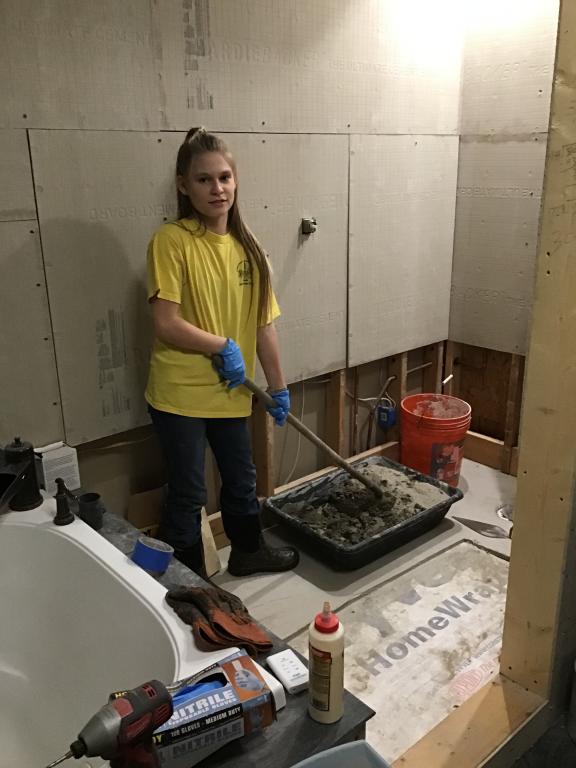

Pullstart 71,452 #142 Posted December 9, 2019 Saturday night Jada helped me mix up some more mud and we finished the mortar bed. We had enough left over mud to make a little stepping stone if it holds together. The chicken coop occasionally gets sloppy in the weather so she likes to hop from block to block to gather eggs. Today, I’ll sand some more drywall seams and see where additional mud is needed... then work on my window boxes. 2 1 Share this post Link to post Share on other sites
Pullstart 71,452 #143 Posted December 9, 2019 i Have a couple panoramic pictures to upload, but they seem to be too large to upload with today’s connection. Maybe later in a video... I’m hoping to be finishing up this week, with any luck! 1 1 Share this post Link to post Share on other sites
Pullstart 71,452 #144 Posted December 9, 2019 While the bathroom is halfway decent as far as organization goes... 2 1 Share this post Link to post Share on other sites
