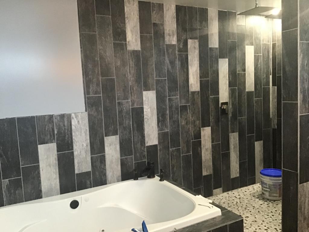

Pullstart 71,455 #285 Posted January 13, 2020 Silicone is finished! I have to build my sliding door soon, do trim work, hang a few tower holders, and get to the shop for a tractor build! 1 1 Share this post Link to post Share on other sites

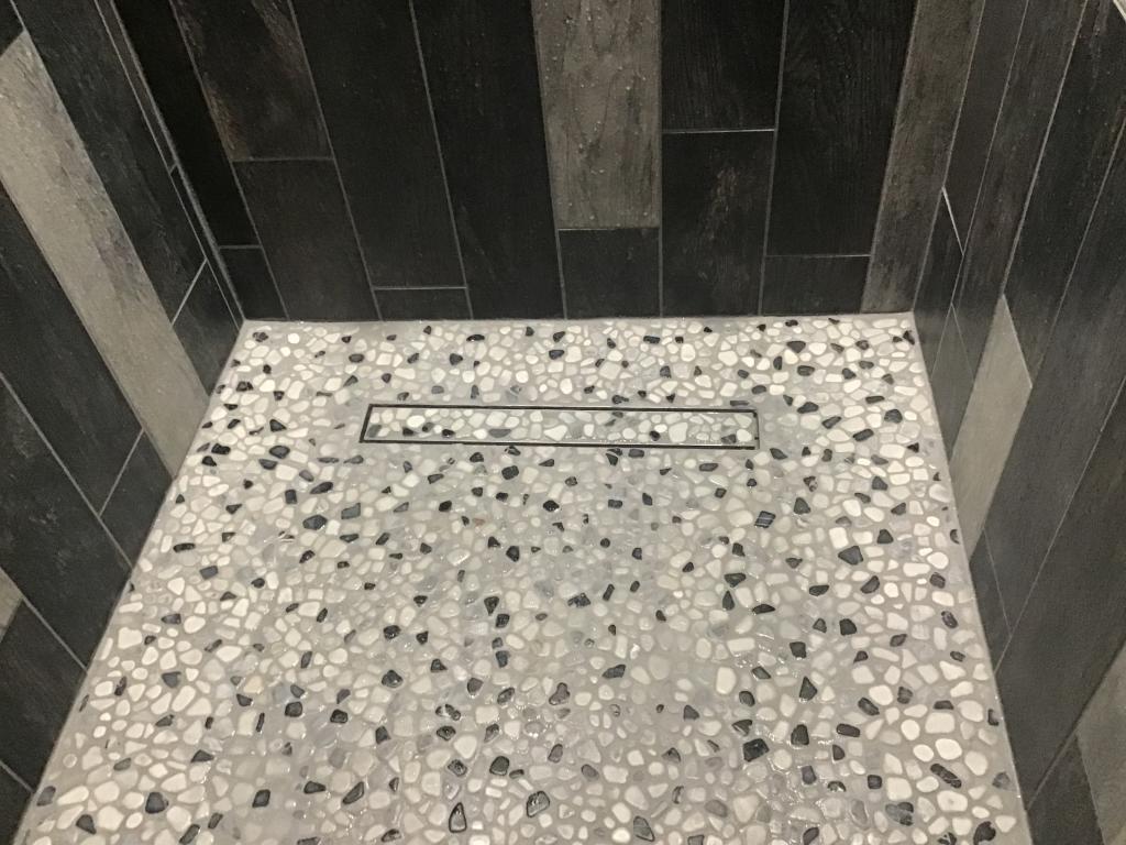

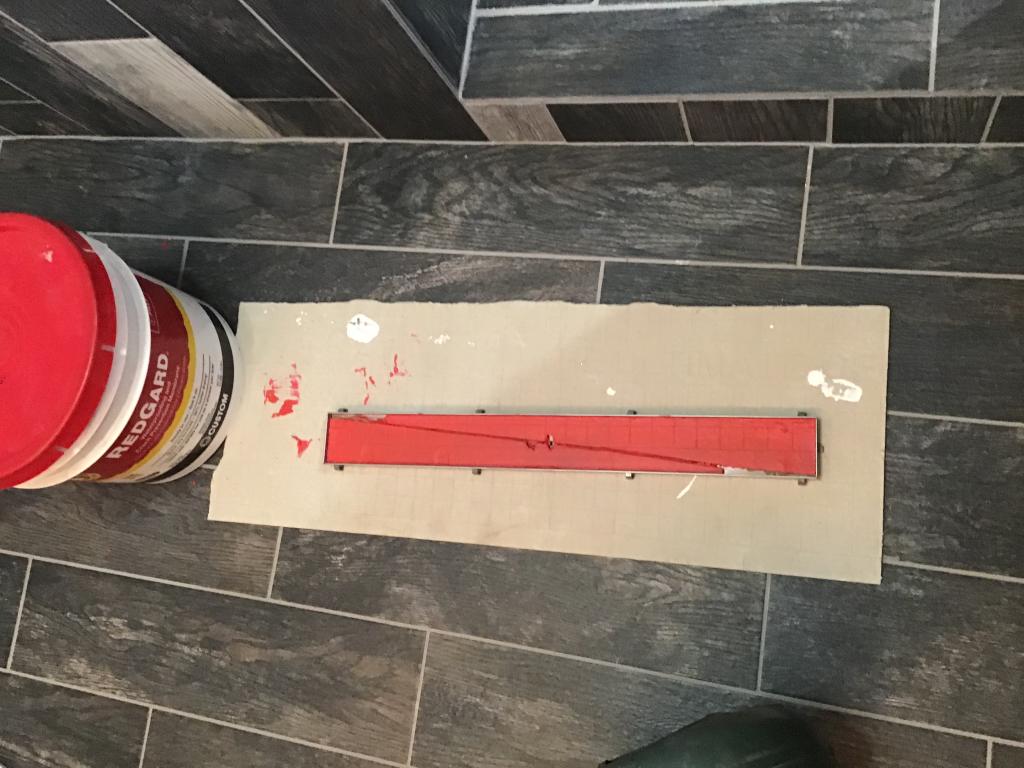

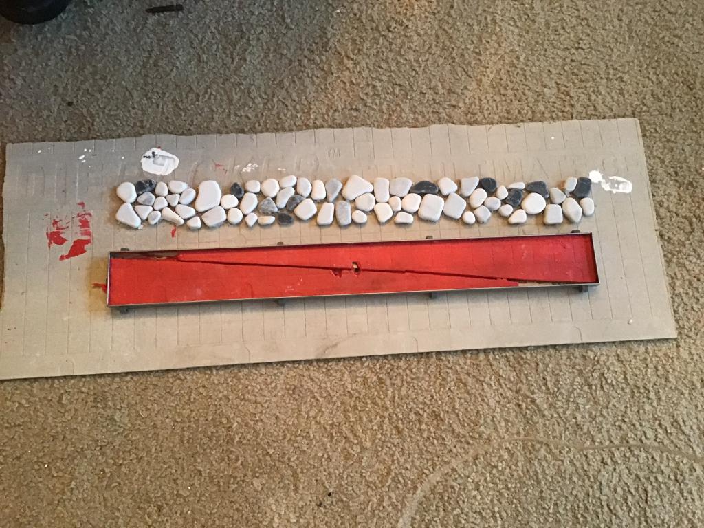

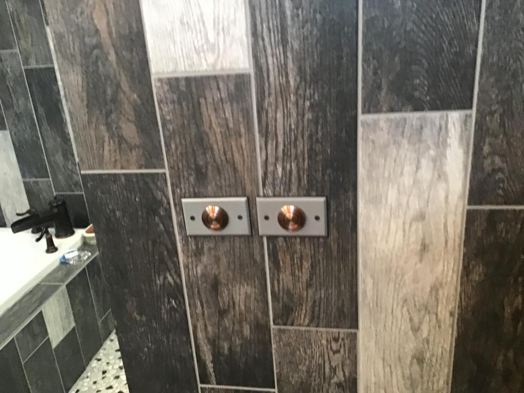

Pullstart 71,455 #288 Posted January 15, 2020 Push buttons are mounted and the drain cover has been coated with Redgard. It’s ready for some mortar and some stone! 4 Share this post Link to post Share on other sites

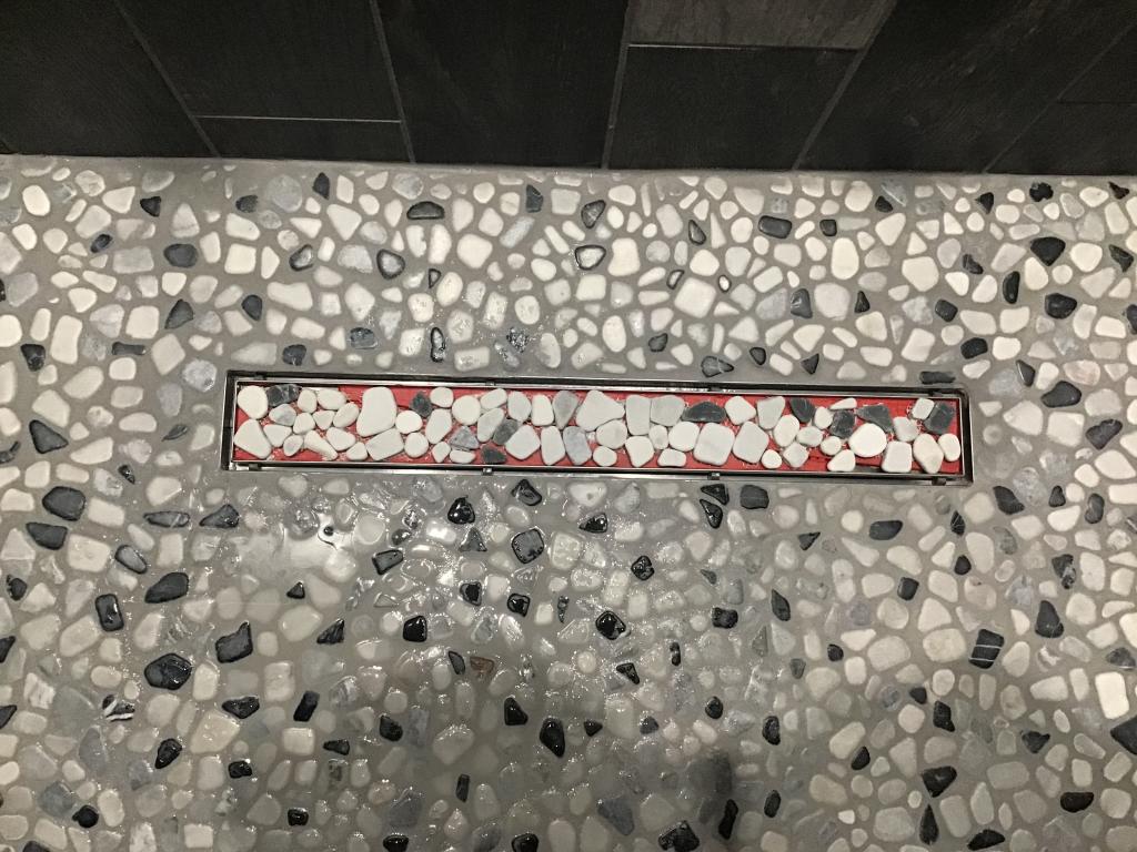

Pullstart 71,455 #290 Posted January 16, 2020 13 hours ago, dells68 said: I hated Redguard when we redid our shower. Not hard to put on,but looked like a scene from a horror pic!! Don’t worry man, I don’t plan to open that bucket for a long while now... My river rock layout looks decent enough to mix up some mortar! 3 1 Share this post Link to post Share on other sites
Pullstart 71,455 #291 Posted January 16, 2020 Looks like it’ll do just fine. I have left over grout still, but I made the mistake of discarding my sealer. It’s expensive stuff, I’ll find the smallest bottle possible to finish seal that. 2 Share this post Link to post Share on other sites
Pullstart 71,455 #292 Posted January 21, 2020 Some day, we’ll have a dining room that is not a construction area. That’ll be weird. until then, I’ve got a recruit helping me seal the last of the grout and river rock! 2 2 1 Share this post Link to post Share on other sites
Pullstart 71,455 #293 Posted January 22, 2020 Fits in great with it’s surroundings! 1 3 1 Share this post Link to post Share on other sites

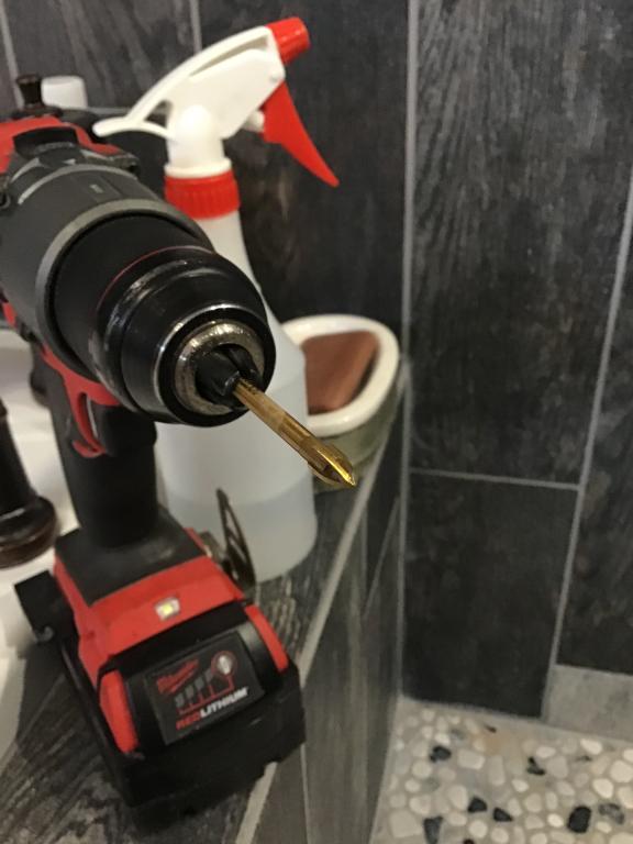

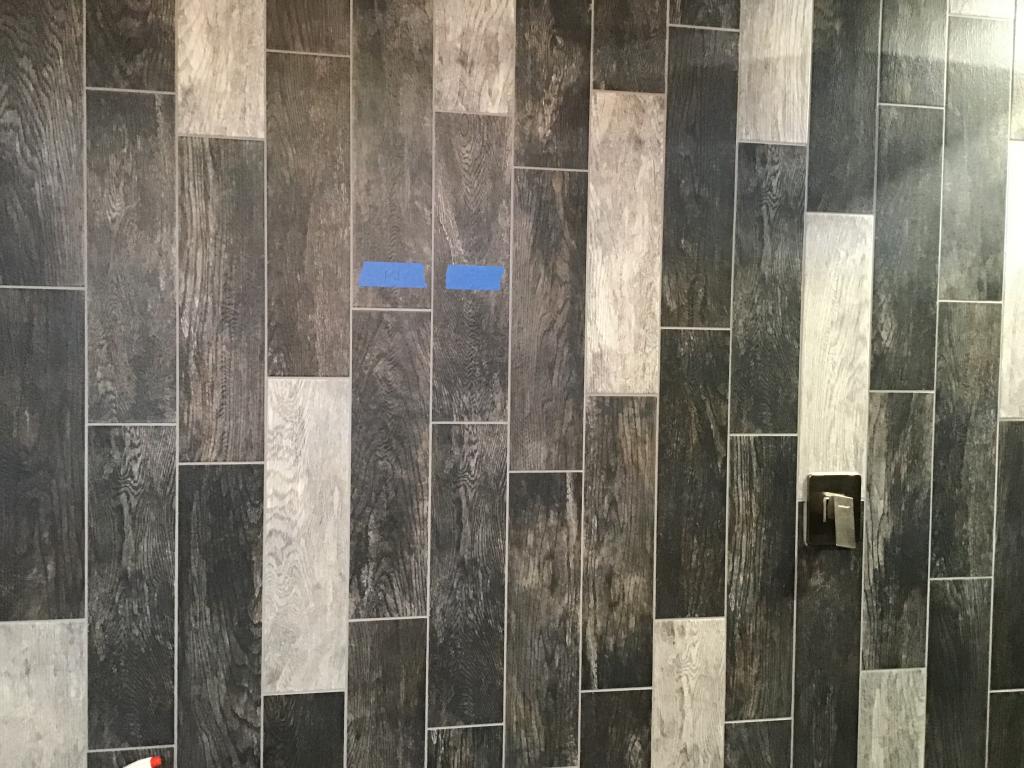

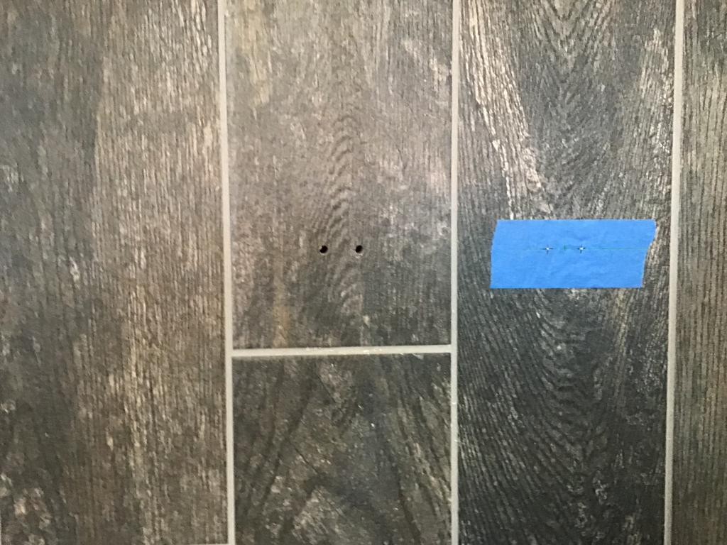

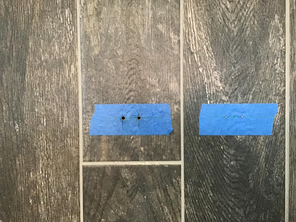

Pullstart 71,455 #294 Posted February 11, 2020 We have been using the shower for a few weeks now and have yet to install any towel hangers. A few items like shelving, full length mirror, etc have been added... but towels are draped over the wall. We noticed the wall area between the shower and tub stays dry, plus a towel would be handy for either option bathing or showering. I tried a cement drill on a scrap piece of tile and quickly realized drilling tile is no joke! I have a diamond tipped core drill that was used to make holes for the push button shower controls, but couldn’t seem to find a reasonably sized anchor to hold the screws for the hangers. We got a set of these fancy tile drill bits from Amazon and with plenty of constant fresh water from a spray bottle, things are looking like a finished bathroom is coming soon! 2 1 Share this post Link to post Share on other sites

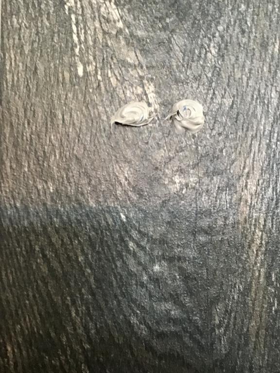

Pullstart 71,455 #295 Posted February 11, 2020 Both sets of holes are drilled. Tile is no joke! It’s amazing how hard it is to drill, yet how easy it is to break! 1 Share this post Link to post Share on other sites
Pullstart 71,455 #296 Posted February 11, 2020 I forgot to take a picture of the back of the hangers, but I made a tall /\ shape on the back with 100% silicone to shed any water that might get behind the hangers. 4 Share this post Link to post Share on other sites

JCM 11,419 #299 Posted February 11, 2020 Hi Kev, what did you think of the titanium bits ? I have to drill tile quite frequently when I do finish work in these fancy bathrooms and of course to fasten the closet flange to the floor to fasten the water closet to. I have been using milwaukee diamond drill bits and have had fairly good luck with them. Most all tile nowadays is very hard and difficult to deal with so don't feel alone. Nice to see you are nearing the end. Patience is your friend. 1 Share this post Link to post Share on other sites
Pullstart 71,455 #300 Posted February 11, 2020 Just now, JCM said: Hi Kev, what did you think of the titanium bits ? I have to drill tile quite frequently when I do finish work in these fancy bathrooms and of course to fasten the closet flange to the floor to fasten the water closet to. I have been using milwaukee diamond drill bits and have had fairly good luck with them. Most all tile nowadays is very hard and difficult to deal with so don't feel alone. Nice to see you are nearing the end. Patience is your friend. For the 12 bucks for a 5 or 6 pack of bits, it was worth it for 4 holes! Bosch has a nice looking kit that I ordered but it was hung up in shipping so I found this cheapie set and figured I’d give it a whirl. I bet if I kept fresh water in the spray bottle running the drill, it would last longer than I’d imagine a cheap off brand drill should ever last! 5 star rating from me! 2 1 Share this post Link to post Share on other sites
