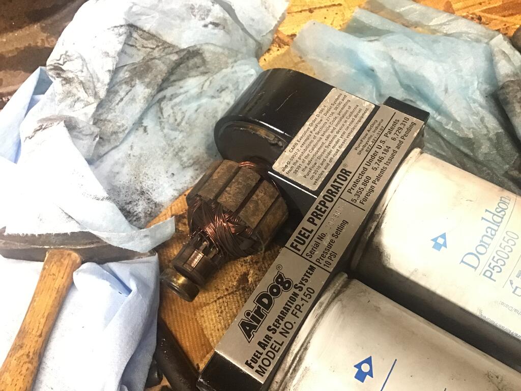

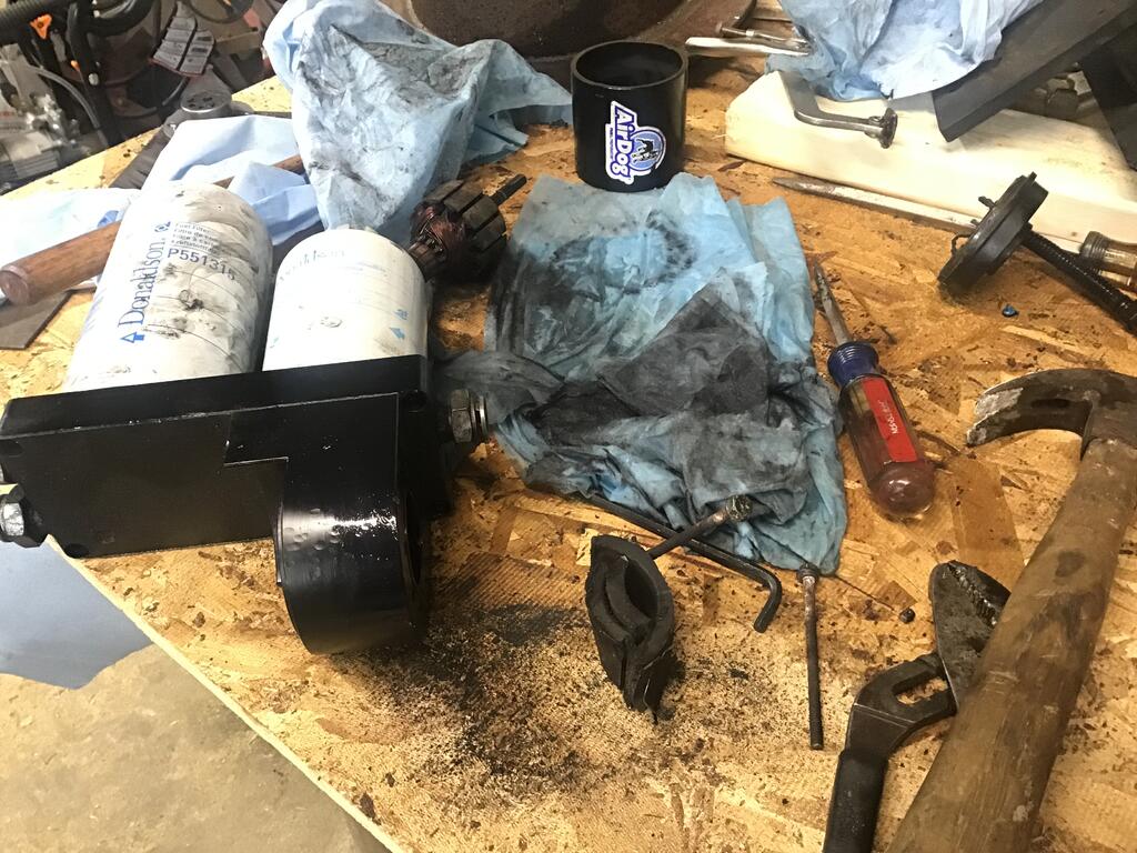

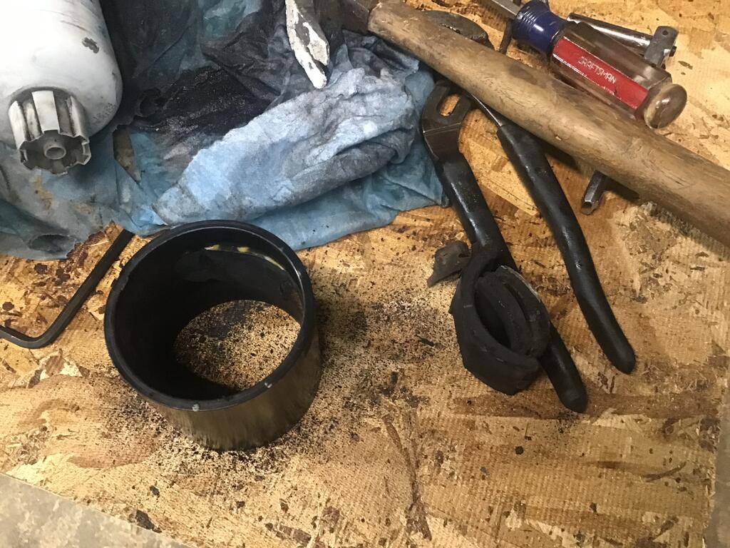

So, at Uncle Jim’s plow day, Norman’s “new” lift pump died a little.  It had been making a lot of noise.  The manufacturer assured me that noise is a common complaint, but there is no worry there.  Little did we all know, the motor was absolutely filthy.  Upon tearing it apart, both magnets also broke.  Well, there’s no mystery now!
Air Dog does not sell replacement parts, but I can purchase a new upgraded pump with better bearings for something like $300 with a lifetime warranty.  I suppose that’s what I’ll do.  @Achto think we can just whack it with a ratchet again?  :ROTF:
Looks like it's time to whack it with a BFH....& then replace it.:ROTF:

WHX??
Was that a new unit Kev? I could see a little brush dust but that is filthy.
I would have them warranty them Dan and ***** like an old lady that time of the month. Principle of the matter. Sides ain't like you ain't got a selection of trucks to borrow you need as far as down time.

The pump wasn’t actually new, just new to me.  The PO of the Texas truck told me through Google Translate that the pump was only 1 year old.  It looks like it was 1 year at the bottom of the gulf.

Question here.  @WHX24 @Achto @953 nut @Greentored @Redneckdavis (you still around buddy?) and all y’all old school hot rodder dudes....
Is there any amount of epoxy and clamping that will bring those magnets back from the dead?  This is a full time use pump, it never stops when the truck is running.

Sucks that AD doen't offer parts. What were they held on to begin with? Is that where the noise and carnage came from?
You might find a hight strenght epoxy that would work but things would half to be really clean. and small c clamps?
Achto
Sorry to say, but in my experience once the magnets break you are generally SOL.:(
I agree Jim that they don’t offer a parts dept... but it is what it is.
Dan I am planning a 40 hr round trip soon so no reason to half fix it and hope for the best.  I’ll unfortunately just get a new pump.

Ah .. I see now Kev one of the mags broke in half. ...yup yer done... :sad:
