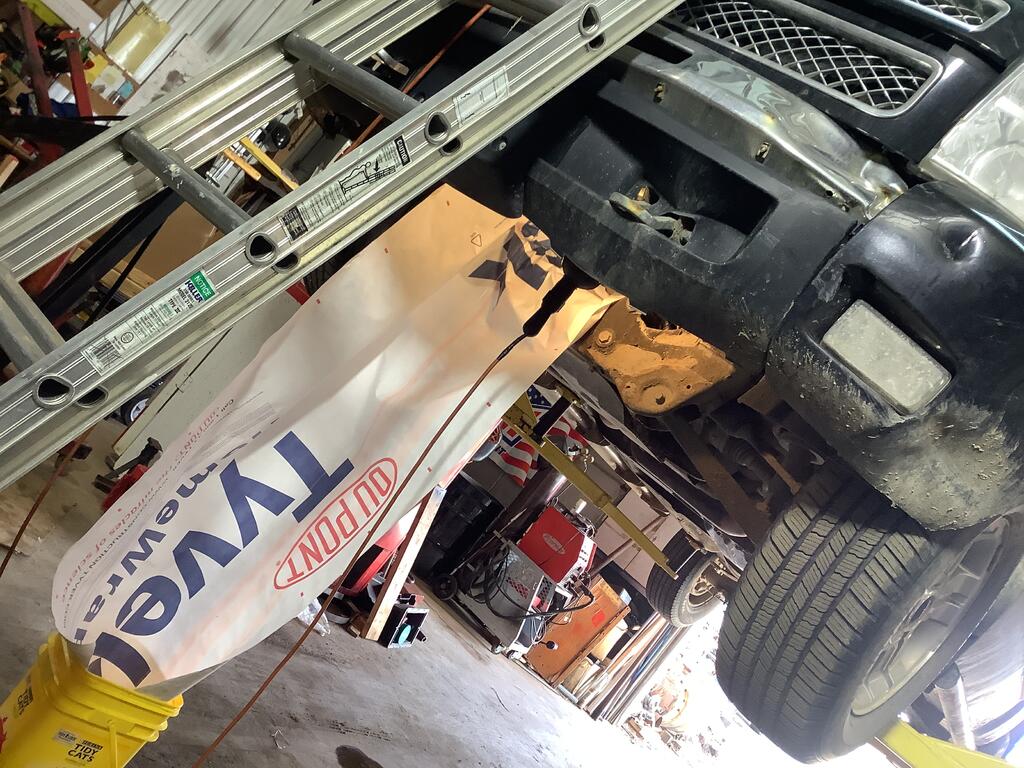

peter lena
@Pullstart  good for you ,  all those body seams , box sections , inside doors , fender edges , you will see a film show up in related areas , telling you the creeping lube is getting in there , suspension areas . that rear end and related springs . that oil film will stop rust . my latest car was almost done  a  year ago , recent servicing showed , complete coverage , not a speck of rust , and an oil like film everywhere .  just a marvel  to look at the protection . stay after it , greasy , pete

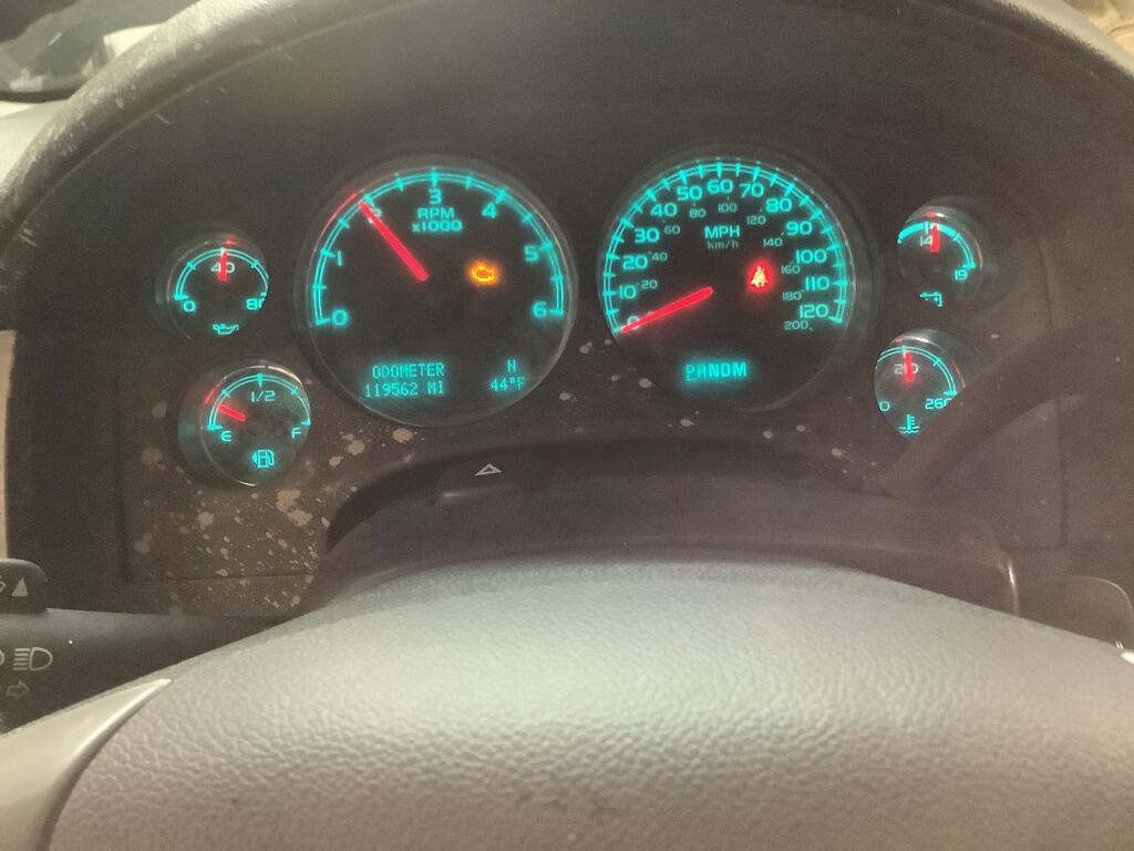

I took the maiden voyage today.  There’s a check engine light (crank position sensor) and my assumption is a residual code from when the crankshaft was in two positions at once!
Clear it and see if it comes back.

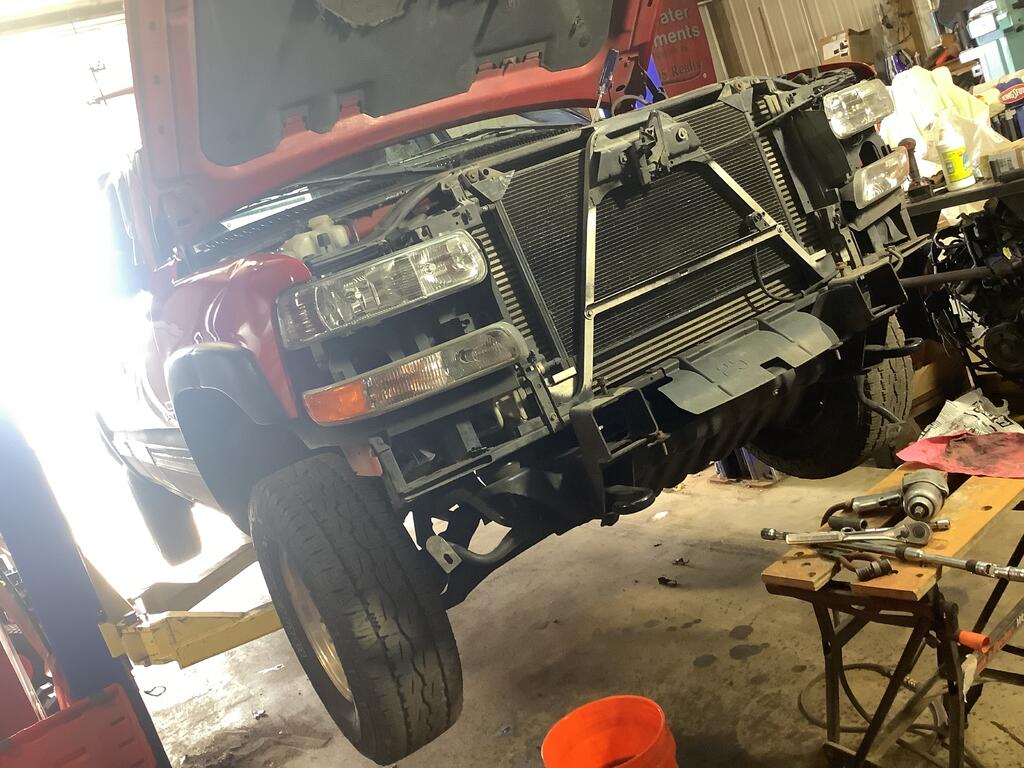

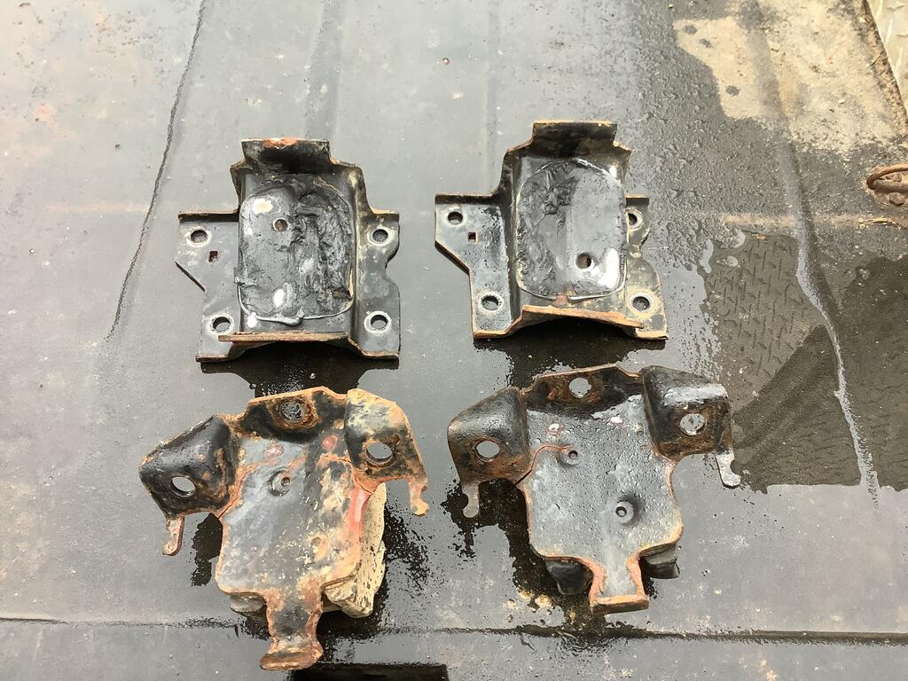

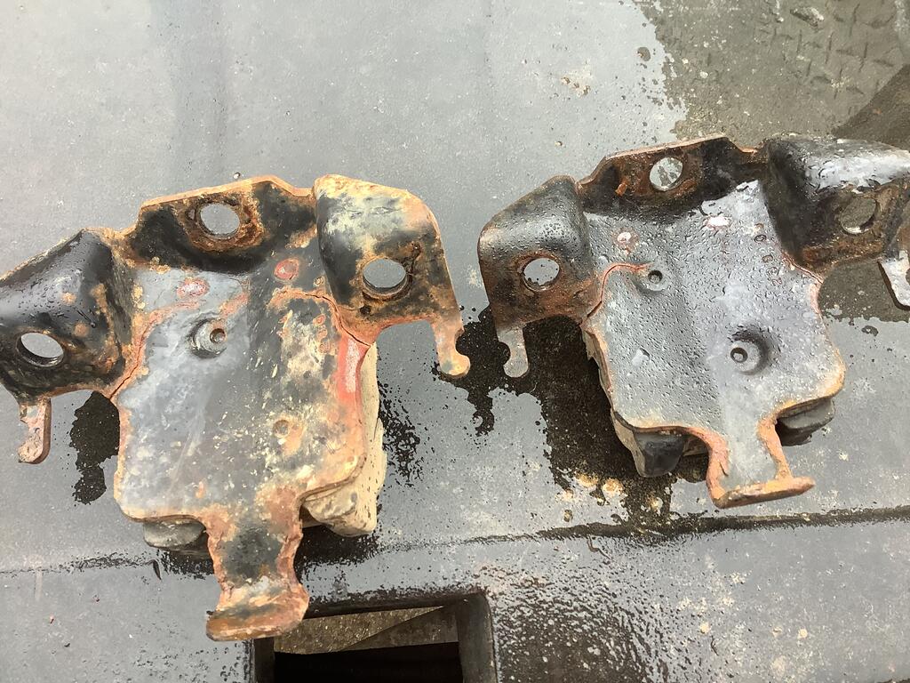

Cleaning up today, I noticed the back of the broken motor mounts.  They have some old cracks across the majority of them, along with impact carnage and twists.  The customer and I had the chicken or the egg debate, whether the broken crankshaft wrecked the mounts, or if the mounts broke the crank.  There is evidence of the truck being in a pretty hard accident, tabs on the frame are bent, headlights wire tied together, etc.
I think this solidifies the idea that the mounts have been bad for quite a long time.
  • Sad 1
Next specimen…
This one’s getting a crate engine, then a trip to the body shop.

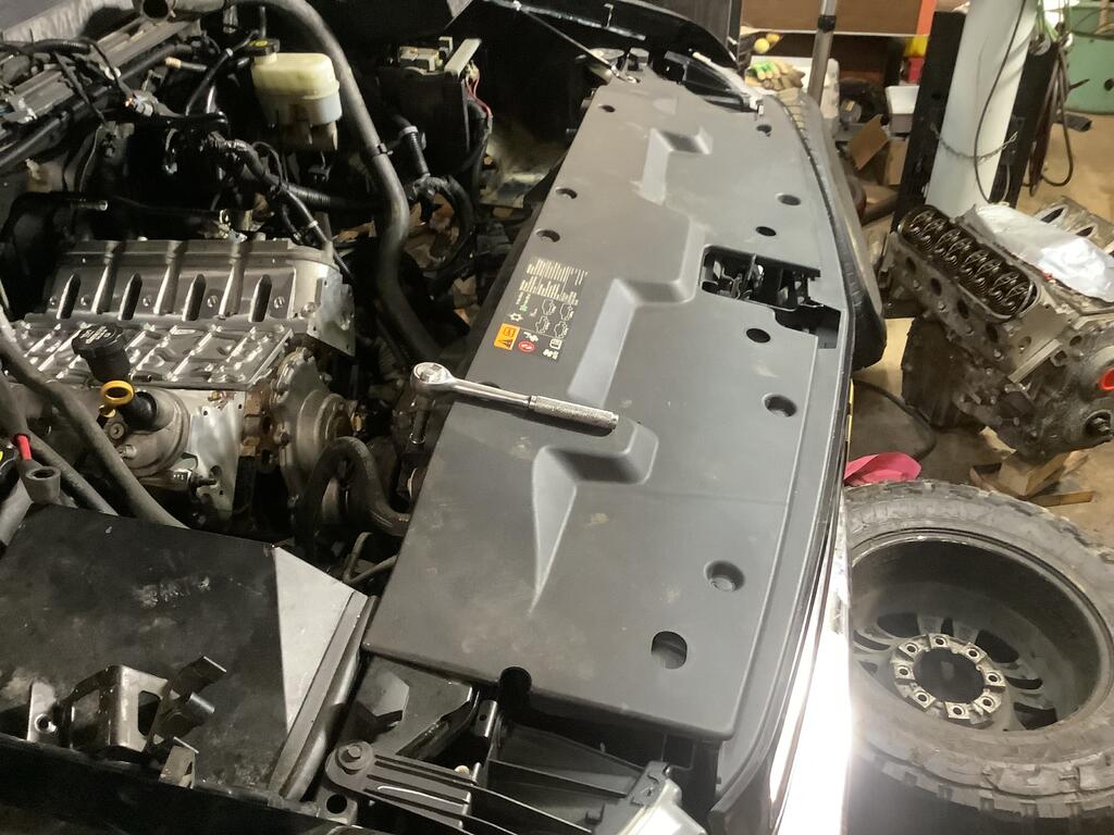

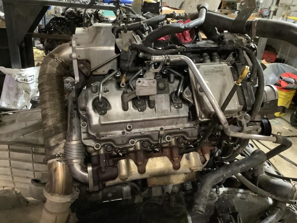

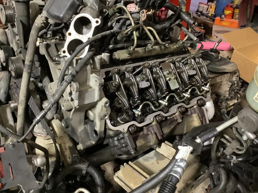

Though I’m replacing all 8, I realized that it’s just as easy to read a glow plug as it is to read a spark plug to find the rich (or leaking) cylinder
Norman’s current state:  passenger side is buttoned up with new (reman) injectors and new glow plugs too!
I started on the driver side now.  Tear down!  Found the blown power steering hose too, so I replaced that to clean things up a bit.
