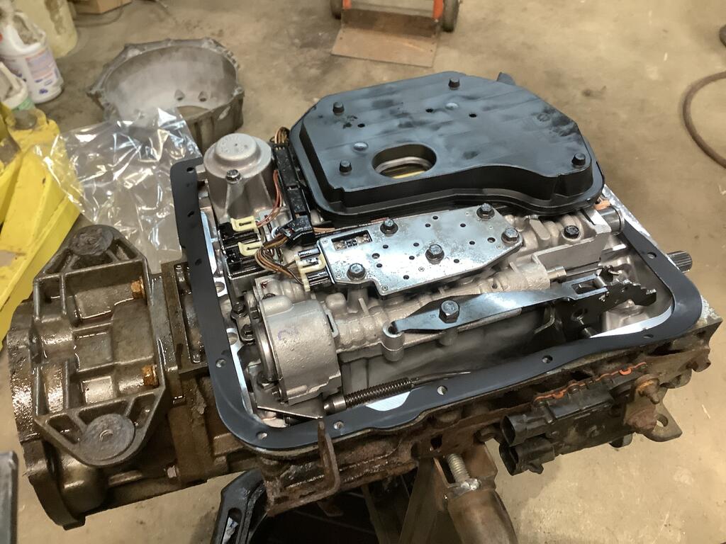

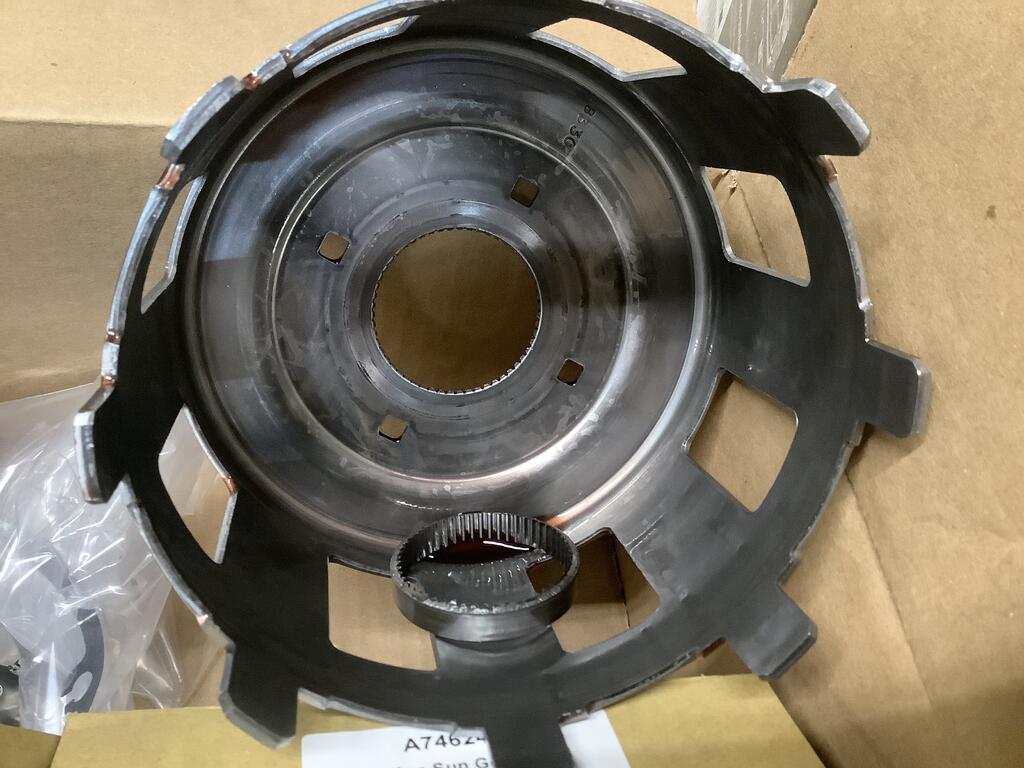

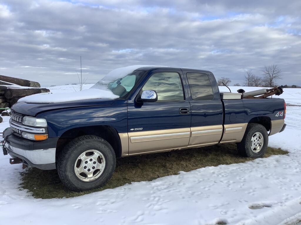

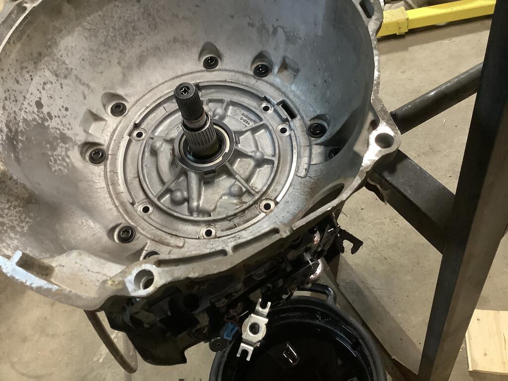

And now I turn the page.  I’ve needed to replace the sun shell in this 4L60E for about 4-5 years.  It’s a ‘99 Chevy 1500 with 76,000 miles on the ticker.  If all goes well, it’ll be my winter daily driver soon, then I’ll have Norman for the summer time.  Then I can sell my 2020 and get out of payments on my vehicle!
While I’m in here, I have a shift kit,wide band, and might eventually do the Corvette servo.  It’s back ordered so I am just doing what I can.

I got the most of the shift kit done yesterday.  In the instructions it very strongly suggests replacing the forward piston and accumulator piston.  I called the supply house and they have both in stock, 12 bucks out the door.  C’mon guys, tell me that when I’m there!  I’ll spend more than $12 to get there and back.  :scratchead:

I know.  I’ll be into this build less than $300 to have a pretty dang stout slushbox.

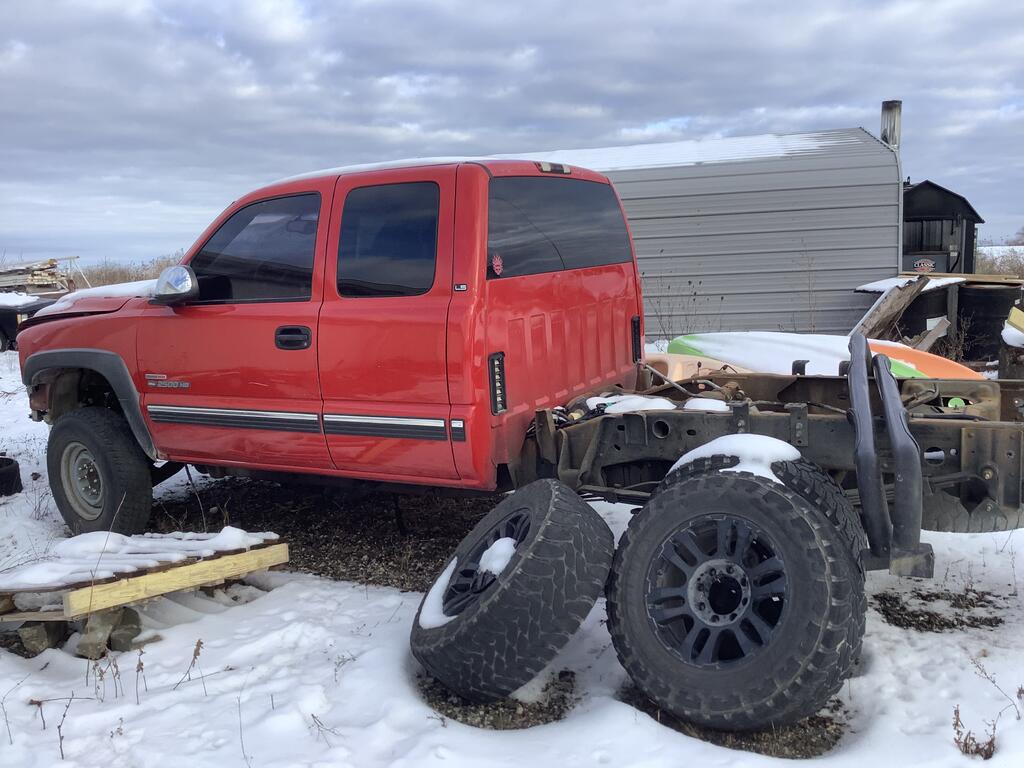

I am unsure where this project will end up long term, but I plan to get the blue truck we dubbed “The Cadillac” going.
After winter’s over... or even during, the ideas are endless.  I’d love to solid axle swap the red truck frame (currently 2wd) with a Ford style Dana 44 or 60 (it’s been a while) I have or even find a later model Dodge front axle then bring the power train and associated wiring over from the blue one.  A 5.3L powered 2500HD sounds silly, but not with an intercooled turbo.  This would yield me a clean southern bodied 4wd, heavier capability and a true 4th door.  The blue truck being a ‘99 only has one functional back door.  Of course, the Texas body is the right color for hauling Horses too!
