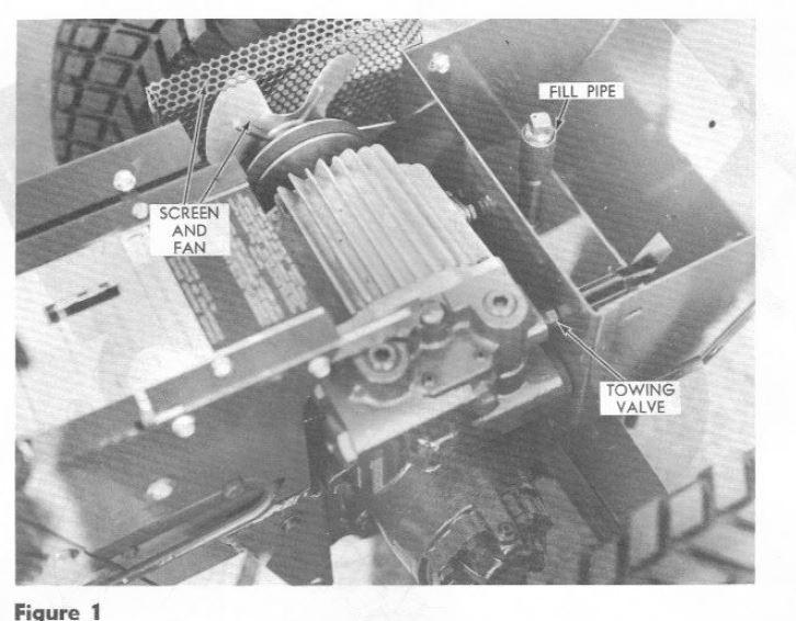

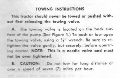

MikeR55 2 #1 Posted July 6, 2018 How do I put my 1075 in nuetral to push it to the barn ? Share this post Link to post Share on other sites
pfrederi 19,069 #2 Posted July 6, 2018 (edited) Welcome Whole manual is here (you want part 1) Edited July 6, 2018 by pfrederi 1 Share this post Link to post Share on other sites
PeacemakerJack 10,803 #3 Posted July 6, 2018 1 hour ago, MikeR55 said: How do I put my 1075 in nuetral to push it to the barn ? Funny story about that—I remember my dad moving the 875 around the garage when I was kid. He would pick up one wheel and wrestle with the tractor trying to get it where he wanted to go. When we received the decal kit from @Vinylguy Terry it had the decal with the info about the towing valve. Dad didn’t know where that needed to go and so I asked on here. Then I showed him the valve...we opened it and he couldn’t believe how much easier it moved... Thanks @pfrederi for the link and info! 6 2 Share this post Link to post Share on other sites
