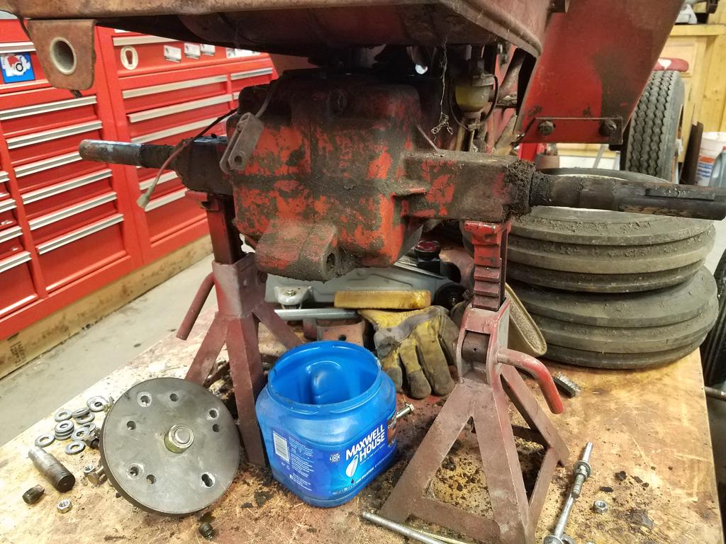

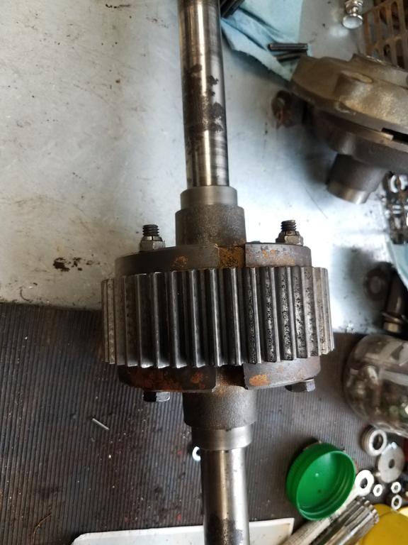

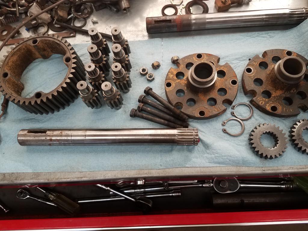

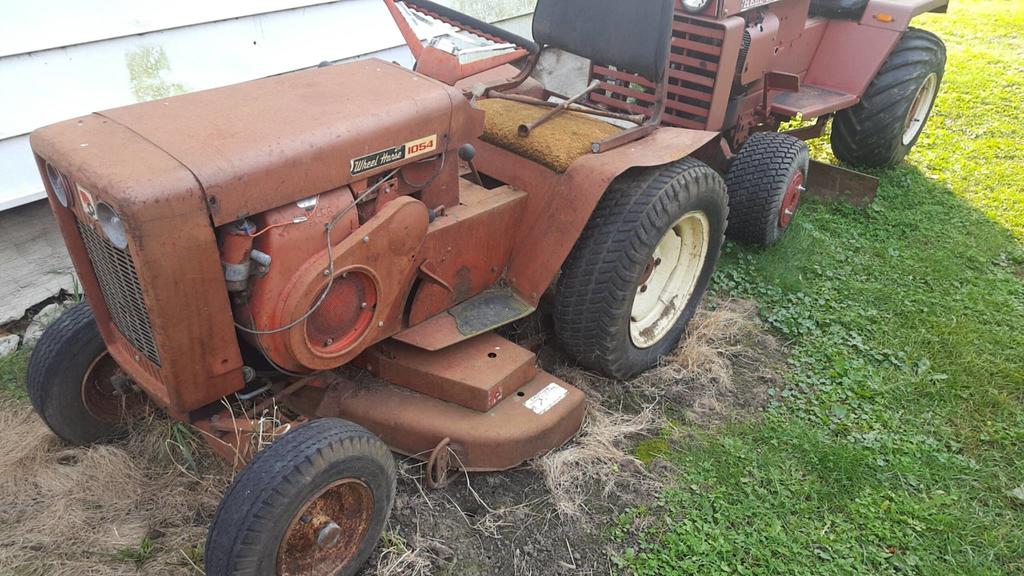

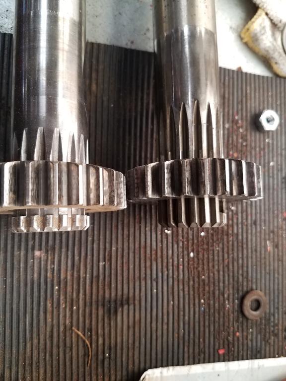

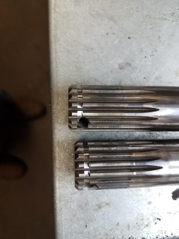

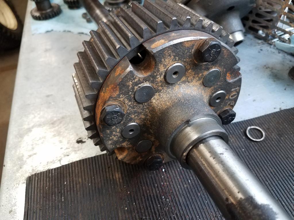

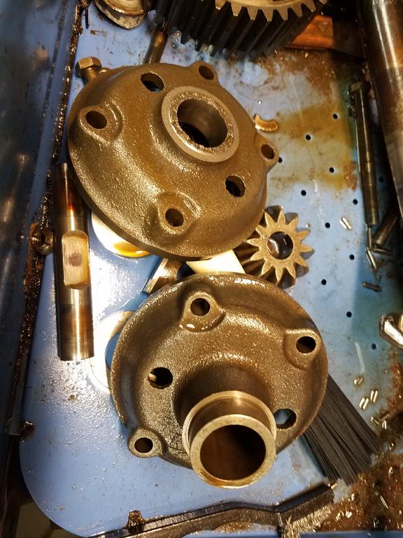

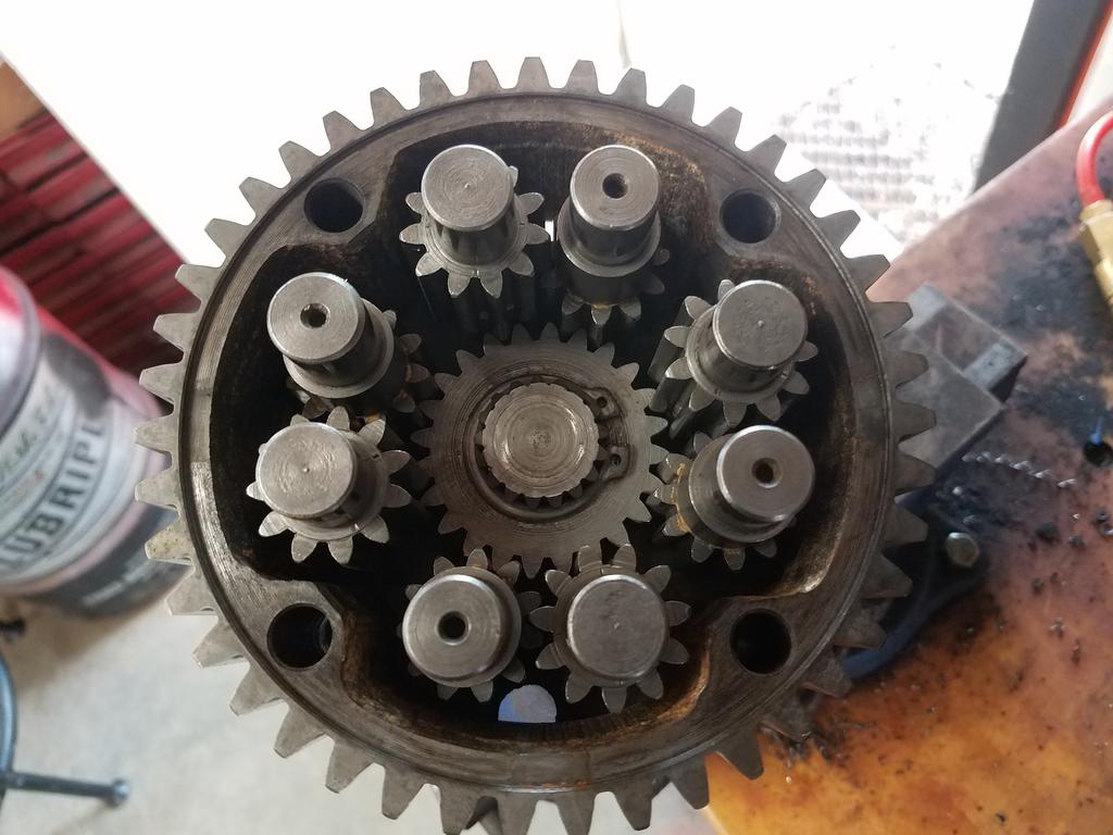

Shynon 7,728 #1 Posted July 5, 2018 So i picked up this 1054 over a year ago. Finally decided to get busy on it. Pulled the hubs off, i knew it had a bad wheel bearing. Plan was to put an 8 pinion differential in it. Found part of the spider gear differential broken. Got it pretty much cleaned up, 8 pinion cleaned and waiting. Next up cut the snap ring grooves into the axles. 3 8 Share this post Link to post Share on other sites

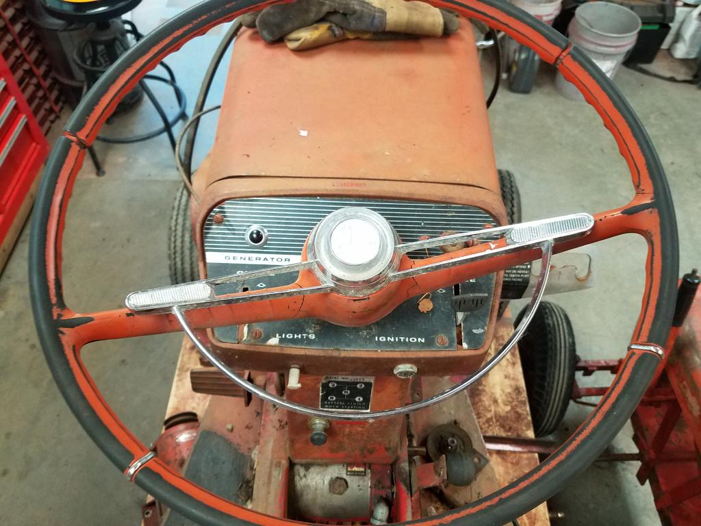

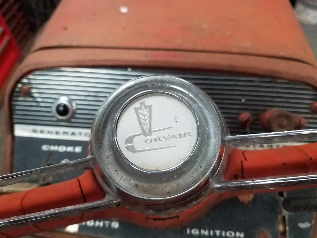

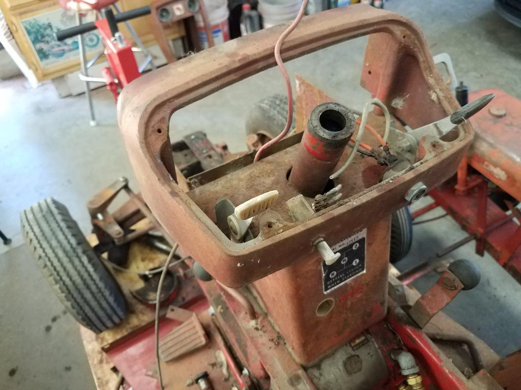

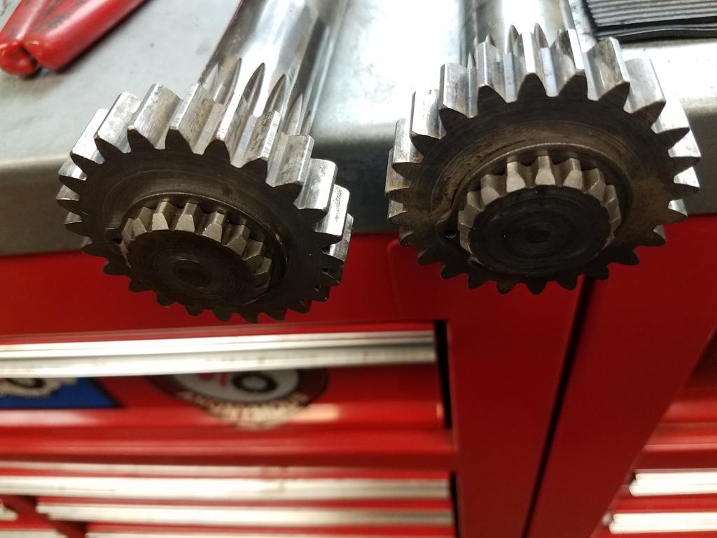

953 nut 70,071 #3 Posted July 6, 2018 What make of car did the steering wheel come from and is the horn ring functional? 1 hour ago, Shynon said: cut the snap ring grooves into the axles. Couldn't you use the roll pins rather than snap rings? 1 Share this post Link to post Share on other sites
Shynon 7,728 #4 Posted July 6, 2018 13 minutes ago, Achto said: I remember this photo. Glad to see that it's finally going under the knife & looking forward to seeing it after surgery. You'll have it done for Garden Tractor Days, Right?? Hopefully by @WHX20, or by that time WHX25's meet and greet. 9 minutes ago, 953 nut said: What make of car did the steering wheel come from and is the horn ring functional? Couldn't you use the roll pins rather than snap rings? It's a Corvair steering wheel looks cool probably gonna stay. 3 9 Share this post Link to post Share on other sites

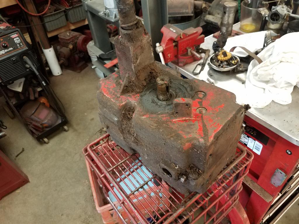

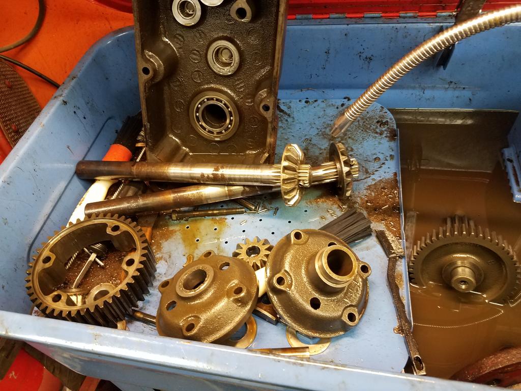

WHX?? 58,327 #10 Posted July 6, 2018 Just cause a guy ain't hungrey Richard don't mean he can't lookit the menu!...... Tom why don't you wash before disassembly .... saves alot of grief in the parts washer? 2 3 Share this post Link to post Share on other sites
Shynon 7,728 #11 Posted July 6, 2018 1 minute ago, WHX20 said: Tom why don't you wash before disassembly pressure washer broke, no time to repair too busy 1 2 Share this post Link to post Share on other sites

19richie66 17,937 #13 Posted July 6, 2018 Couldn’t you use a gt14 differential and axles? I think I have a diff and axles from one I could measure. 2 Share this post Link to post Share on other sites
953 nut 70,071 #14 Posted July 6, 2018 9 minutes ago, 19richie66 said: Couldn’t you use a gt14 differential and axles? I think I have a diff and axles from one I could measure. Axles might work, but the bull gear is not the same size. 1 Share this post Link to post Share on other sites
19richie66 17,937 #15 Posted July 6, 2018 Got it. Could you use and 8speed diff with gt14 axles? Then you wouldn’t have to cut the snap ring grooves? Just asking for future reference. Share this post Link to post Share on other sites
953 nut 70,071 #16 Posted July 6, 2018 4 hours ago, 19richie66 said: Got it. Could you use and 8speed diff with gt14 axles? Then you wouldn’t have to cut the snap ring grooves? Just asking for future reference. 2 Share this post Link to post Share on other sites

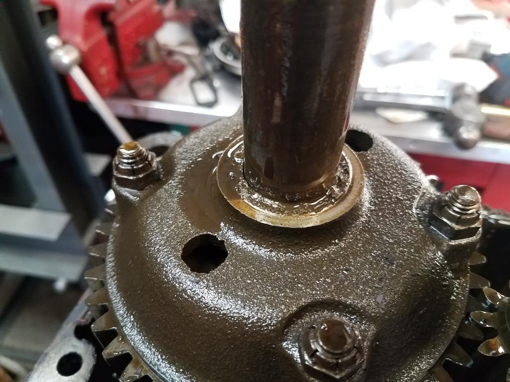

Shynon 7,728 #17 Posted July 6, 2018 22 hours ago, 953 nut said: What make of car did the steering wheel come from and is the horn ring functional? Couldn't you use the roll pins rather than snap rings? Tried the axles with roll pins and the differential will not go together. The gear is 5/16 from end of axle with snap ring and 7/16 from the end with roll pin thus tha axles touch and differential is approx. 1/4" or less from going together. Pulled off the motor and grill. Took steering wheel off and it looks like a homemade taper fit to the shaft no key. 1 2 Share this post Link to post Share on other sites

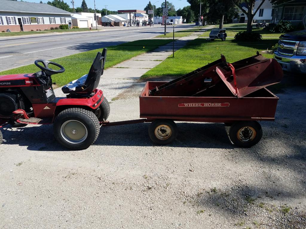

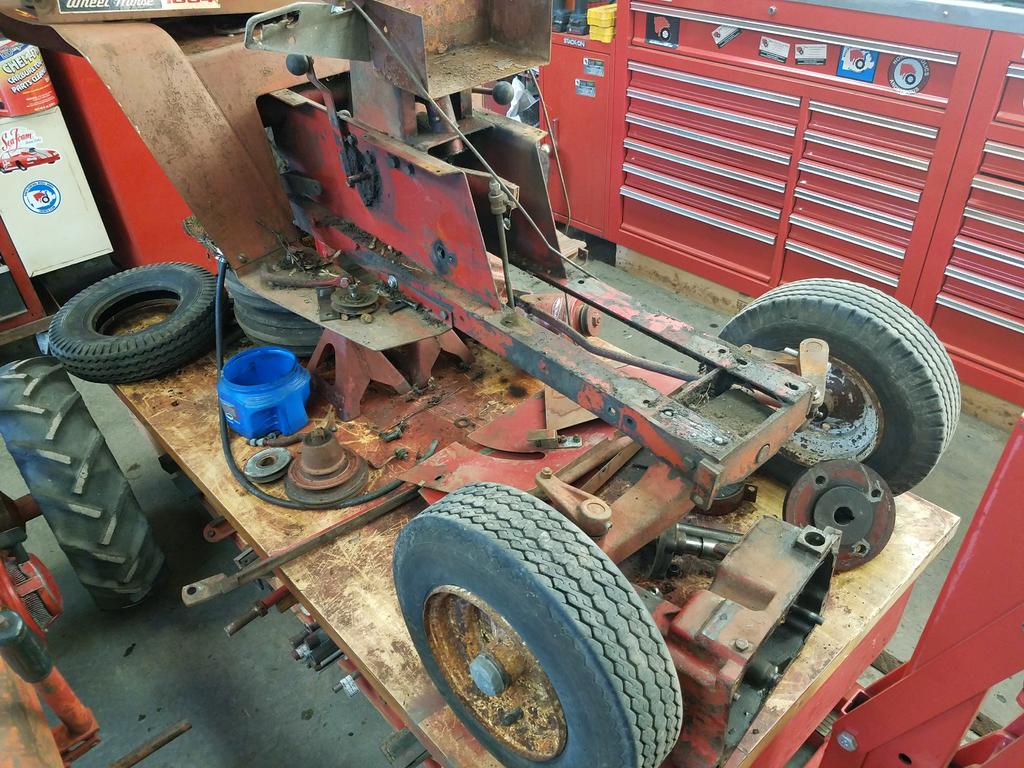

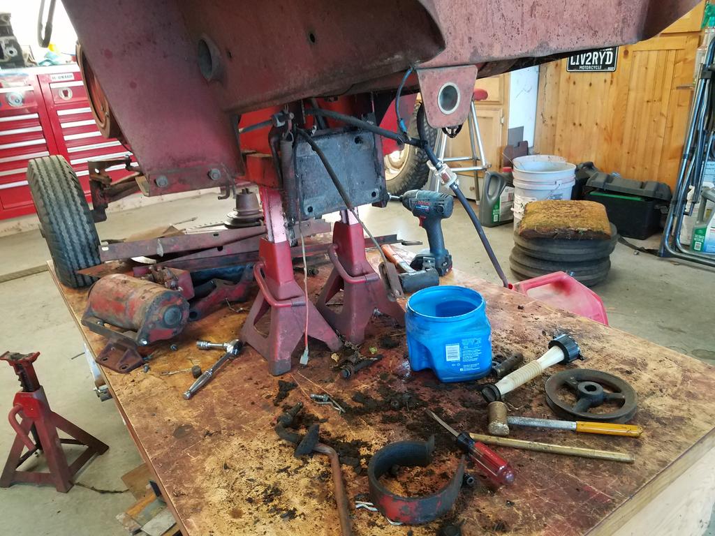

Shynon 7,728 #19 Posted July 7, 2018 Stripped all the way. Pressure washer broke, no trailer wife says why not put it in that one. Off to the carwash i go. 1 7 Share this post Link to post Share on other sites
19richie66 17,937 #20 Posted July 7, 2018 (edited) So how far to the wash? Hope we don’t see you on the 6pm news being chased by a cop. Low speed pursuit with stop sticks Edited July 7, 2018 by 19richie66 1 5 Share this post Link to post Share on other sites
Shynon 7,728 #21 Posted July 25, 2018 Good friend cut the grooves into the axles, actually had to grind them. So today i had some time to put the differential together. Next up visit @wheelhorseman and get some new bearings. 1 8 Share this post Link to post Share on other sites
19richie66 17,937 #22 Posted July 25, 2018 Those look great. Keeping this in mind just in case I need to follow suit. 1 1 Share this post Link to post Share on other sites

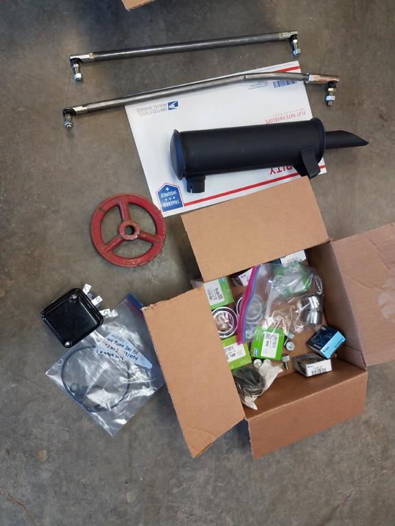

Shynon 7,728 #23 Posted August 10, 2018 Not alot of progress, just buying up parts for this project. Got an awesome seat from @BOB ELLISON, man is this thing nice. Transmission kit, tie rod and drag link from @wheelhorseman. New muffler stack, and regulator. NOS transmission drive pulley from @smokin joe 5 2 Share this post Link to post Share on other sites
