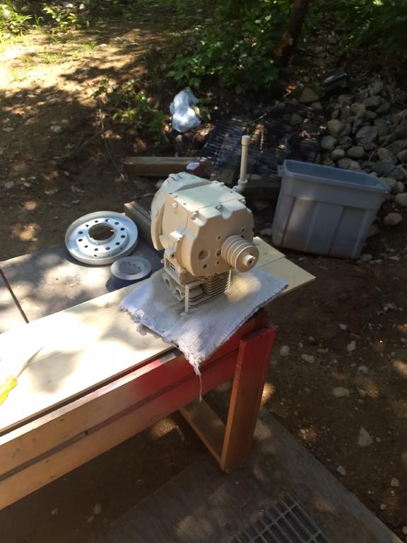

ebinmaine 79,740 #23 Posted July 6, 2018 On 7/4/2018 at 6:47 AM, squonk said: non-flammable brake cleaner. What I ended up doing was to degrease the engine with the spray purple stuff two times. Followed that with about 1 and 3/4 cans of brake clean sprayed at various places and times. On 7/4/2018 at 8:54 AM, Howie said: Since that is a paint and primer I would just spray it on over a clean surface. That is exactly what I did. On 7/4/2018 at 10:09 AM, clueless said: I've used the Rustoleum 2x on a couple of non tractor projects, I like the way it sprays and sets up better the the plain Rustoleum. Trina and I both agree with that. In fact, we don't buy any other brand of paint right now. Here is a picture of the final result. Share this post Link to post Share on other sites
