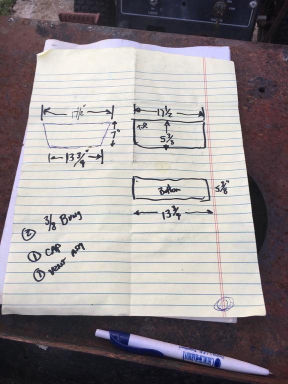

19richie66 17,932 #36 Posted July 13, 2018 (edited) Sorry @ebinmaine Eric. The fuel tank will be removed from under the seat and My son and I will be making a tank(from aluminum) that will set inside the toolbox pocket behind the seat. The top of the tank will be level with the seat base mounting plate. Slant at the bottom will be cut out but half will remain to support the tank. Has a little rust there anyways. Edited July 13, 2018 by 19richie66 1 3 Share this post Link to post Share on other sites

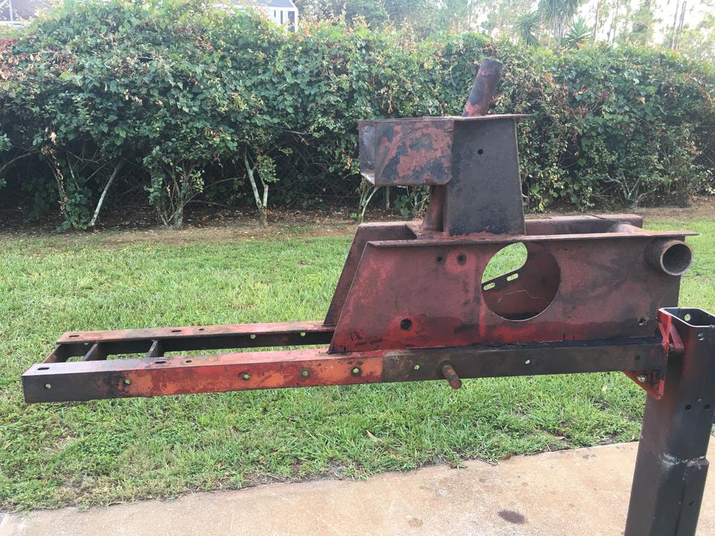

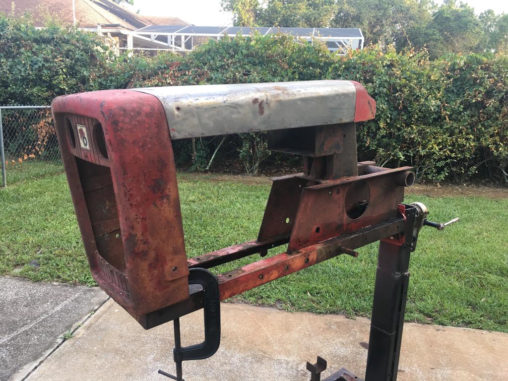

19richie66 17,932 #42 Posted July 13, 2018 That would be about 4 maybe 5 people? Anyways, here is the tower assembly sitting on the gt14 frame. Then with the 1054 dash and nose with a gt14 hood. Looks like it was made for it. I’m tickled pink. 5 1 Share this post Link to post Share on other sites

953 nut 69,105 #44 Posted July 13, 2018 With a bit of trimming that K Twin will be right at home. 2 Share this post Link to post Share on other sites

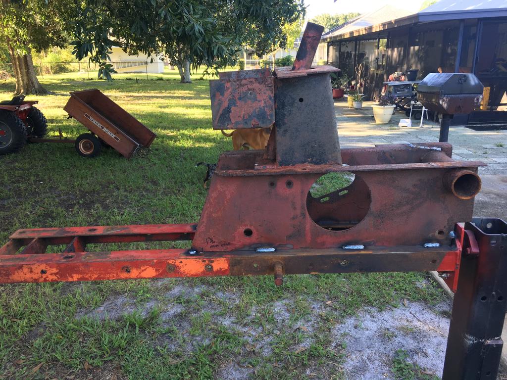

19richie66 17,932 #48 Posted August 5, 2018 Welded the 1054 tower assembly to the gt14 frame. Ordered an Eaton 1100 case gasket and axle seals for the transaxle. Want to get it to roller status. 2 3 Share this post Link to post Share on other sites
