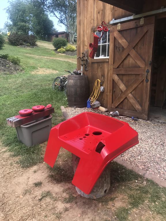

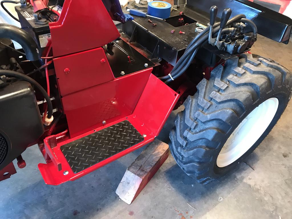

stevebo-(Moderator) 8,741 #26 Posted July 12, 2018 11 minutes ago, 19richie66 said: Steve, that looks fantastic! Thanks Richie. Coming out pretty good for a worker restore. 1 Share this post Link to post Share on other sites

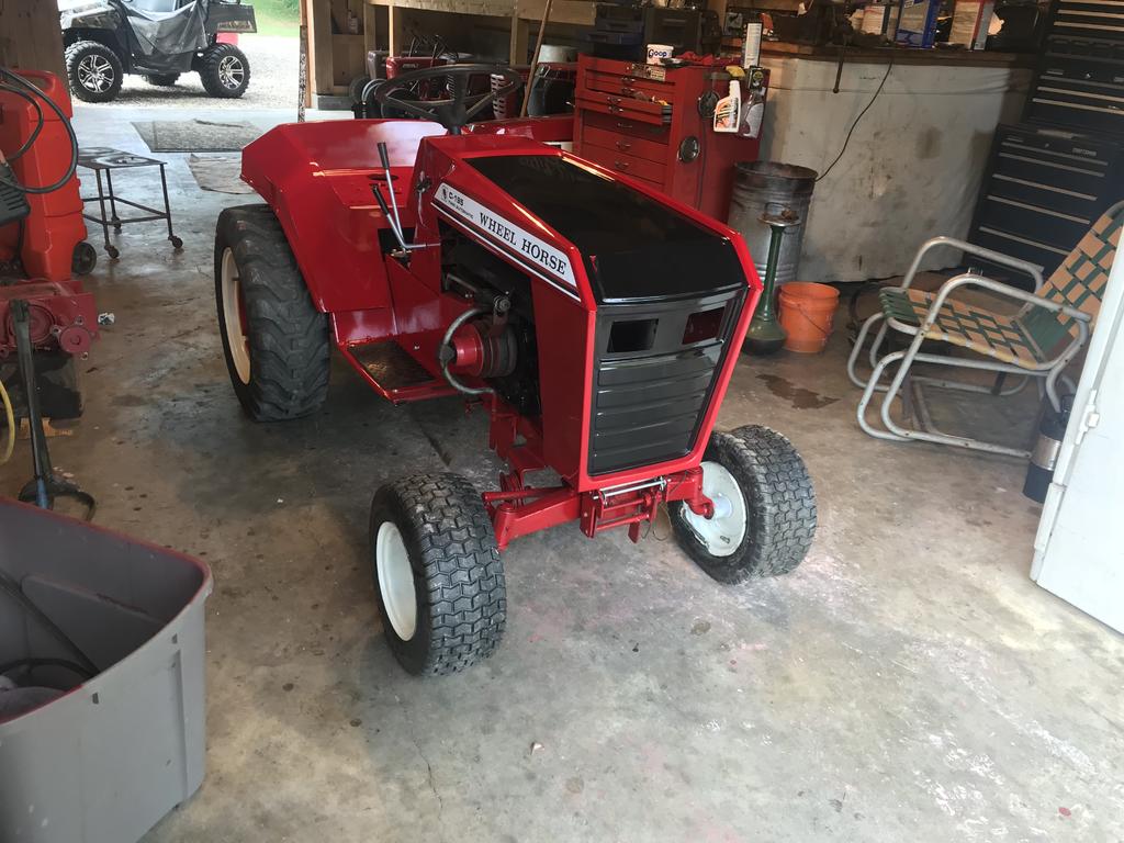

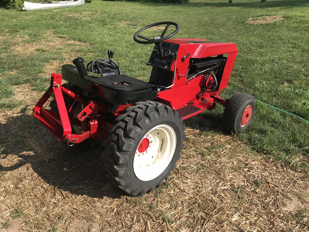

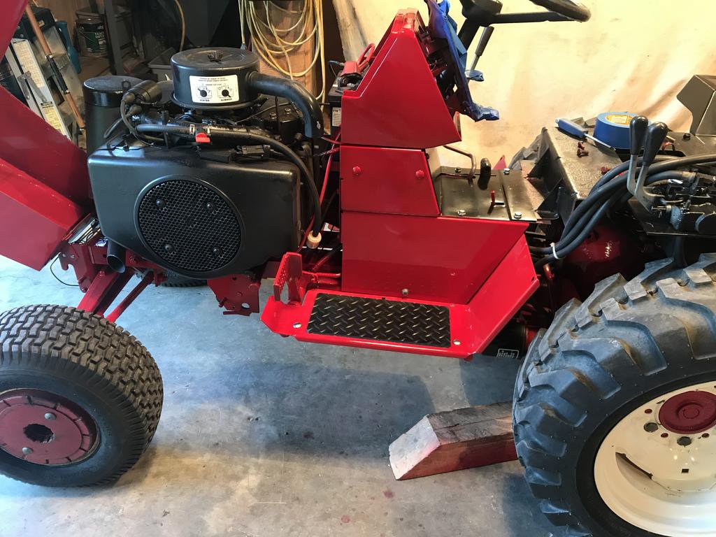

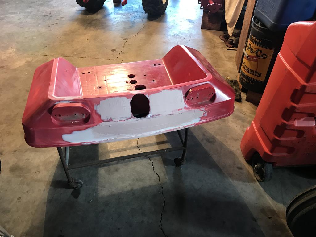

stevebo-(Moderator) 8,741 #28 Posted July 13, 2018 Fender pan ready for paint then install decals, paint front wheels, wheel weights and install new tires. Oh and paint a few of the rear pto parts and shenis done 6 1 Share this post Link to post Share on other sites

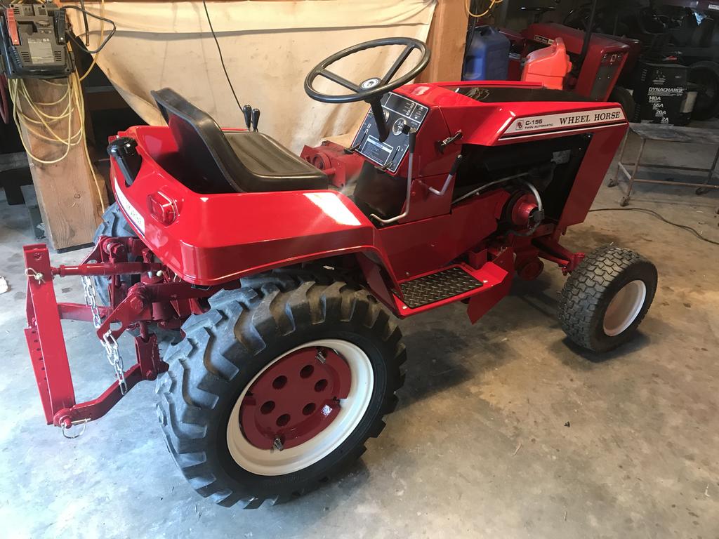

stevebo-(Moderator) 8,741 #32 Posted July 14, 2018 5 Share this post Link to post Share on other sites

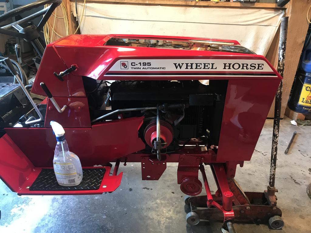

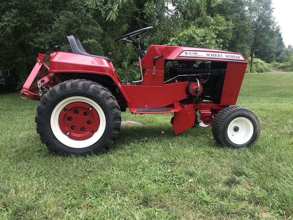

stevebo-(Moderator) 8,741 #33 Posted July 14, 2018 Decals on 4 7 1 Share this post Link to post Share on other sites
19richie66 17,930 #34 Posted July 14, 2018 Sure is pretty! 1 Share this post Link to post Share on other sites
dells68 7,499 #35 Posted July 14, 2018 I'd hate to get it dirty after all of that work! Very nice! 1 1 Share this post Link to post Share on other sites
JPWH 6,544 #36 Posted July 15, 2018 Very nice job Steve. Looks too good to work. 3 Share this post Link to post Share on other sites

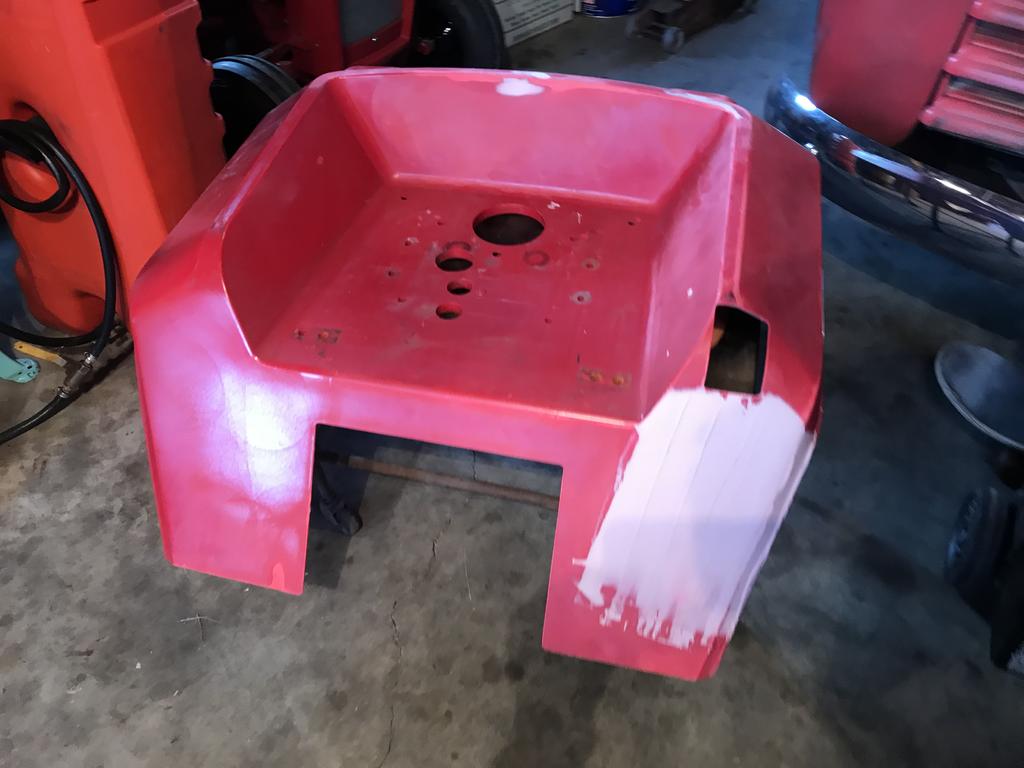

Pullstart 70,768 #38 Posted July 15, 2018 On 6/28/2018 at 6:10 PM, stevebo said: More progress today. I found a local auto paint store sells ready mixed auto paint and it is a really good match (at least the chip was). Here it’s not even 4 o clock and I’m outta likes for the day again. That pic of the pile of parts with the Chevy is something else Steve! 1 Share this post Link to post Share on other sites

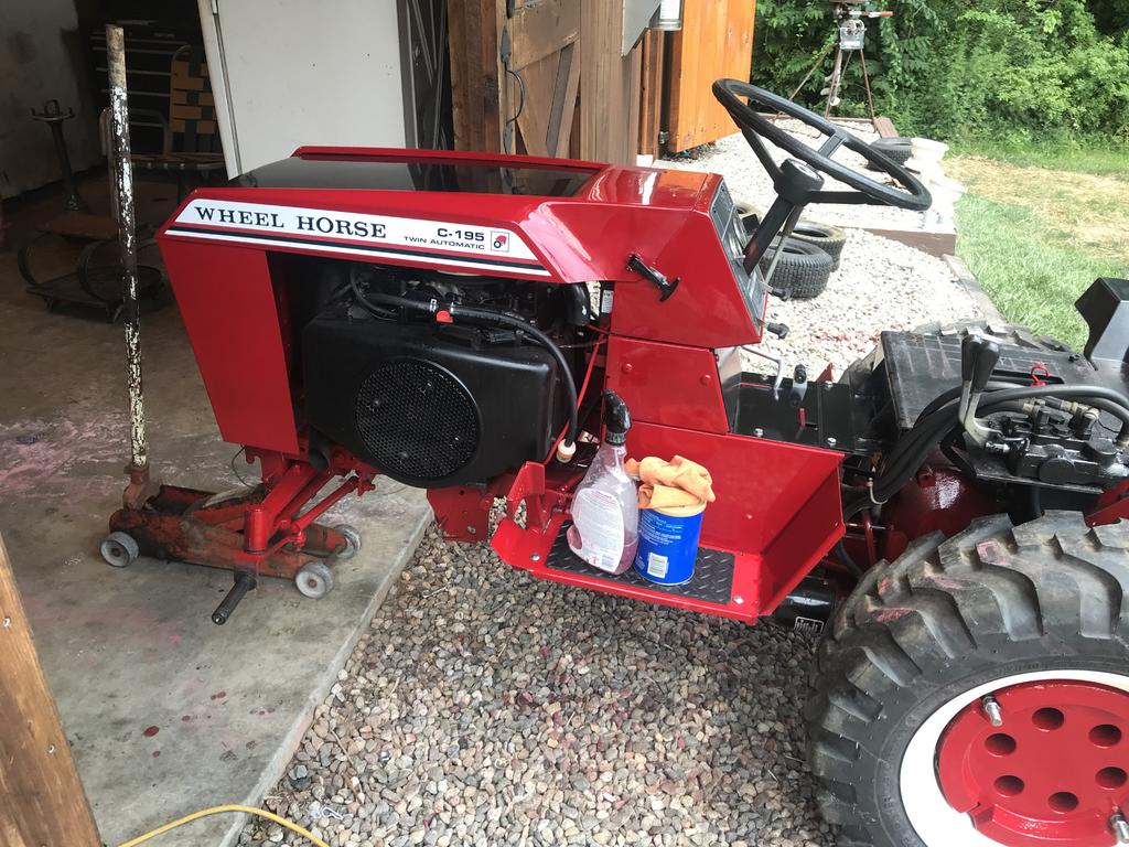

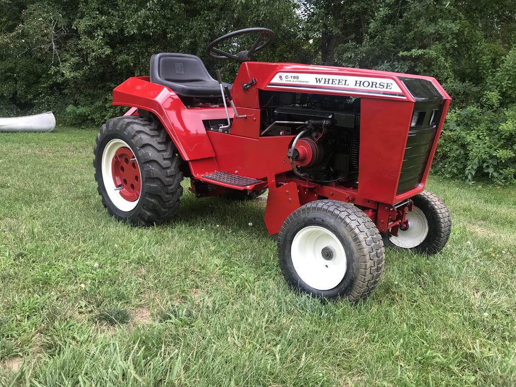

stevebo-(Moderator) 8,741 #40 Posted July 17, 2018 Getting close. Need to swap from tires, repaint front rims and install front wheel weights. Some other touch ups with paint (details) and call it done👍 2 7 Share this post Link to post Share on other sites
rjg854 13,200 #41 Posted July 17, 2018 Sharp looking tractor, Steve. I bet you'll be happy working that bad boy 1 Share this post Link to post Share on other sites

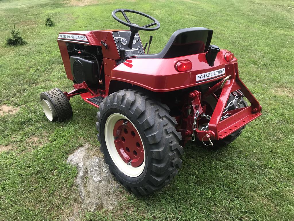

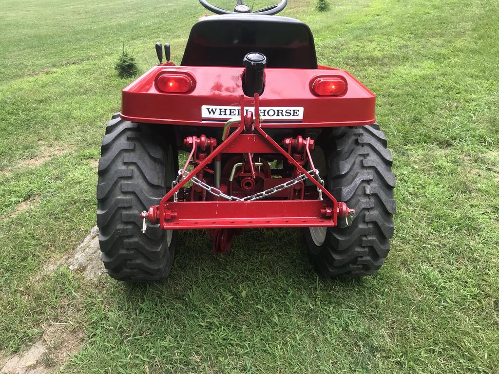

Sarge 3,473 #42 Posted July 18, 2018 Is it just me, or is that an odd placement for the sway chains on the 3pt? That's really turning out sharp - very nice work. Sarge 1 Share this post Link to post Share on other sites
stevebo-(Moderator) 8,741 #43 Posted July 19, 2018 10 hours ago, Sarge said: Is it just me, or is that an odd placement for the sway chains on the 3pt? That's really turning out sharp - very nice work. Sarge I think because the chains are a few few kinks too long it give the look they are out of place but that is the correct location👍 Share this post Link to post Share on other sites
Sarge 3,473 #44 Posted July 19, 2018 Ah, I see now. At first glance, it appeared the chains were on a high, fixed location. I see now they are attached to the top of the main lift arms, which allows them to keep a constant length through the lift range. The D's don't work that way - I've considered changing my 180 over somehow to the same idea so the chains won't bind when you lower the 3pt. Sarge Share this post Link to post Share on other sites
stevebo-(Moderator) 8,741 #45 Posted July 19, 2018 Sarge a little better angle 1 1 Share this post Link to post Share on other sites
Sarge 3,473 #46 Posted July 20, 2018 Yeah - those move on the same arc as the lift arms, much better than being anchored to the mounting frame on the D which is a fixed point. Sarge Share this post Link to post Share on other sites
