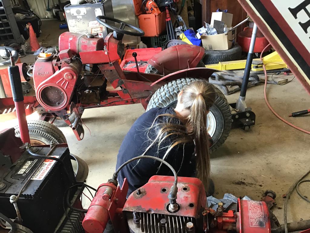

Pullstart 70,819 #51 Posted April 7, 2020 I can’t tell y’all how good this is, what a feeling! I need to get that kid out here to help prep the frame, so we can start assembly! 2 3 Share this post Link to post Share on other sites

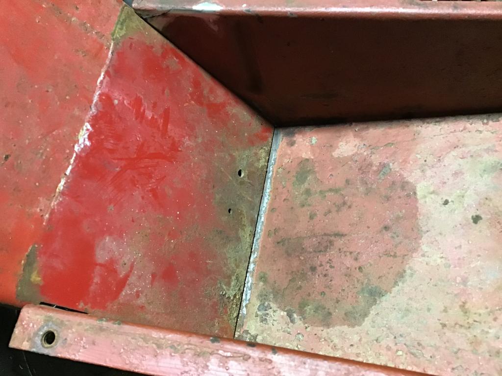

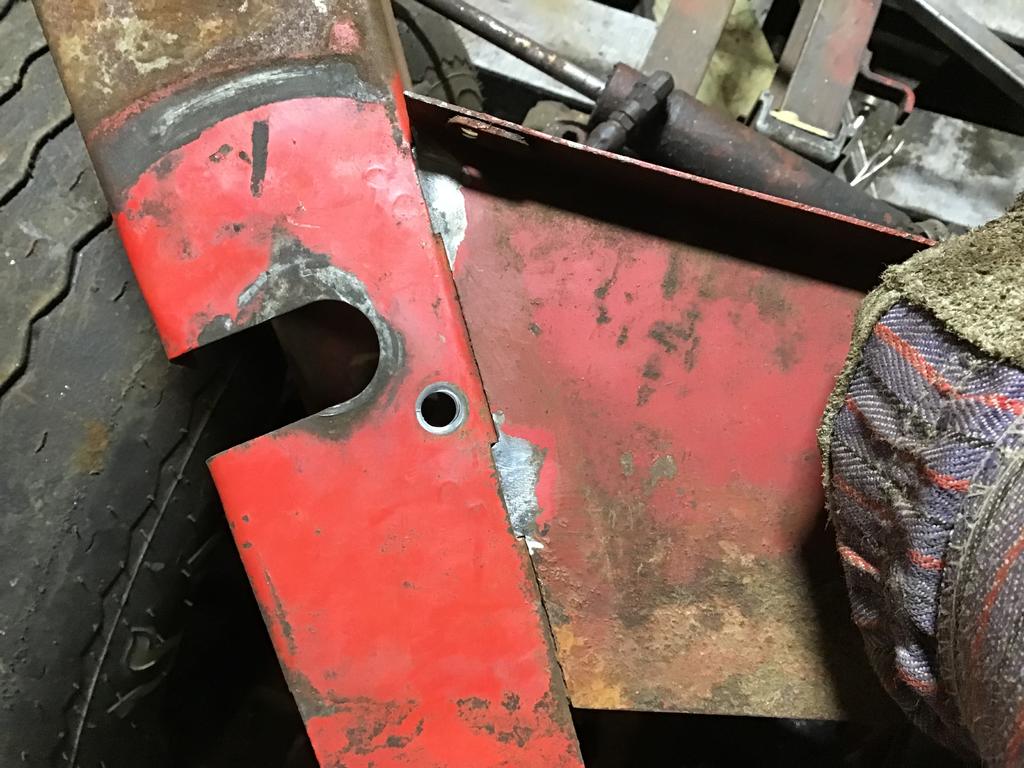

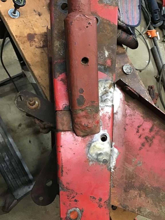

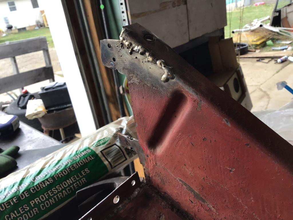

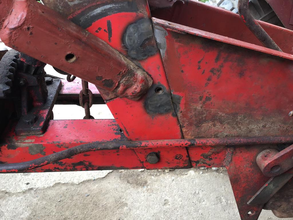

Pullstart 70,819 #53 Posted April 7, 2020 The crack has been welded on the front and back side. If it was a “class A” body panel, I’d tack / peen / grind / repeat as @19richie66 taught me. This isn’t so critical so I just did a series of tacks and will now grind it in. 2 Share this post Link to post Share on other sites

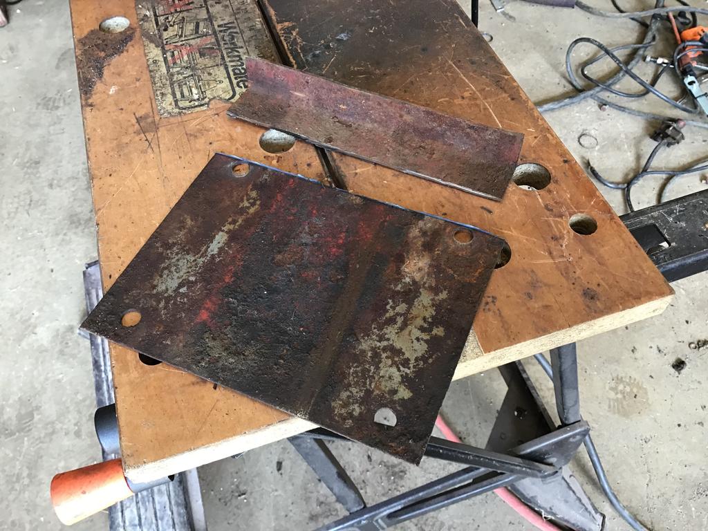

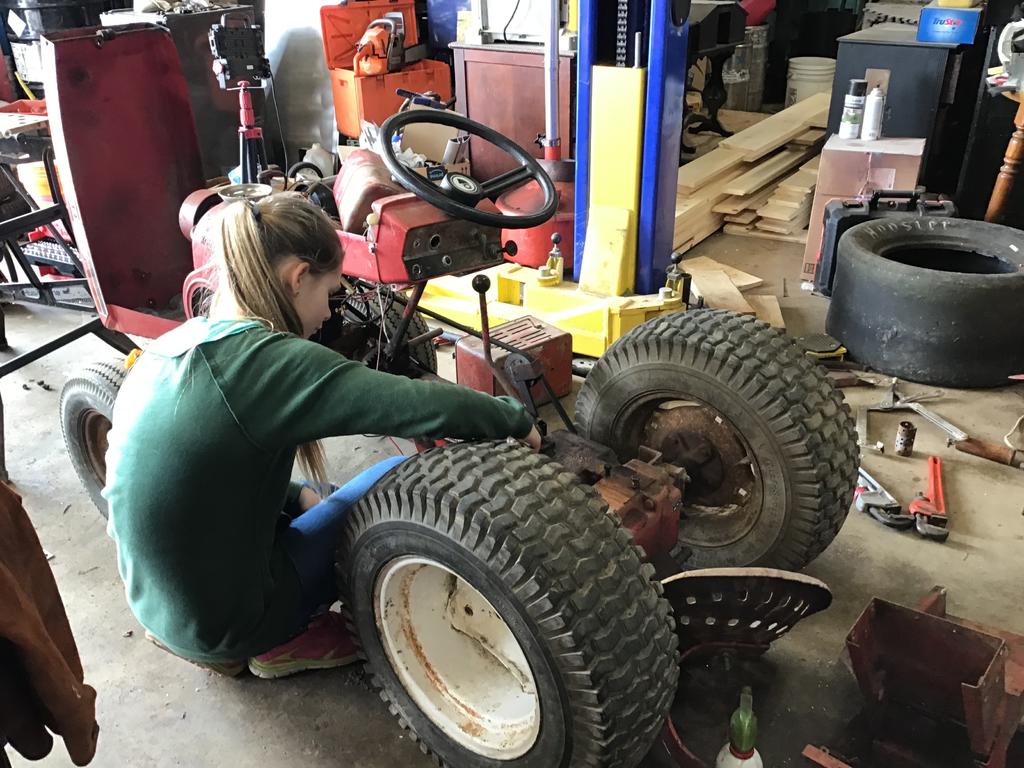

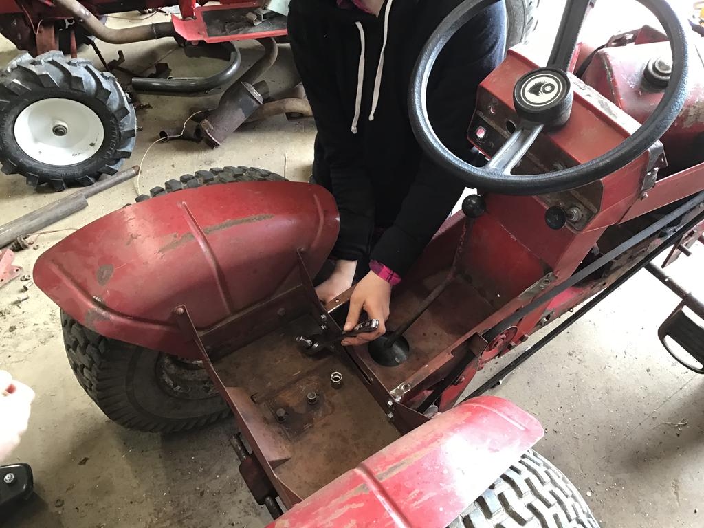

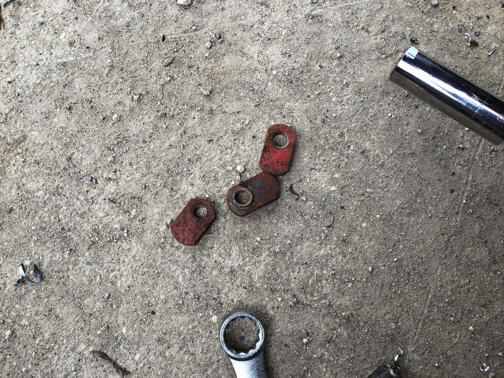

Pullstart 70,819 #57 Posted April 7, 2020 Jada’s prepping and cleaning the frame and I need to weld the tins together! 2 2 2 Share this post Link to post Share on other sites

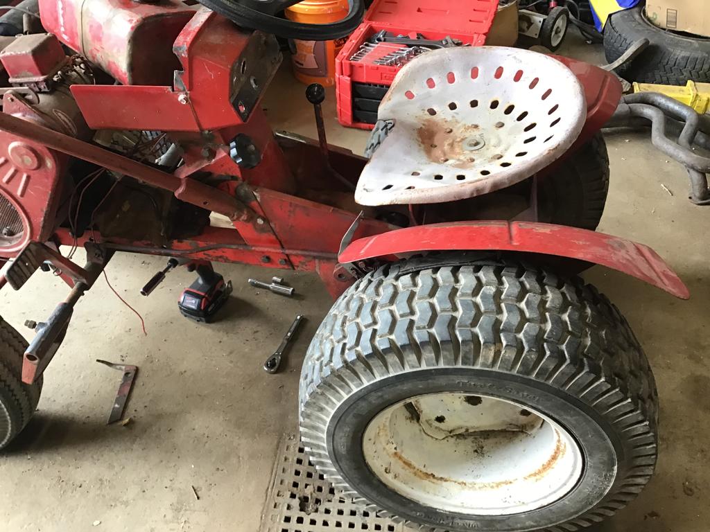

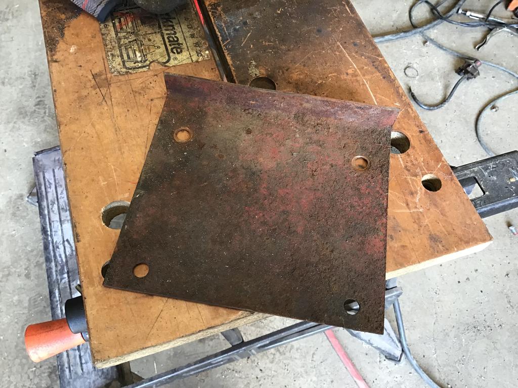

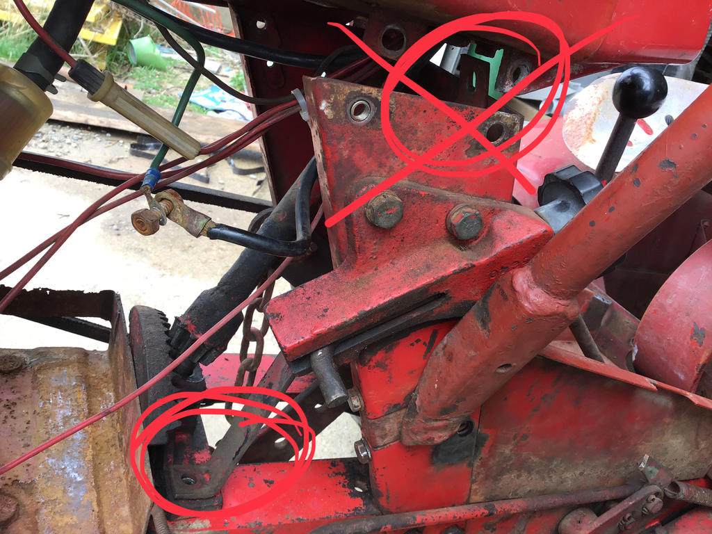

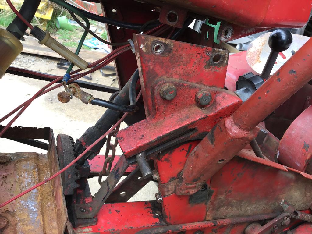

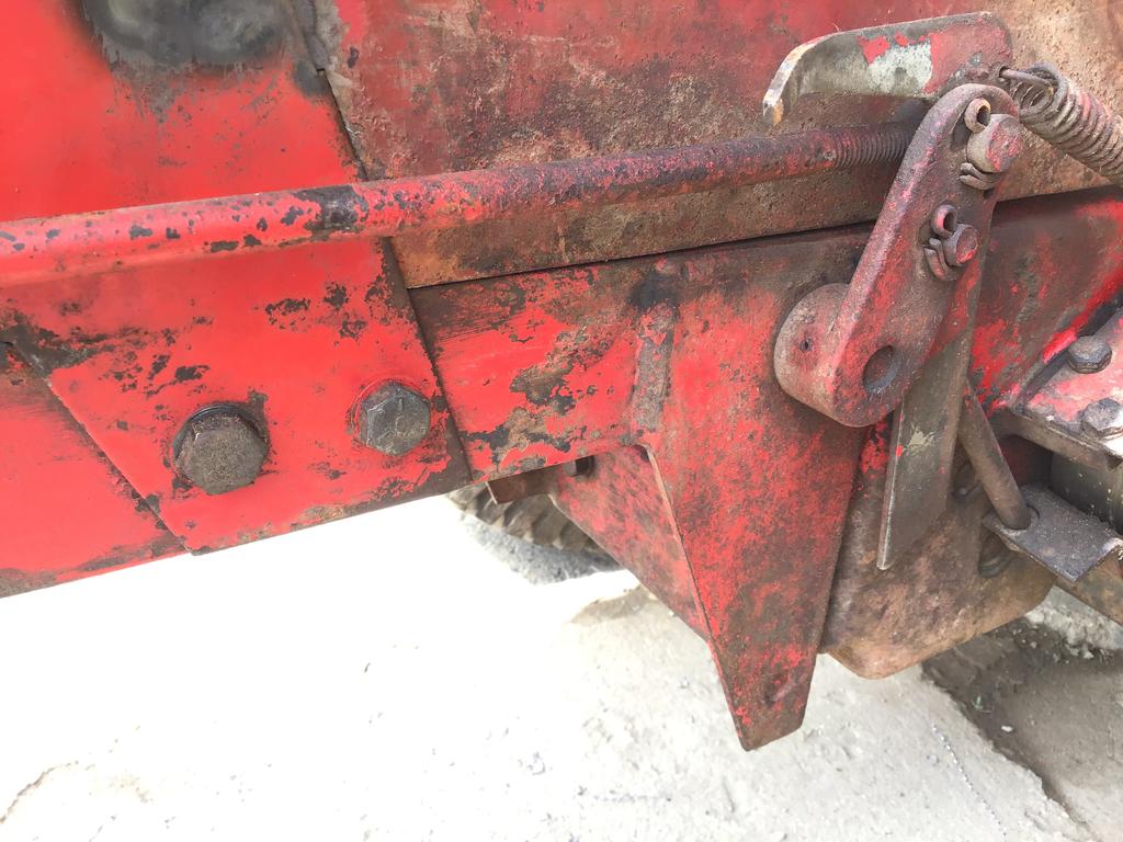

Pullstart 70,819 #58 Posted April 8, 2020 The tins all got welded yesterday afternoon, before the storms came rolling through. Not too much more than a crazy light show and some good booms. They were predicting golf ball sized hail for us and up to 2-1/2” diameter stones about 40-50 miles north. The round hoods have a pair of 1” strapping braces from the steering block to the tower just under the fuel tank. We did a dry assembly of the tower with the lift handle and will see if the braces from the 552 will work. The 753 did not have any braces left. I bet they’re around somewhere! I’ll likely add another 3/8” bolt to either side of the tower on the frame as well. There isn’t really any good hold down behind the shifter box, most likely the reason the rear strapping brakes so often! I also noticed a good deal of rubbing from a seat spring on that rear brace, so we’ll clearance a 1/4” or so from that area to create a bit more wiggle room. 4 Share this post Link to post Share on other sites

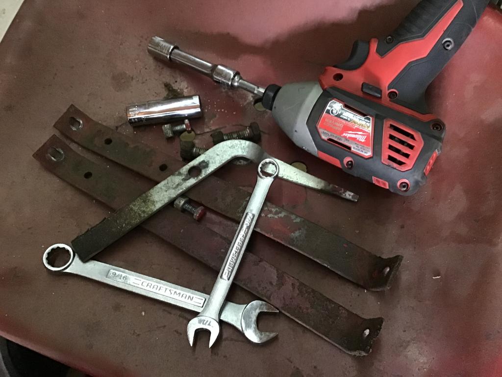

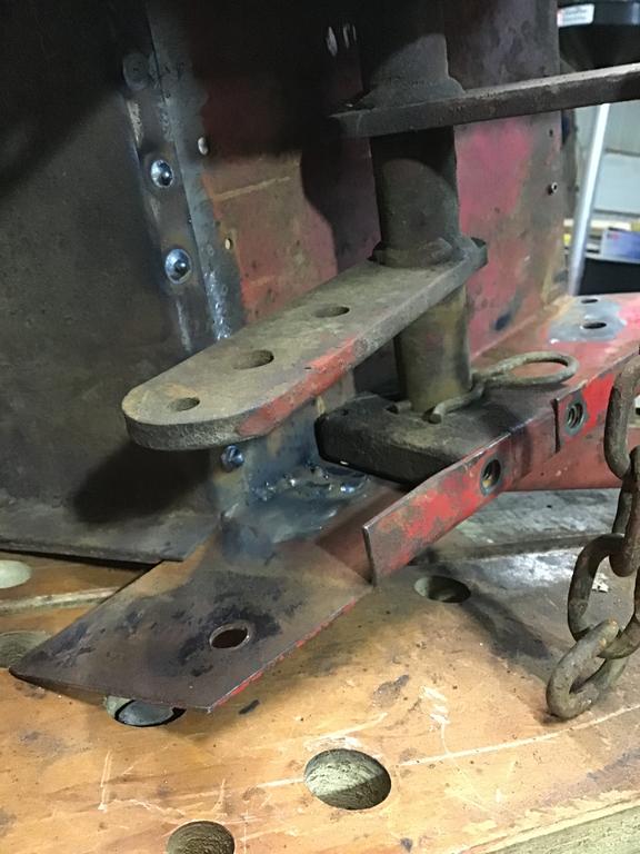

Pullstart 70,819 #59 Posted April 8, 2020 These are the uprights we’ll use if possible. 2 Share this post Link to post Share on other sites

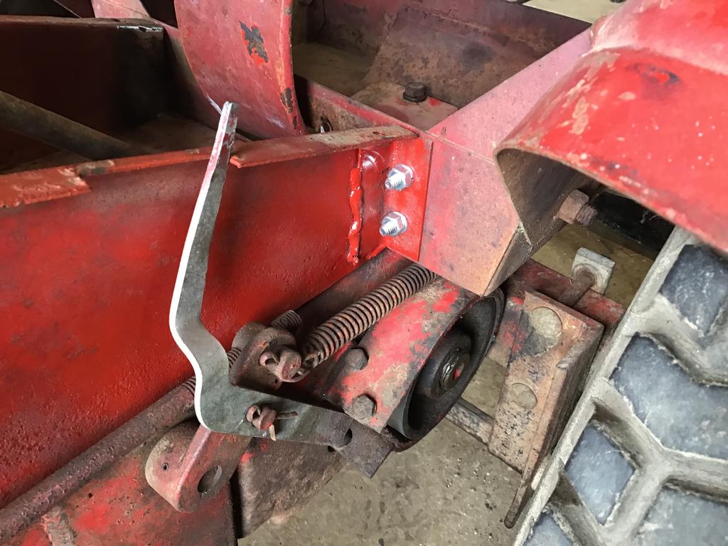

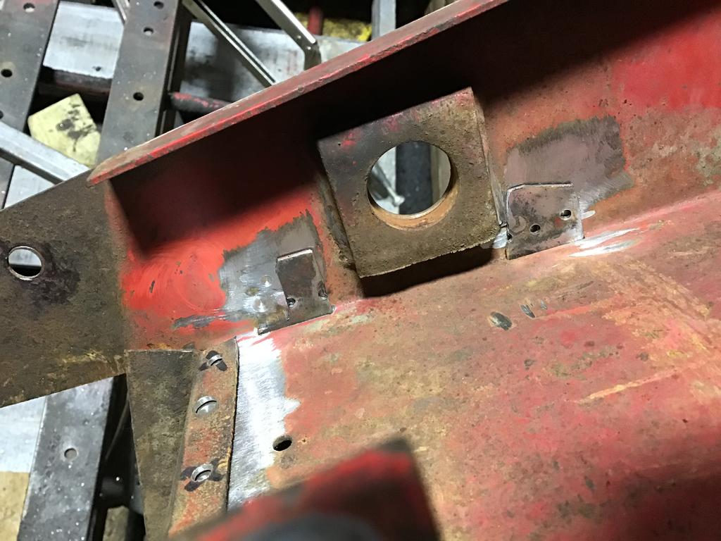

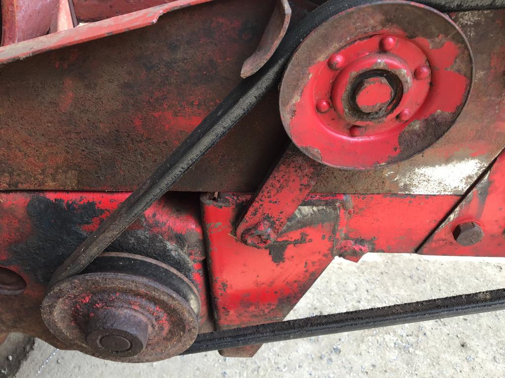

Pullstart 70,819 #60 Posted April 8, 2020 (edited) Upright supports and parking brake lever borrowed from the 552 “Poppy” Edited April 8, 2020 by pullstart Picture 3 Share this post Link to post Share on other sites
Pullstart 70,819 #62 Posted April 8, 2020 Extra tower holes are drilled. I think I’ll end up doing this to all round hoods from now on. 1 1 Share this post Link to post Share on other sites

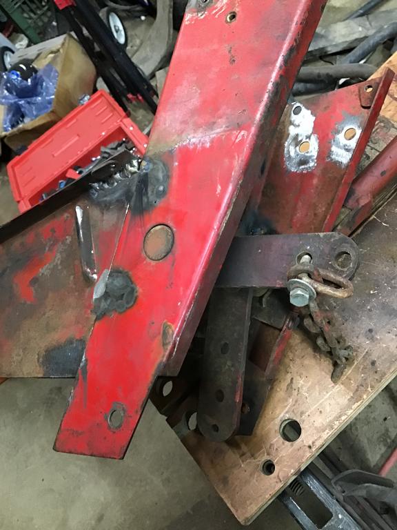

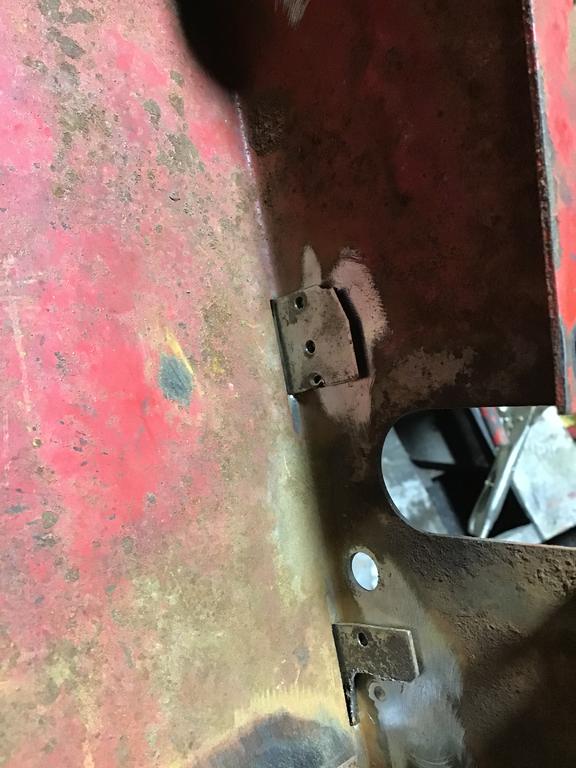

Pullstart 70,819 #63 Posted April 8, 2020 There are a few tabs that need spot welding back on... Share this post Link to post Share on other sites
Pullstart 70,819 #64 Posted April 8, 2020 The uprights will not fit, the 857 tower is shorter than that of a 552. We’ll have to build some. Oh bummer we need to build something!?!? 1 Share this post Link to post Share on other sites

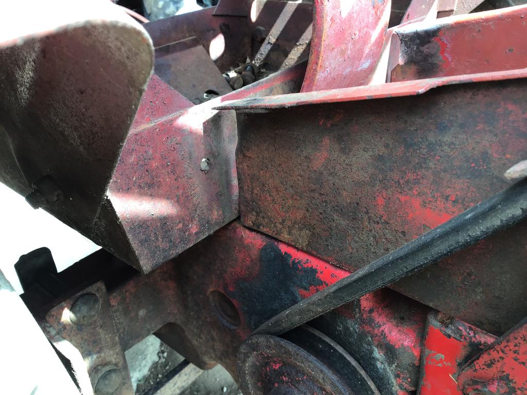

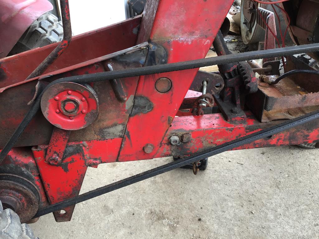

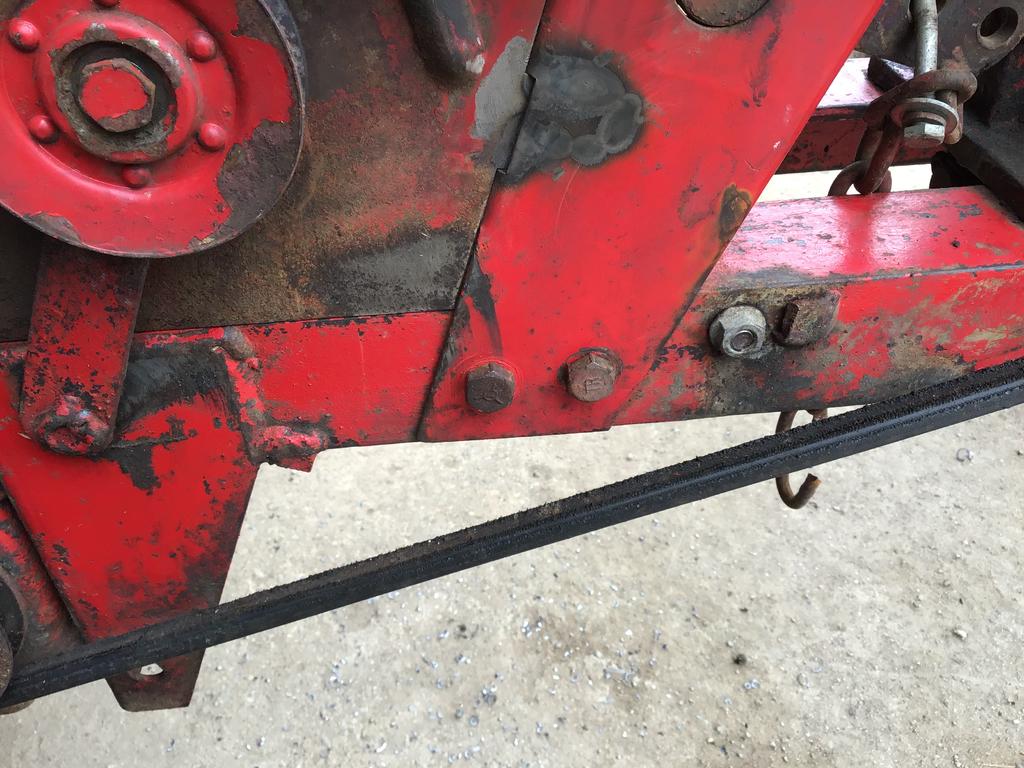

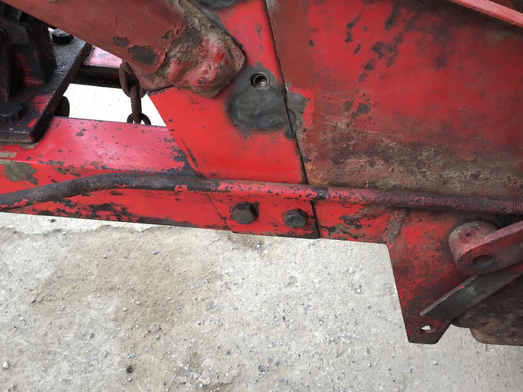

Achto 32,127 #65 Posted April 8, 2020 2 hours ago, pullstart said: There isn’t really any good hold down behind the shifter box, most likely the reason the rear strapping brakes so often! When I built Radpferd I eliminated the strap across the back & welded tabs on the outside of the tower, these tabs were then bolted to the tool box under the seat. Belt guard and brake shield will cover every thing up when you are finished. Share this post Link to post Share on other sites
Pullstart 70,819 #66 Posted April 8, 2020 2 minutes ago, Achto said: When I built Radpferd I eliminated the strap across the back & welded tabs on the outside of the tower, these tabs were then bolted to the tool box under the seat. Belt guard and brake shield will cover every thing up when you are finished. Do you happen to have pictures of that? I don’t follow exactly. Share this post Link to post Share on other sites
Achto 32,127 #67 Posted April 8, 2020 2 minutes ago, pullstart said: Do you happen to have pictures of that? I don’t follow exactly Not on me, I'll pull the brake shield off & get you a pic of that side tonight. 1 Share this post Link to post Share on other sites
Pullstart 70,819 #68 Posted April 8, 2020 52 minutes ago, Achto said: Not on me, I'll pull the brake shield off & get you a pic of that side tonight. Like an piece on angle iron on that inside corner? I was also considering some strapping dropping down onto the frame as far back as possible? Share this post Link to post Share on other sites
Achto 32,127 #69 Posted April 8, 2020 6 minutes ago, pullstart said: Like an piece on angle iron on that inside corner? Exactly !!! Did that on both sides Instead of using the single strap in the middle. I welded to the tower and used two bolts on each side to connect to the tool box. I also added the extra bolt on each side to the front mount of the tower like you did. Once everything was bolted down the whole assembly felt good & sturdy. 1 Share this post Link to post Share on other sites
Pullstart 70,819 #70 Posted April 8, 2020 1 minute ago, Achto said: Exactly !!! Did that on both sides Instead of using the single strap in the middle. I welded to the tower and used two bolts on each side to connect to the tool box. I also added the extra bolt on each side to the front mount of the tower like you did. Once everything was bolted down the whole assembly felt good & sturdy. Before checking back in with ya, I discussed options with Jada. We agreed that angle iron would be the best option. We also agreed that these tractors have been beat much harder by much heavier operators than her, for many years... so any improvements we do are likely to outlast us! 1 3 Share this post Link to post Share on other sites
