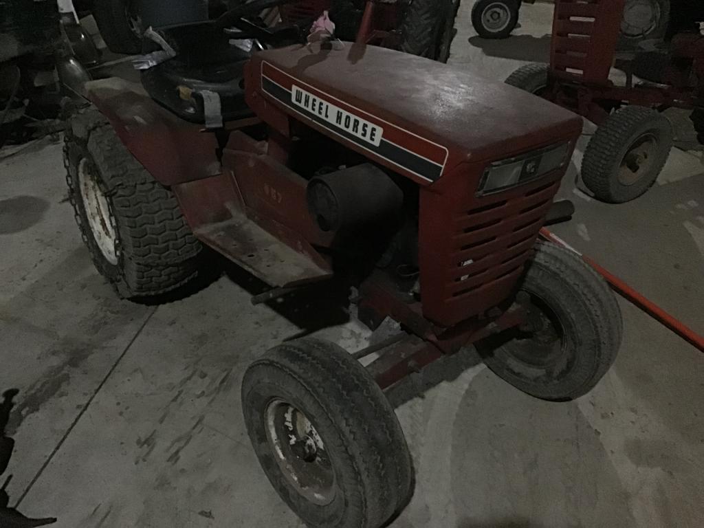

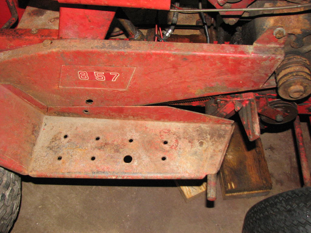

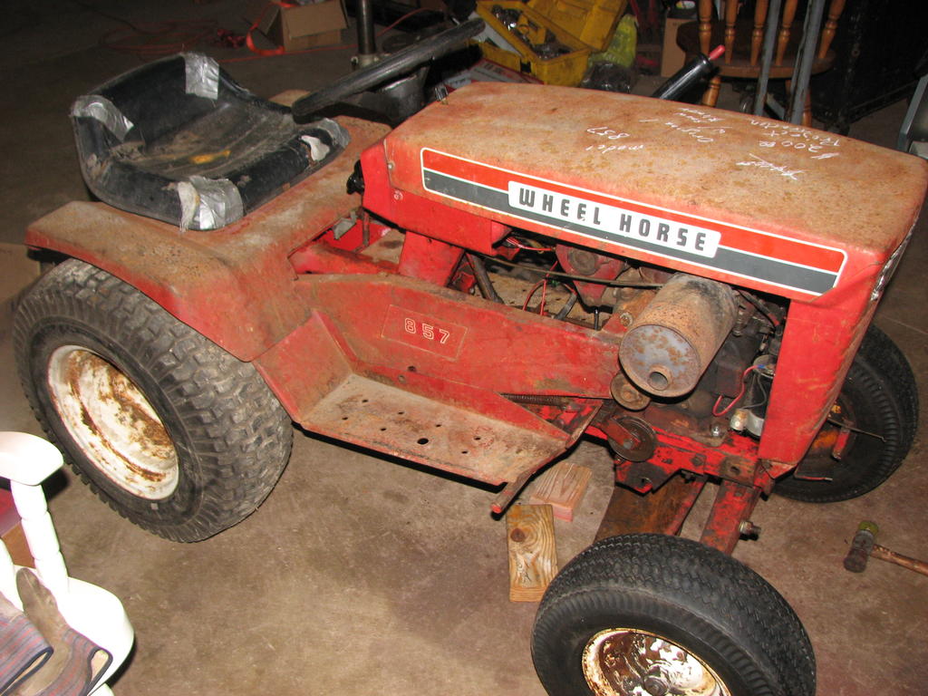

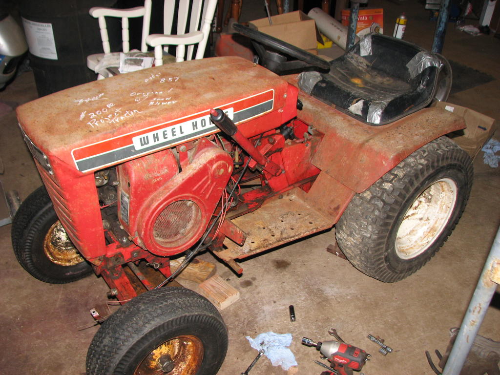

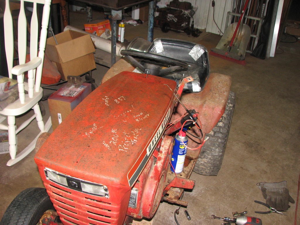

Pullstart 70,105 #1 Posted June 27, 2018 Got the 857 assembled this morning, the choke cable is frozen and is getting a WD40 treatment and I need to sort the wiring out... I should have taken pics of what wiring went where when I was pulling it apart, but I was in a hurry to get it in the truck! I'm undecided weather I should trim the floor board to fit the PTO controls, or just remove them. Most likely there won't be any mowing or tilling with it, just pulling stuff with the hitch. I tried some WD40 and 180 grit on the hood to see if it would clean up and it seemed to work pretty good! I cleaned up the mess with SD-20 degreaser and some blue rags. The fuel pump is missing the fittings and lines so I'll have to IV-drip some fuel into the carb when it's time to test start it... then I'll see what I can wrangle up to get the pump working like it should. 8 2 Share this post Link to post Share on other sites
Achto 31,904 #2 Posted June 27, 2018 49 minutes ago, pullstart said: I'm undecided weather I should trim the floor board to fit the PTO controls, or just remove them. I was confused by this statement until I looked at the pic's. I would ditch the boards, they don't belong on an 857 any way. Go for a set of stirrups instead. 1 Share this post Link to post Share on other sites
Pullstart 70,105 #3 Posted June 27, 2018 I agree, but I'm thinking of the kids... Jada running around on Putt Putt yesterday finally switched off because the stirrups are just out of reach. With that said, she won't be doing a ton of mowing or tilling 3 Share this post Link to post Share on other sites

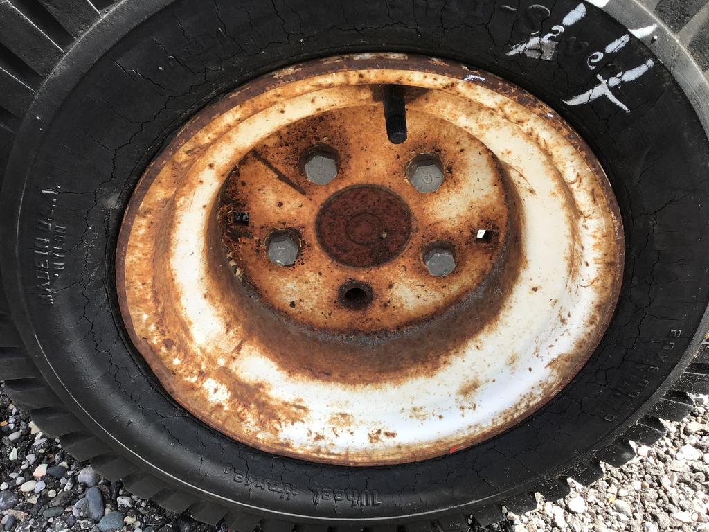

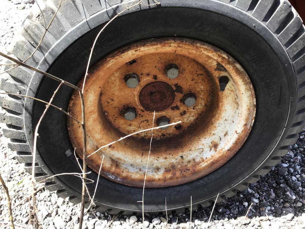

Pullstart 70,105 #19 Posted August 30, 2018 Picked up a parts tractor for Screamin’ Jimmy today. It’s seen better days, but has a couple good pieces left. The trans shifts into all gears with ease, the top of the hood will be donated to the 1267 grille that I picked up at the show, it’s has pretty nice tie rods, etc. 5 bolt hubs, if I can ever get them off... there’s some good rust evidence on the axles. 3 Share this post Link to post Share on other sites
ebinmaine 79,162 #20 Posted August 30, 2018 2 hours ago, pullstart said: 5 bolt hubs, if I can ever get them off... there’s some good rust evidence on the axles. Do you use an old hub for a puller? Share this post Link to post Share on other sites
Pullstart 70,105 #21 Posted August 30, 2018 I’ve never needed to. I did however have one hub / trans that made it into the arbor press once! Pumping a handle and letting pressure do it’s thing is a godsend, I believe. 2 1 Share this post Link to post Share on other sites
