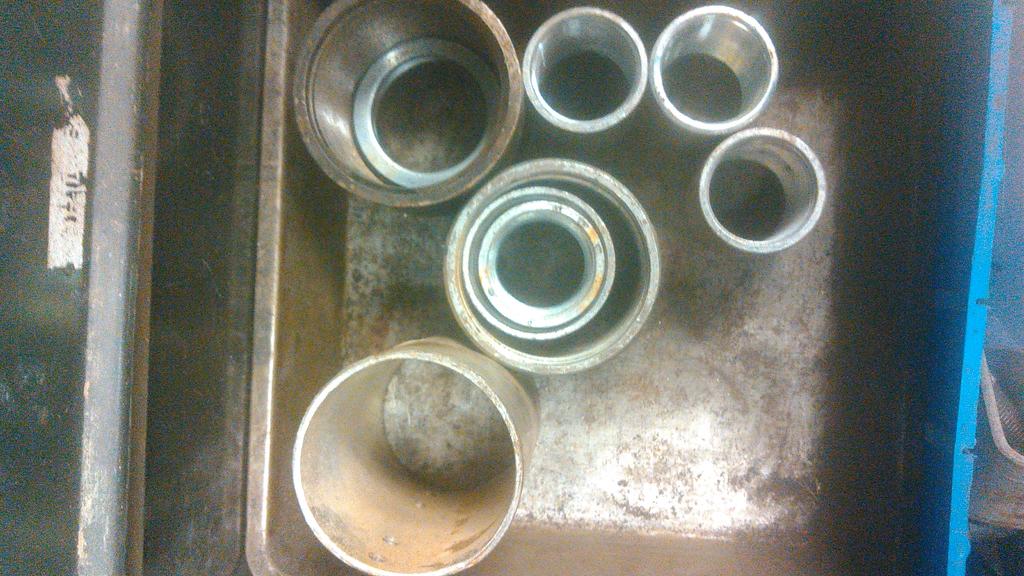

What "tool" or "item" do you use to drive the wheel bearing into the case?
I need to put a couple of wheel bearings in my honey's transmission and then put it back together.
I tried to drive 1 in by tapping in with a socket but obviously it was not quite big enough and damaged the outer ring.
What do you folks use to drive those bearings in?

KIMG1434.jpg.7af2420bd37f9d6c701f389507ae1628.jpgI have an assortment of sch 40  pipe and couplings. I find the closest fit and use that.
SPINJIM
I took a trip to a plumbing supply store.  Take the bearing along, and find a piece of PVC pipe or a fitting to match the outer diameter of the bearing.   I've rebuilt three transmissions using those pieces of joint fittings.   Good luck.
     Jim

I guess I don't have one big enough though....
     Jim
Found a piece of wooden closet pole that worked perfectly.
