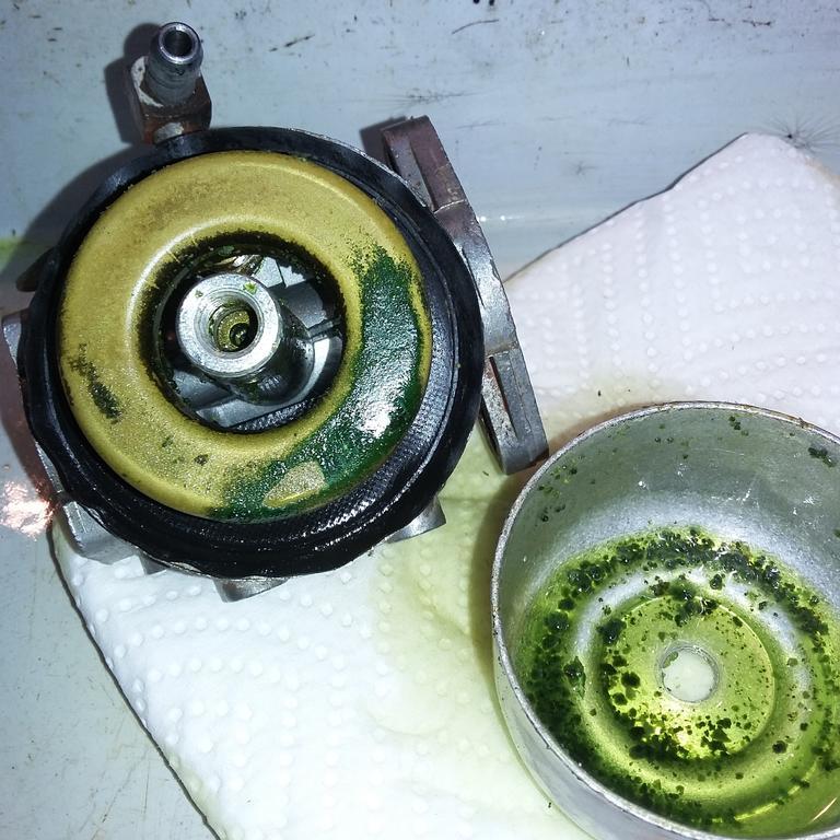

BOB ELLISON 2,983 #25 Posted July 2, 2018 Well I know first hand that ethanol is not good for these small engines. After sitting for 3 or 4 months my Lawn ranger would not start so I pulled the carb off and this is what I found. I now buy non ethanol gas for all my small engines. I still use seafoam and MMO as well. 1 Share this post Link to post Share on other sites
