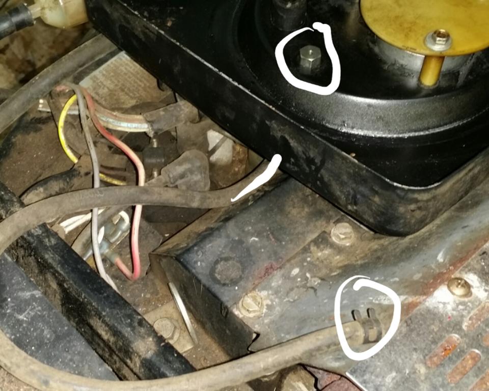

Goat 2141
Were doses this hose go
cleat
There is a small square plastic vacuum switch located on the left dash tower beside the battery.
It connects to that but likely the nipple is broken off.
All it does is supposedly turn on the air filter light on the indicator panel if the filter is restricted.
None of mine are hooked up as I routinely check the air filters.
lynnmor
Those vacuum switches break easily.  If you have a good one, use a lighter, more flexible hose and support it in a way that it won’t hang on the nipple.  If you have a switch that the nipple broke off, sand it flat and make a plate with a nipple that seals against the sanded surface.  Another option is to get a second mortgage on the house and buy a new switch.
