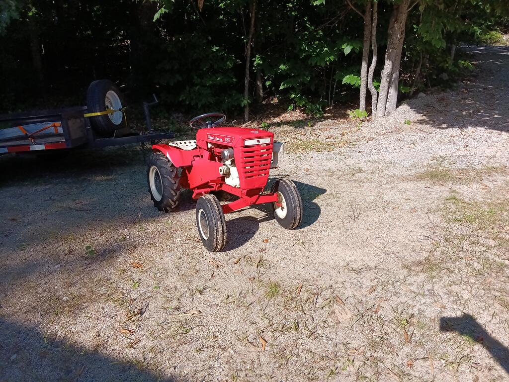

I am officially declaring this rebuild:
 DONE !!!
:woohoo:
At least... To the point of full functionality.

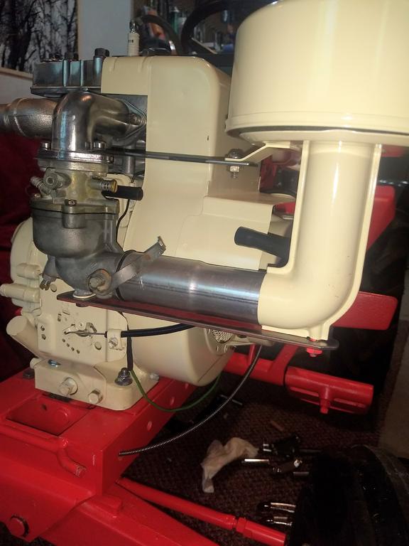

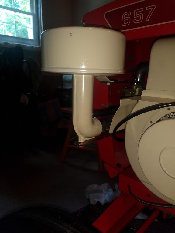

Today I did the fabrication on the air cleaner and also made up a couple lower hood hinge adapter plates. We needed the plates because the hood was about 3/4" too far back... Bent, wrong, who knows?
Here's a few pics.

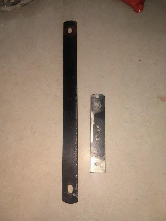

On the left is a piece of scrap I started with for both projects.
On the right is the top brace seen in the following pics.
In this pic you see the above brace, a lower one I made from an old tool box lock bar, and the extension pipe between the carb and air cleaner.
That pipe is a piece of 1-1/2" id to od exhaust adapter cut to 5" length.

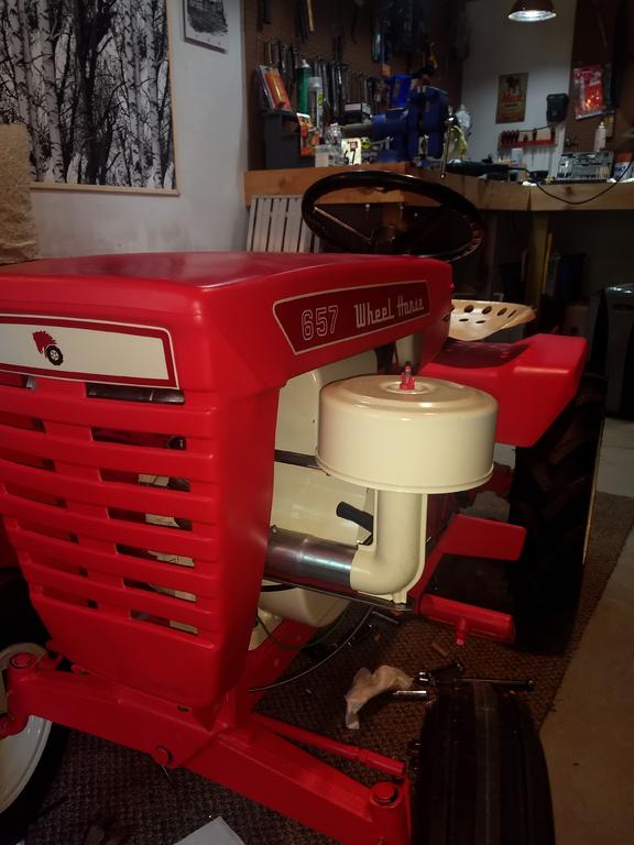

How it sets with hood closed.

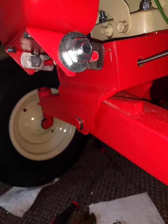

And here's a shot of the lower hood hinge adapters.
I cut the ends of the piece of scrap and drilled out the elongated holes to a round 1/2". Then drilled the holes for the other end with the existing tractor hinge pins to 3/8". Also drilled the hood holes from .46/.48 oblong to round .5 inches.
After a fair pile of grinding and fitting they went in... Nice and snug.
End result is it moved the hood forward 3/4" and up 1/2" for better engine clearance.

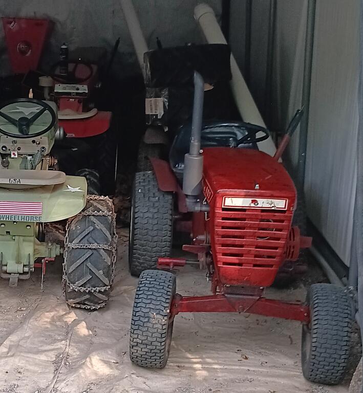

I put up a 14x18 shed about 2 years ago, and I'm already starting to double park them :wacko: Depending on which tractor I want to use I may have to move another one out of the way :text-lol:
