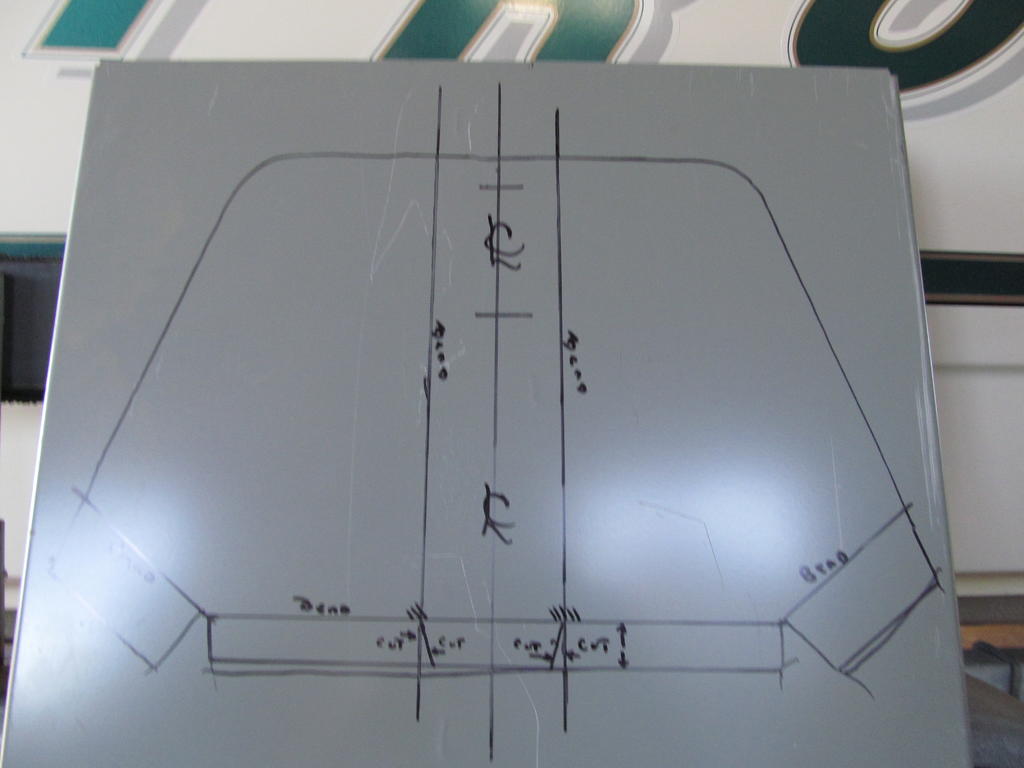

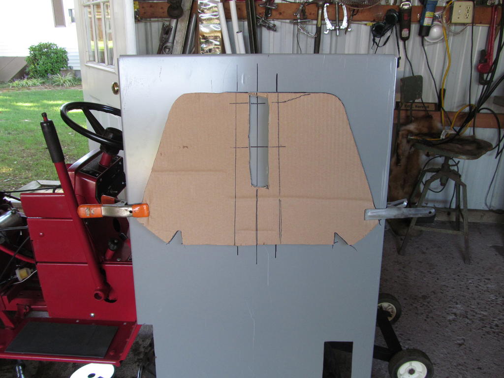

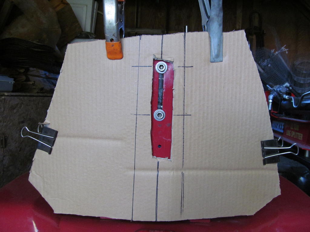

Ed Kennell 43,049 #4 Posted June 7, 2018 I buy large electrical cabinets at the scrap yards. I used these steel panels to make several two piece seat pans. Making a pattern from an existing seat. Then lay out the seat on the steel cabinet door. 5 5 Share this post Link to post Share on other sites
