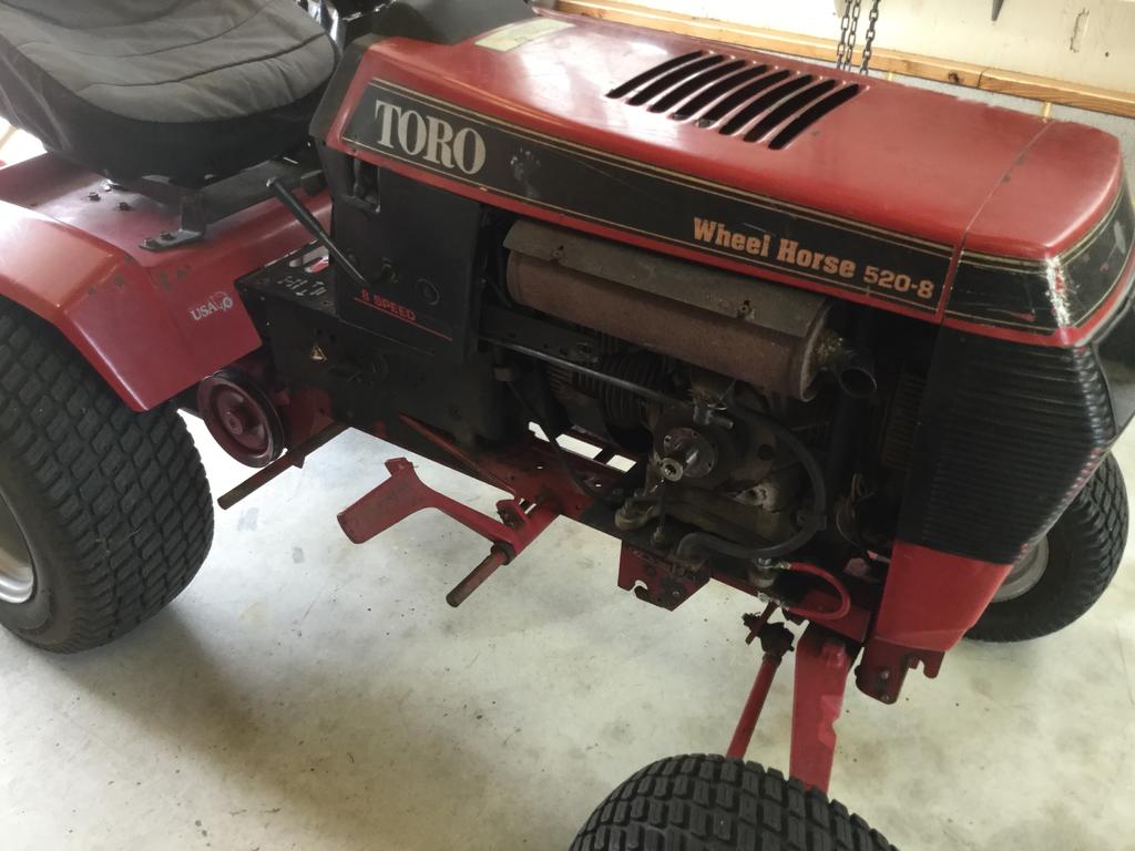

richmondred01 2,393 #1 Posted June 6, 2018 Ive decided to do a little competition. 520-8 vs 418-8. to level the playing field I’ll put an electric lift in the 520. While I’m at it I’ll go through the onan and get it up to spec. Which will go and which will stay? 2 Share this post Link to post Share on other sites

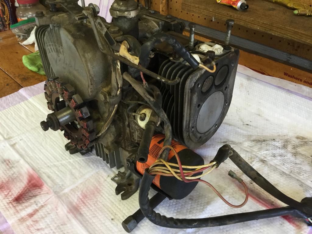

richmondred01 2,393 #13 Posted June 7, 2018 The engine is in remarkable condition. Cylinders within spec. Will put a set of rings in just because it’s down this far and a valve job. 4 1 Share this post Link to post Share on other sites

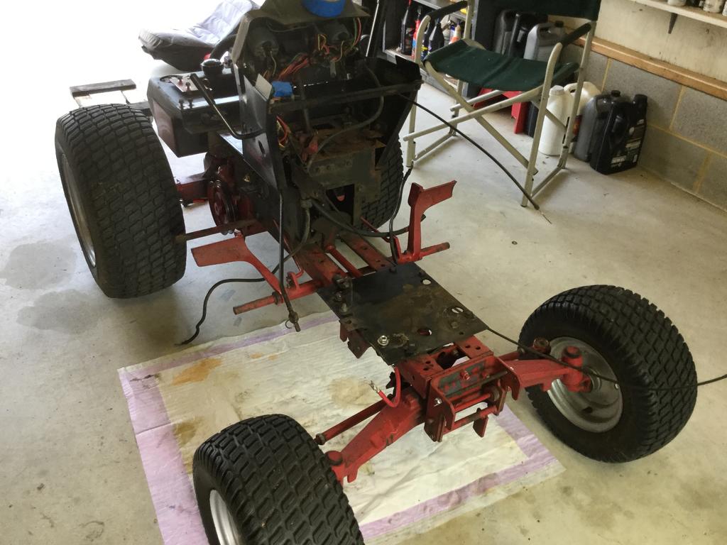

richmondred01 2,393 #14 Posted June 9, 2018 I got bored today while waiting for my onan rings, decarb gasket set and carb rebuild. I guess I’ll clean it up, put the electric lift and do some other required repairs. It’s in remarkable shape. It’s always better to start off at the bottom and work up. 4 1 Share this post Link to post Share on other sites

cleat 9,405 #16 Posted June 10, 2018 That looks like my 520HC setup. Swept axle with standard steering. Works great for mowing grass. Looking good. 1 Share this post Link to post Share on other sites
richmondred01 2,393 #17 Posted June 10, 2018 Unfortunately I’ve sold all my gear reduction steering. I’ll use this for now with the standard steering. 1 Share this post Link to post Share on other sites
cleat 9,405 #18 Posted June 10, 2018 If you get the thrust bearings between the spindles and axle cleaned and lubed well along with everything else it will steer just fine. My 520HC that has the identical steering to yours steers quite easy, not as easy as the reduction, but I can still palm steer it while mowing. Now, if you hang the 2 stage blower on the front that is a different story. Share this post Link to post Share on other sites

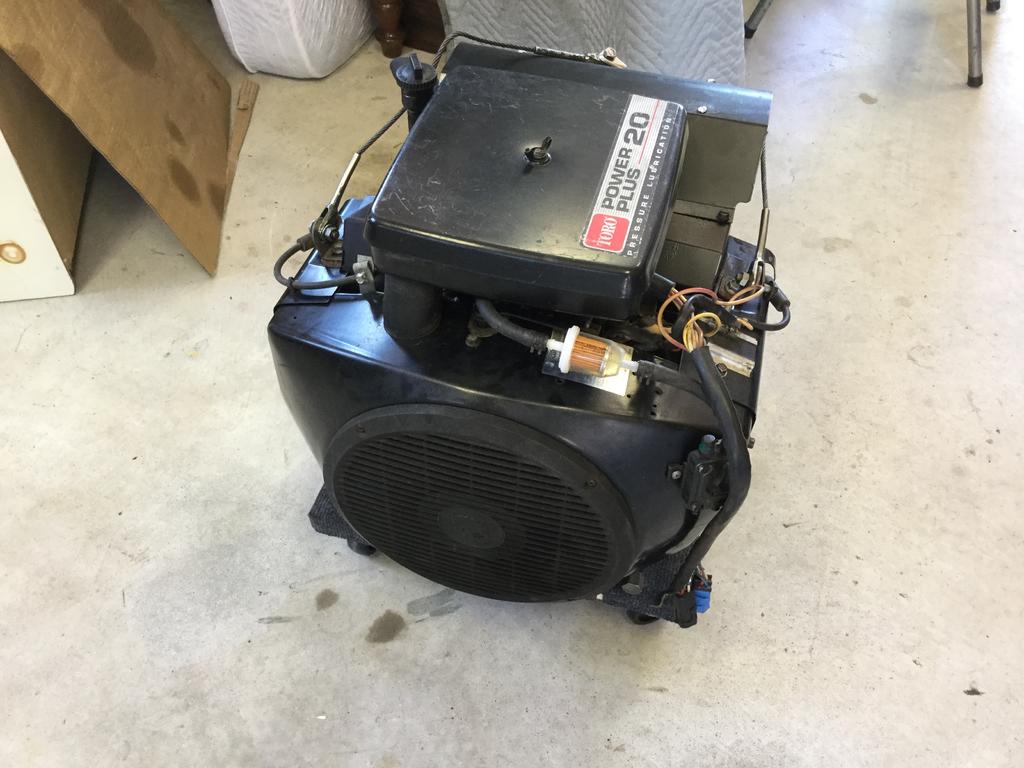

richmondred01 2,393 #19 Posted June 16, 2018 Engine done. 2 2 Share this post Link to post Share on other sites

richmondred01 2,393 #21 Posted July 9, 2018 What the heck. It’s a 520-8. May as well give her a fresh coat of base coat clear coat paint. I’ll be picking up another one (non runner) with rod and valve issues this week. 2 Share this post Link to post Share on other sites

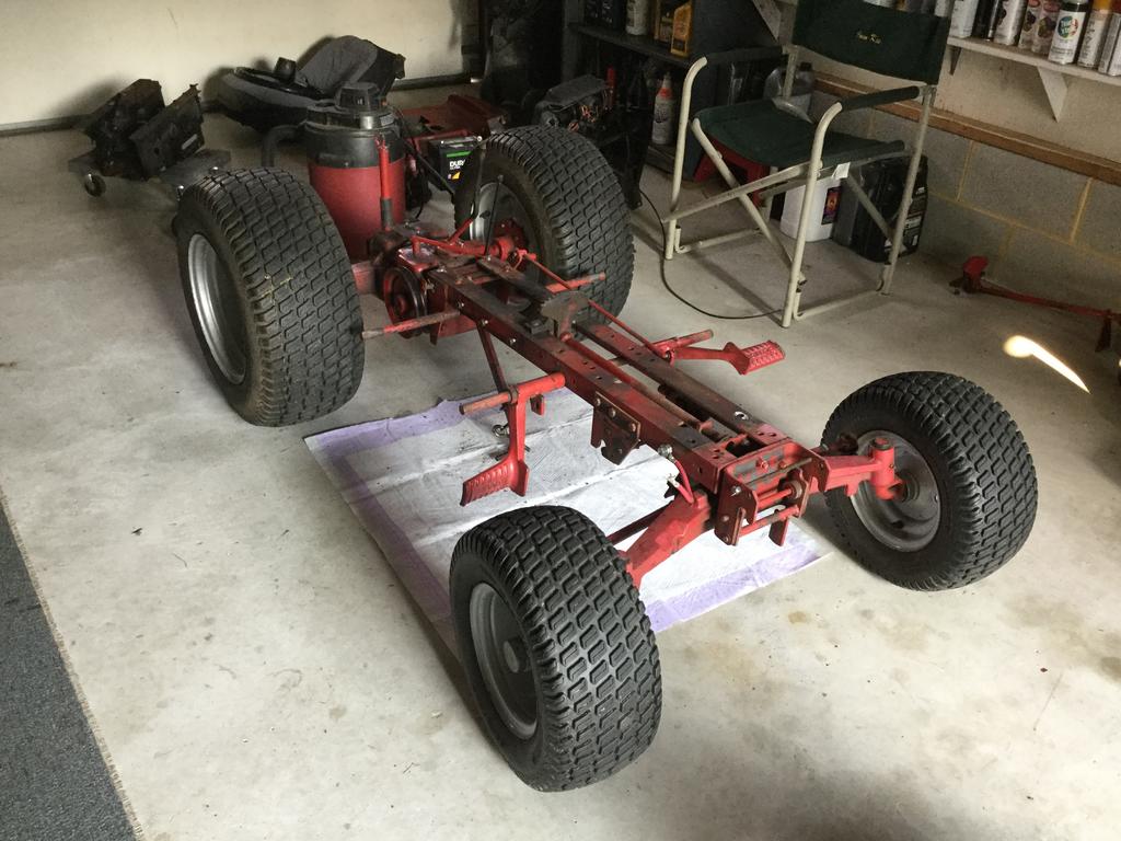

oneroadkingman 53 #22 Posted July 16, 2018 How bad is it to change the steering gear mine's wore out Scott a lot of play in it but it does have the front swept axle under it I'm not sure if I even has the gear reduction steering or not it's all new to me 1 Share this post Link to post Share on other sites
richmondred01 2,393 #23 Posted July 17, 2018 It’s not that bad. Mine was very easy because I have it taken down to the frame. The column is nos, lower steering arm is new, front bearing is new and Cleat rebuilt the steering block. I’ll post some photos when get to that point. 1 1 Share this post Link to post Share on other sites

richmondred01 2,393 #25 Posted July 25, 2018 NOS and rebuilt steering parts. 1 Share this post Link to post Share on other sites
