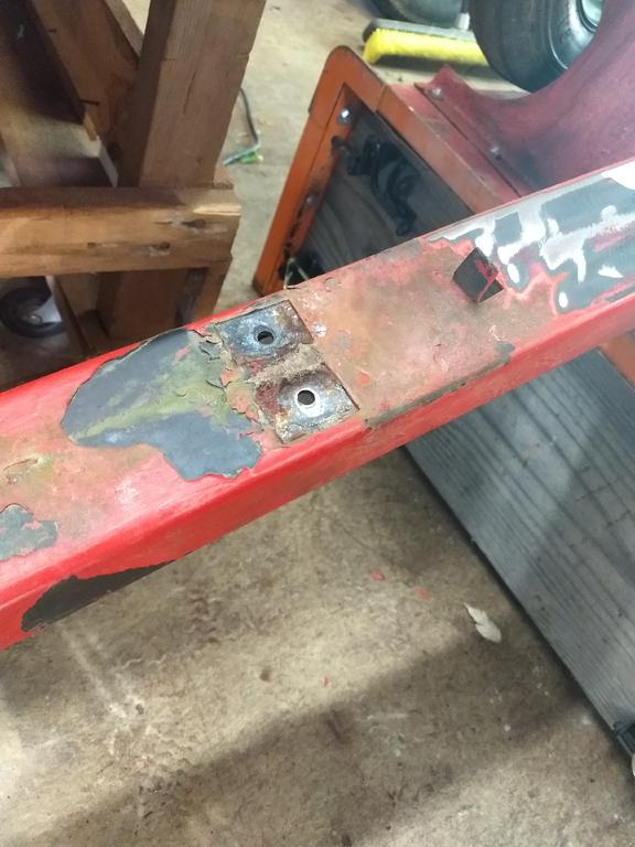

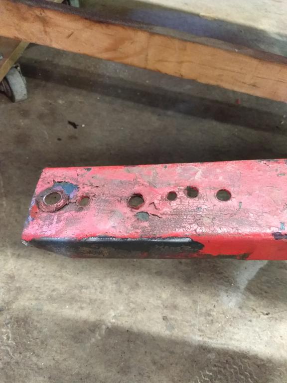

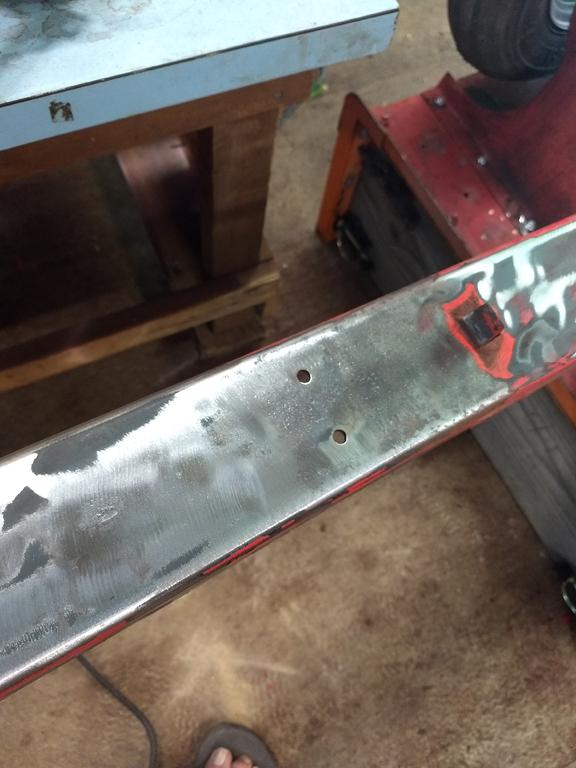

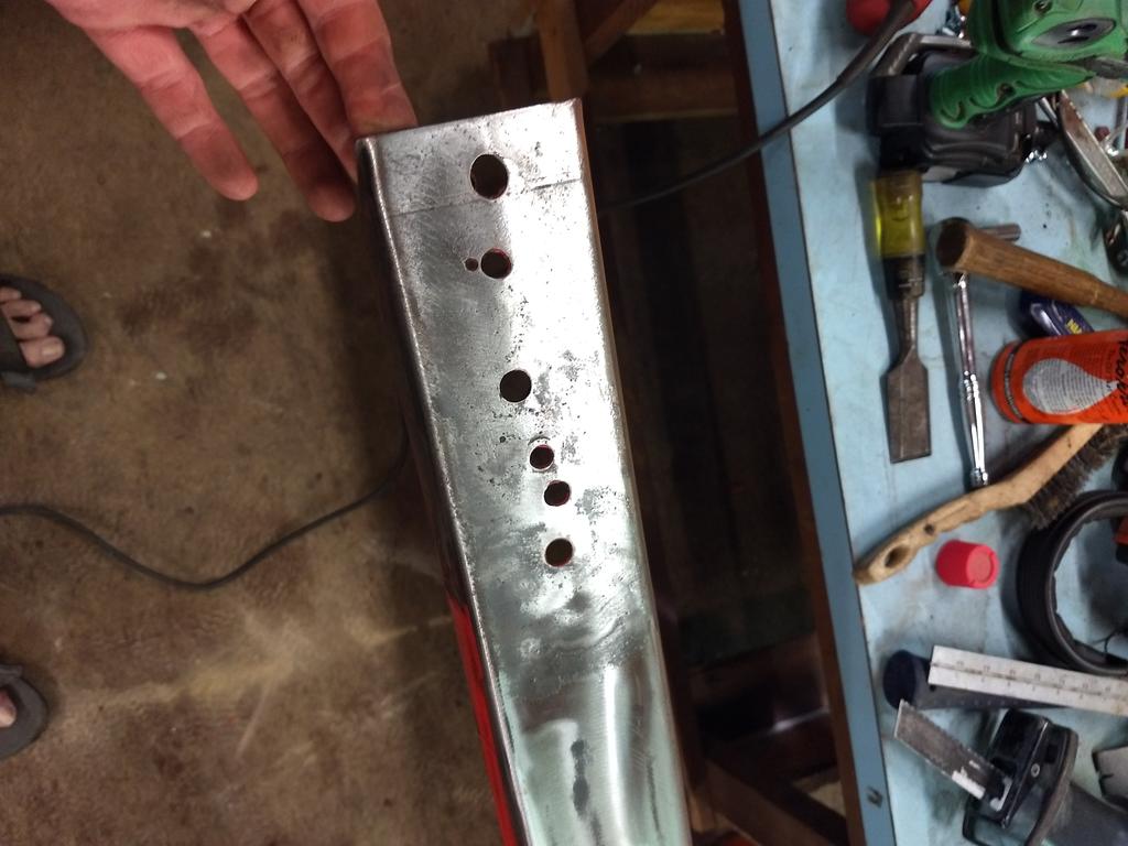

Trying these out this evening on the tongue of the trailer that I'm rebuilding and modifying.
I'm extremely impressed!!
These disks FAR exceed the capabilities of a good quality wire brush on an angle grinder.
The wear quality seems to be very good.
The pictures below are taken only a few minutes apart.
If you've never tried these the one thing I can tell you is that they will remove metal!
What I mean is, a wire brush does not seem to remove any metal. If there is a small flange like a worn edge or a little lip or anything, these discs will remove it.
That's great if you want to flatten out the metal because it is actually worn and your trying to fix it. Not so awesome if you're trying to keep something Sharp.
