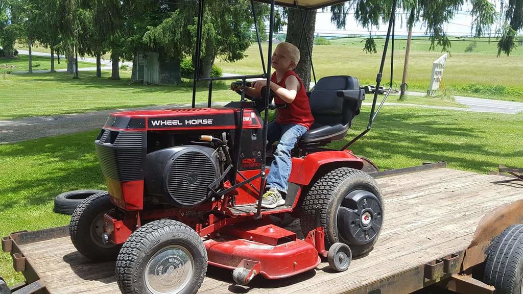

QuickTrigger 16 #11 Posted June 1, 2018 Here is a Picture . Thanks for the info Tractor Boy, The Regular gas is near $4.00 a gallon now that all gas has gone up but it was around $3.50 for a year or so.. . The little guy on the seat was a random child at the auction.. He spent a couple hours setting in the seat. His parents said they should have purchased it to keep their son occupied.. :-).. It has the rain/Sun cover installed but the plastic doors and window piece is still new in the box. I went to the auction to bid on a .22 Winchester and ended up with a Tractor , That's how life goes. 4 1 Share this post Link to post Share on other sites

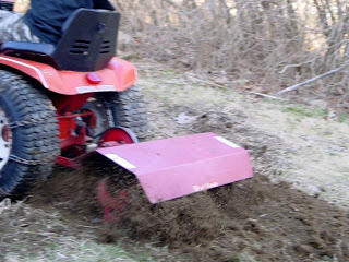

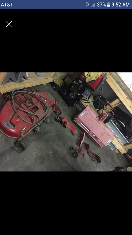

QuickTrigger 16 #17 Posted June 11, 2018 Hey Everyone, Can anyone tell me if this Tiller attachment will work on my 95 520-H? The tiller originally worked on a 312-8. The guy who wants to sell it cannot provide me with the Part # Thanks in advance for your time.. Share this post Link to post Share on other sites

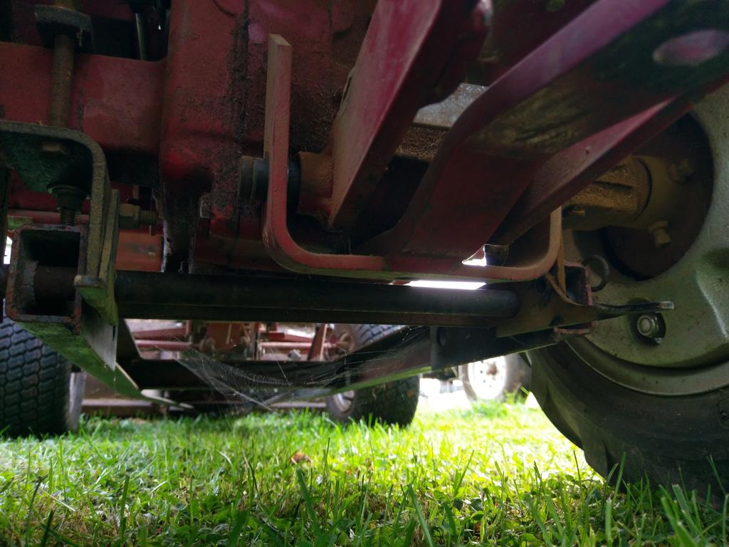

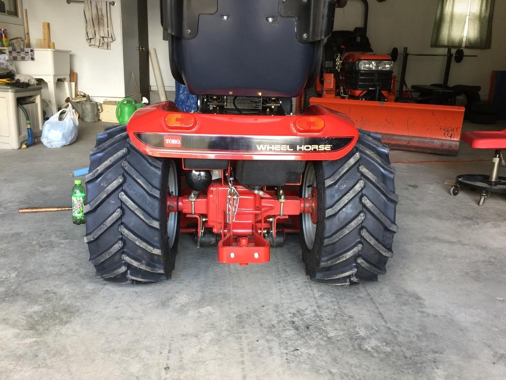

cleat 9,311 #18 Posted June 11, 2018 It will work fine. You will need the rear attachment point on your rear axle and the rear rockshaft and cable assembly for the lift. 1 Share this post Link to post Share on other sites
WVHillbilly520H 10,379 #19 Posted June 11, 2018 Here's what @cleat is referring to...the chain and rockshaft are what lifts the tiller the rear axle bracket is what the snow/dozer blade and tiller actually hook in to, also with the snow plow you'll need the frame extension kit as well, Jeff. 1 Share this post Link to post Share on other sites
