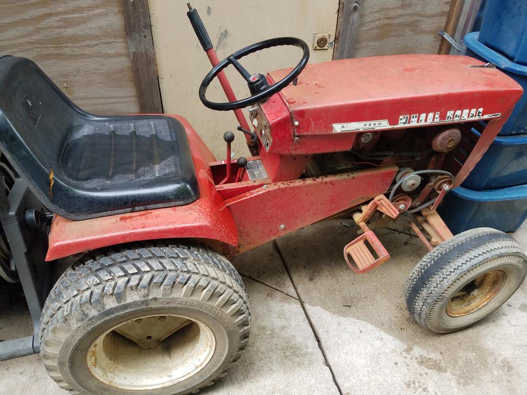

If it runs with starter fluid but dies in a few seconds, make sure that you have fuel pumping into the bowl. A carb cleaning may help. But if it doesn't, you may have a fuel pump problem. Also, be sure to use fresh fuel.

That is one nice horse you have there.  The 867 is the 1st short frame to have a transmission with the hi/low in it.  Yours has a #5060 which is a 10 pinion limited slip transmission.  It makes your horse a little on the rare side and collectable.  Treat her well and Welcome to Red Square.  :occasion-xmas:
Big guy lil tractor
Wow thanks for the info. I plan on putting her to work again ,I'm sure thats what she wants .

:text-coolphotos:           You have a great :wh: there, should be an easy fix. Your best bet is to replace all of the fuel line and filter as well as rebuilding the carburetor. Also, do not use gas with ethanol! https://www.pure-gas.org/
This manual should be helpful.
Big guy lil tractor
Thats what i was wondering about,  this motor runs leaded gasoline , should use a lead additive ?

No need to put a lead additive in the gas. The unleaded gas is fine just try real hard to stay away from ethanol. Ethanol does bad things to small engines.
