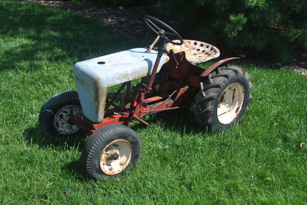

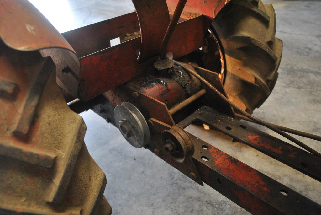

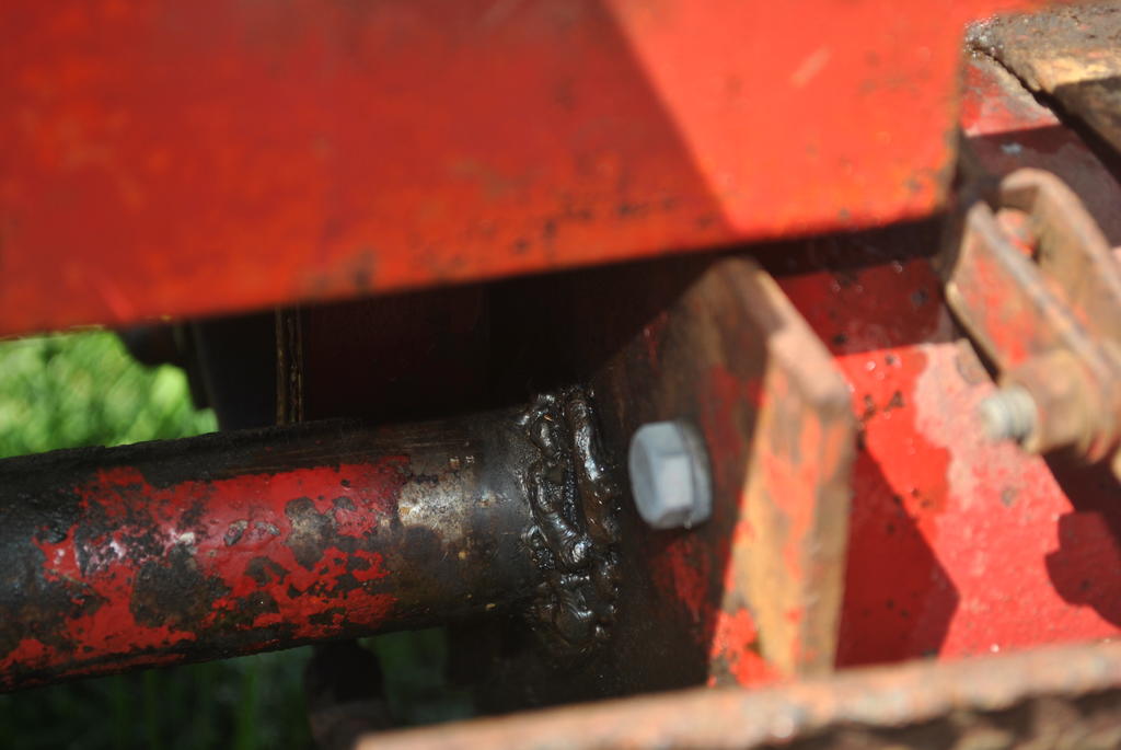

Horse Play 393 #7 Posted May 13, 2018 (edited) Thank you for the advice, guys. So I went to drain the transmission, but someone rounded off the drain and fill plugs with the wrong tool. This tractor is a wreck and the transmission in no exception. It's leaking out of everywhere and there's some kind of terrible patch job on the left axle tube. Edited May 13, 2018 by Horse Play 3 Share this post Link to post Share on other sites
stevasaurus 23,557 #8 Posted May 13, 2018 Thank you for the pictures. Believe it or not, that trans is very savable...even that nice looking welding job. A small pipe wrench will make short work of that plug, and you can get another one at ACE or TSC. I know this is a long thread, but the information in it is invaluable...check it out. Parts are available from some of the members on the site. That horse is worth saving. 1 3 Share this post Link to post Share on other sites

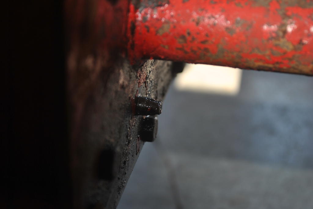

Horse Play 393 #9 Posted May 13, 2018 Awesome thread, Steve - thanks! I'll be referencing that multiple times. I've only had a little time to work on my new project, but I did manage to drain the transmission. Luckily the plugs were not too tight and vice grips worked just fine. I lifted up the left-side tires to angle the tractor as much as possible. I only got about four cups of brown water, probably from when I power washed the tractor yesterday. Share this post Link to post Share on other sites

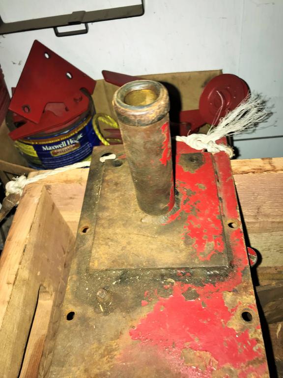

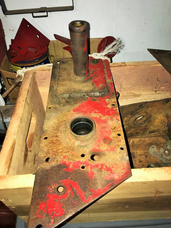

Lane Ranger 11,741 #10 Posted May 14, 2018 You want to see a patch on an RJ transmission Horse Play -this is a patch : and it is good enough to reuse ! 4 Share this post Link to post Share on other sites
Howie 900 #11 Posted May 14, 2018 Someone wanted more support on that axle tube didn't they! 1 Share this post Link to post Share on other sites
Horse Play 393 #12 Posted May 14, 2018 Wow, that's a patch! 1 Share this post Link to post Share on other sites
stevasaurus 23,557 #13 Posted May 14, 2018 @Horse Play take out one of those bottom plate bolts to drain the trans. 1 Share this post Link to post Share on other sites
Horse Play 393 #14 Posted May 16, 2018 On 5/14/2018 at 12:12 PM, stevasaurus said: @Horse Play take out one of those bottom plate bolts to drain the trans. Ah, good idea. I propped up the the tractor to the right , pulled the filler plug to vent, then removed the cover bolt below the drain plug - nothing but clear water poured out. No one in town had 1/8" or 1/4" NPT, so I had to order plugs. How long should I soak the transmission? Should I fill it almost to the top? Share this post Link to post Share on other sites

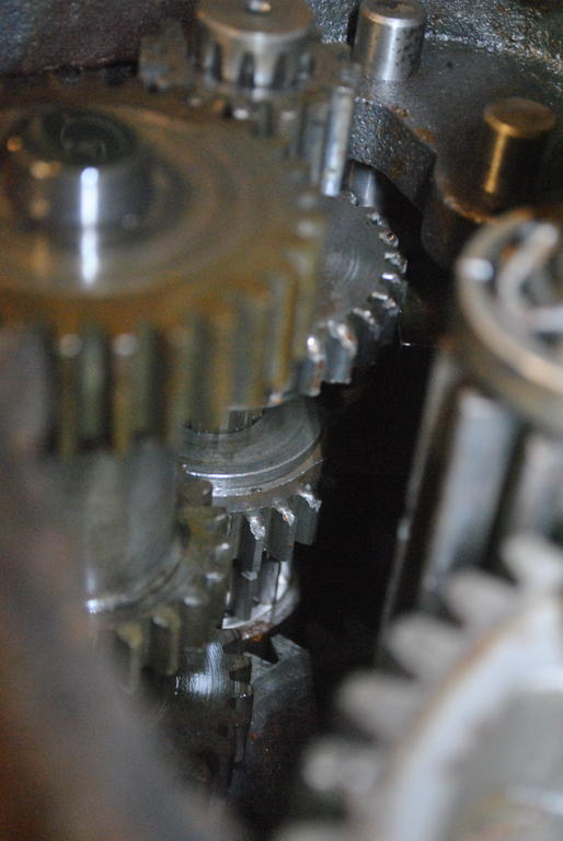

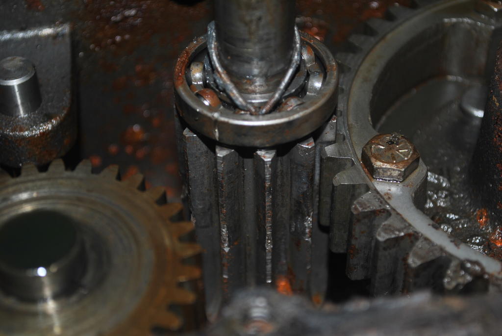

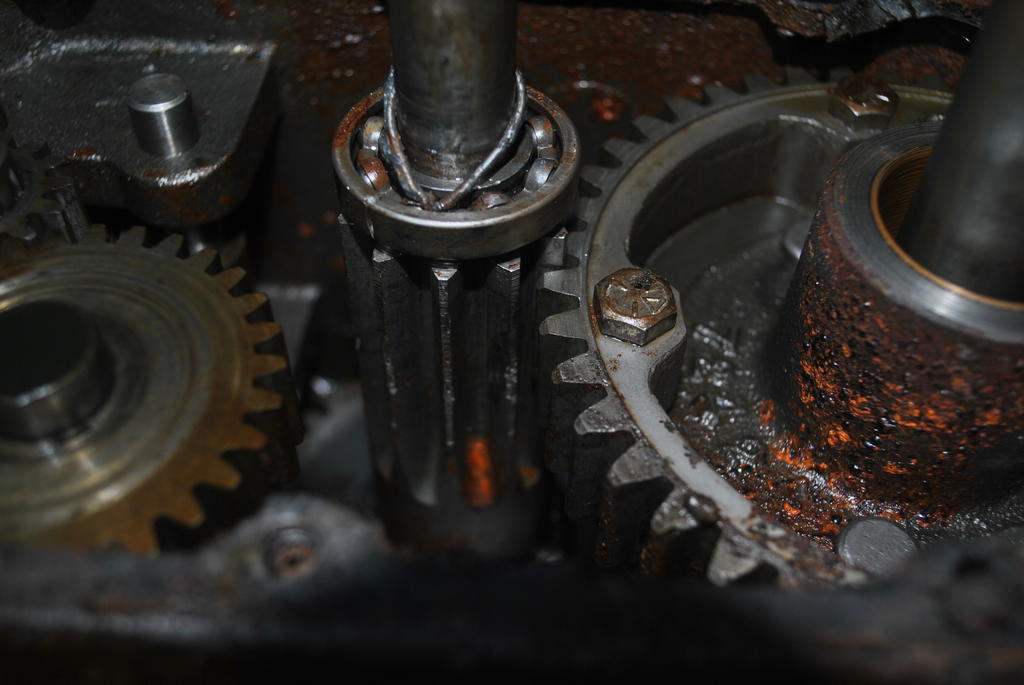

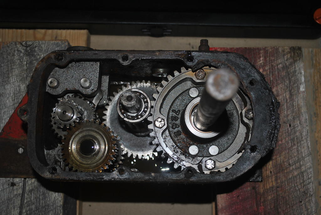

Horse Play 393 #24 Posted May 21, 2018 OK, here's what I got. - The teeth on the small, wider brake shaft gear are chipped in the center. - The teeth on the cluster gears are damaged on the left-side of the gears. This is the first time I've opened a transmission on anything, so I'm not sure on what to do next! Share this post Link to post Share on other sites
stevasaurus 23,557 #25 Posted May 21, 2018 At this point, I would take it apart and clean it out, wire wheel the rust off the gears, replace the seals and any bad bearings. There are some good videos in this thread and a link to the manual below that. great pictures...someone has been in here before. It looks like your differential was replaced, you have the newer model with the bolt on drive gear. 1 Share this post Link to post Share on other sites
