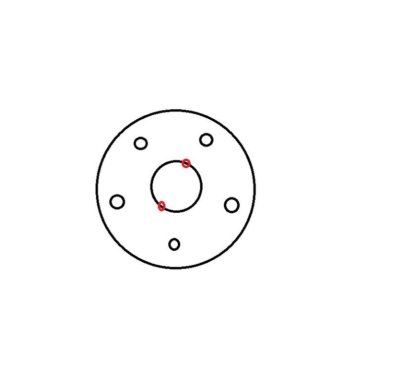

wallfish 20,744 #25 Posted May 7, 2018 Up hill the key grabs the sloppy worn hub slot, down hill the key is forced to the back of the sloppy hub slot then surges to the front when it levels off. Flat ground while turning, it's gonna do the same thing as going down hill. The key isn't sheared off, yet. But if one or both of the hub slots are worn, it could cause this condition. That pin Jay suggested is a good place to start too but it seems belt slipping would probably happen more while going up a hill. Could a cracked frame at the trans also cause this condition? IF, the axle and hub key slots are worn. Could you just drill and tap holes 1/2 way in each piece then lock it with long set screws? (backyard hammer mechanic style) Those axles may be hardened and tough to drill. If so, the drill bit will want to drift into the softer hub. Probably not the proper fix but to me if both pieces need to be replaced anyway, no harm no foul. Hopefully the axle is good and replacing the keys and hubs will do it. It could be just one side. Just kind of "thinking out loud" and typing it. 1 Share this post Link to post Share on other sites
