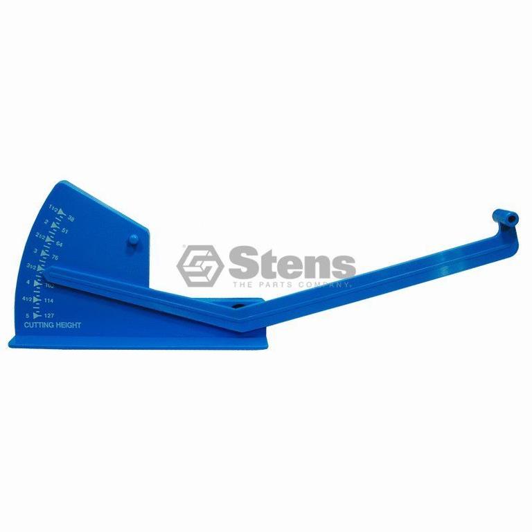

I bought one of these to measure cut height.

If you have a John Deere dealer near you they usually carry one of those cutting height measuring devices in Cleats post, just yellow not blue. I think it's the best way to take the guessing out of adjusting any riding mower deck. It will tell you if your deck is level, your blades are level front and back, left to right, if your deck is warped, a blade is bent, a spindle is longer than the other. You can get them online cheap. If you do your own deck work, get one :handgestures-thumbupright:.

I bought one of the blue height gages shown above.  The base of it was so warped that you could get any reading you want.  I put screws in the four corners of the base to calibrate it.
