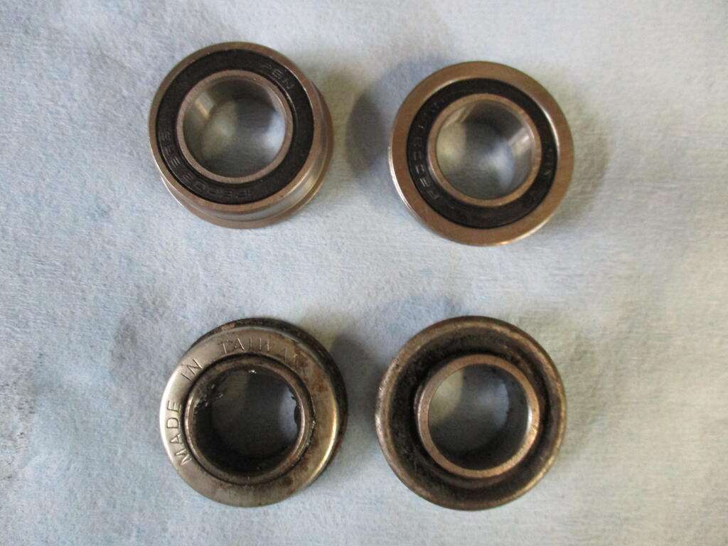

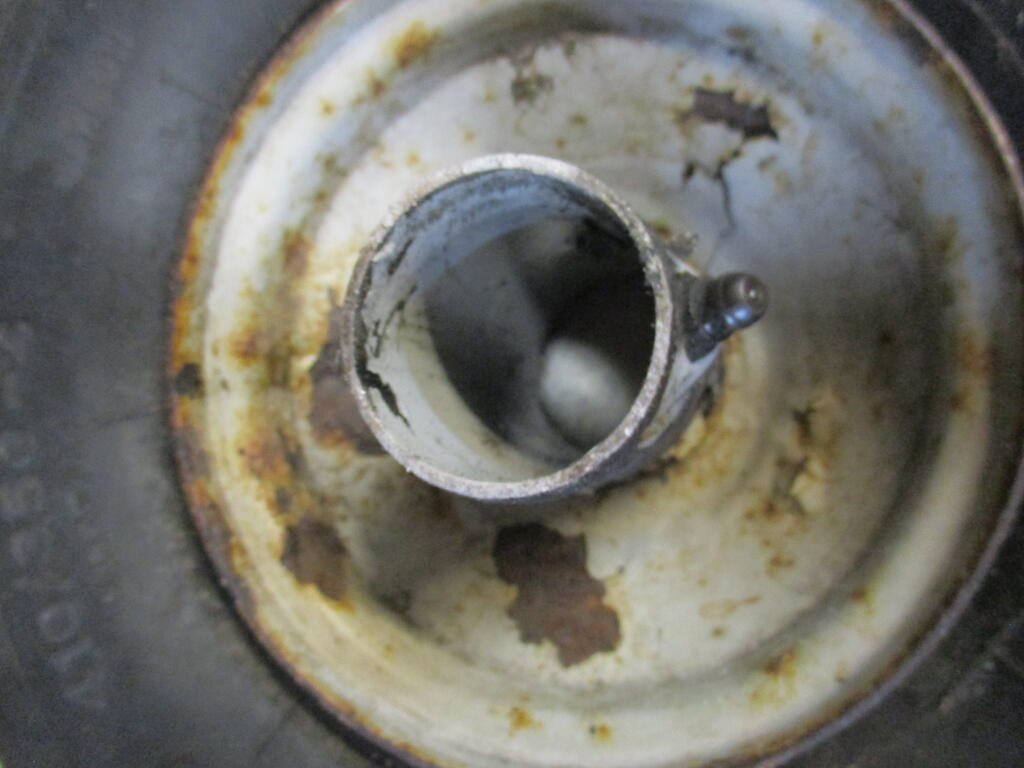

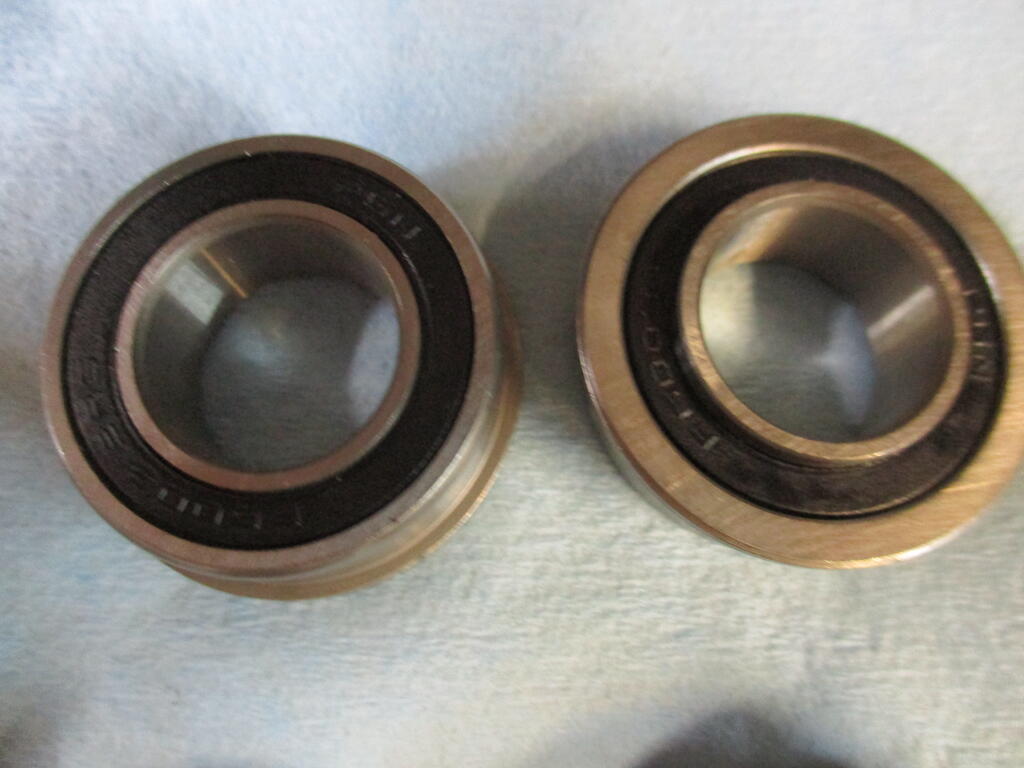

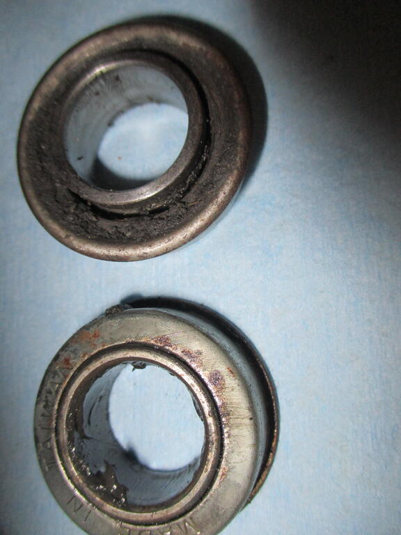

I have decided to upgrade the wheel bearings on front wheels of Rear engine rider. The original flange "bearings" are Taiwan lets call flow through not sealed . The hub of wheel has a grease zerk and entire hub fills with grease until it flows through bearings and out side. I have purchased a sealed flange bearing and cannot decide if I should pull the shields and just pump it up till it flows through or flush out and pack with Pete approved Lucas high pressure and replace seals and not use zerk anymore. What do you geniuses recommend? I realize I would have to regrease on some maintenance interval either way.

IMO, the sealed bearings are the way to go.     They keep the grease in where it is needed and keeps the dirt out.   No need to fill a wheel hub with a pound of grease that makes a mess.       The low RPM of these sealed bearings should insure a long life.

I use the sealed bearings also, I  just clean out the grease that came in them and use red and tacky grease and close them up again. They don't put very much grease in there to begin with.

Is that what you call that substance they use?? I've seen what looks like wax, not grease in new sealed bearings... That stuff comes out in chunks & does not wash out well at all....
