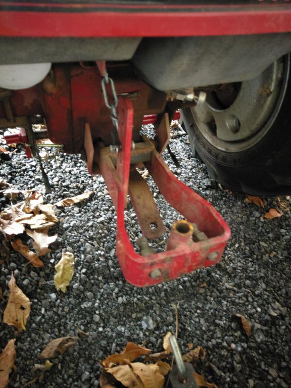

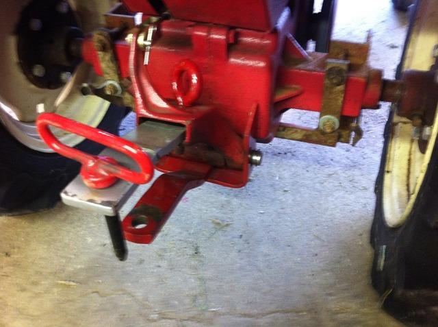

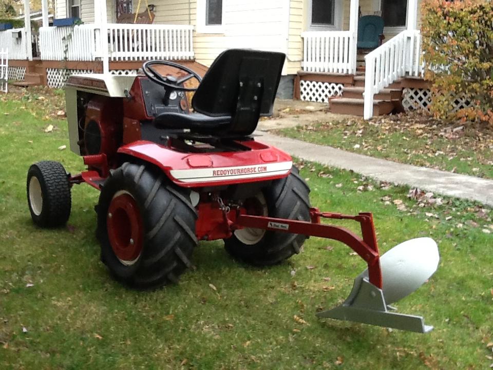

squonk 47,412 #2 Posted April 29, 2018 (edited) All you need is a std. slot hitch that came on the early Horses. Bolts right on the rear pin on the trans. Then a lift cable to the lift rockshaft. This is on a C-145. Then a old WH slot hitch plow and your all set! Here's another but blurry pic on my 1267. Same thing as your 300 Edited April 29, 2018 by squonk 2 Share this post Link to post Share on other sites

squonk 47,412 #4 Posted April 29, 2018 Yes. You need to run a lift cable to the back. Share this post Link to post Share on other sites

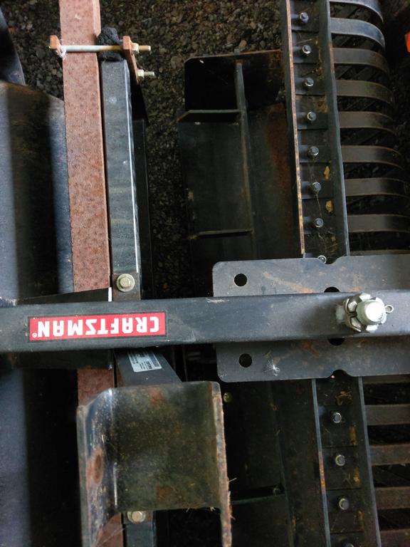

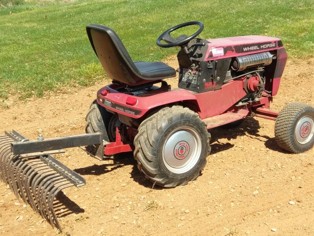

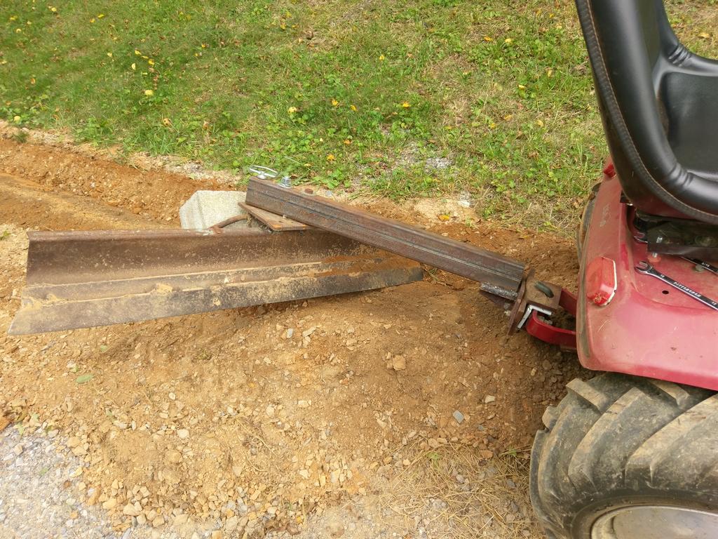

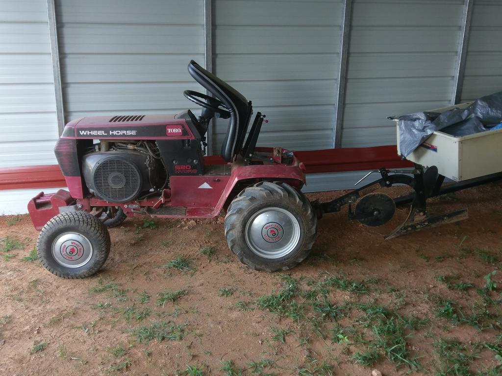

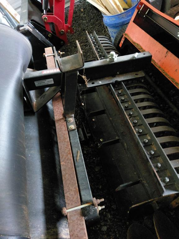

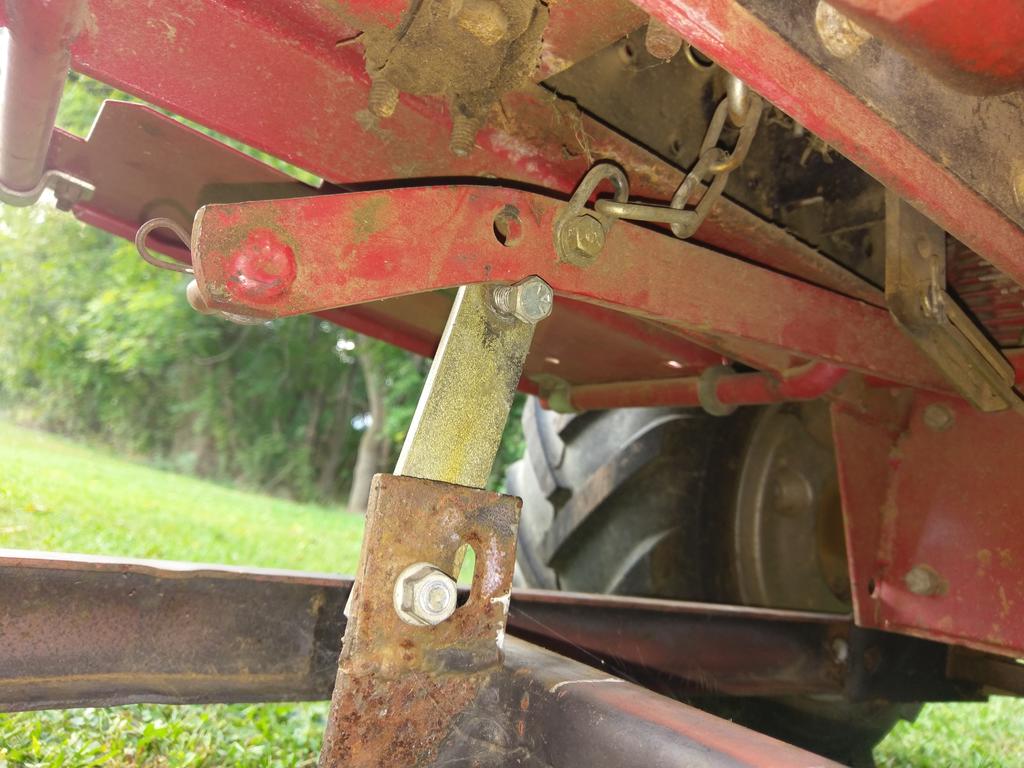

WVHillbilly520H 10,378 #5 Posted April 29, 2018 The B,C and 3,4,500 series are all basically the same tractor frame/ attachment wise, the newer version of the slot hitch is the "clevis" hitch which opens up more universal implements like you are referring to usually sold under the "Brinley" name or by Sears under the Craftsman name there's a couple others like Agri-fab and Ohio Steel, here's a couple pics moldboard plow, disc, York rake, rear scraper/box blade ect, the rockshaft is what the lift arm (if you're manual) rotates between the frame rails to raise and lower the deck but shown in my last 2 pics of a hydro but basically the same the last pic underneath shows the chain going from the deck/floating snow plow lift arm to the rockshaft you can see the small clevis (center right of pic) on the rockshaft that is the cable that goes out the back over the transaxle to the rear lift unit whether slot or clevis, hope this helps, Jeff. @wheelhorseman can help you with getting the correct complete rear clevis hitch kit. 1 Share this post Link to post Share on other sites
