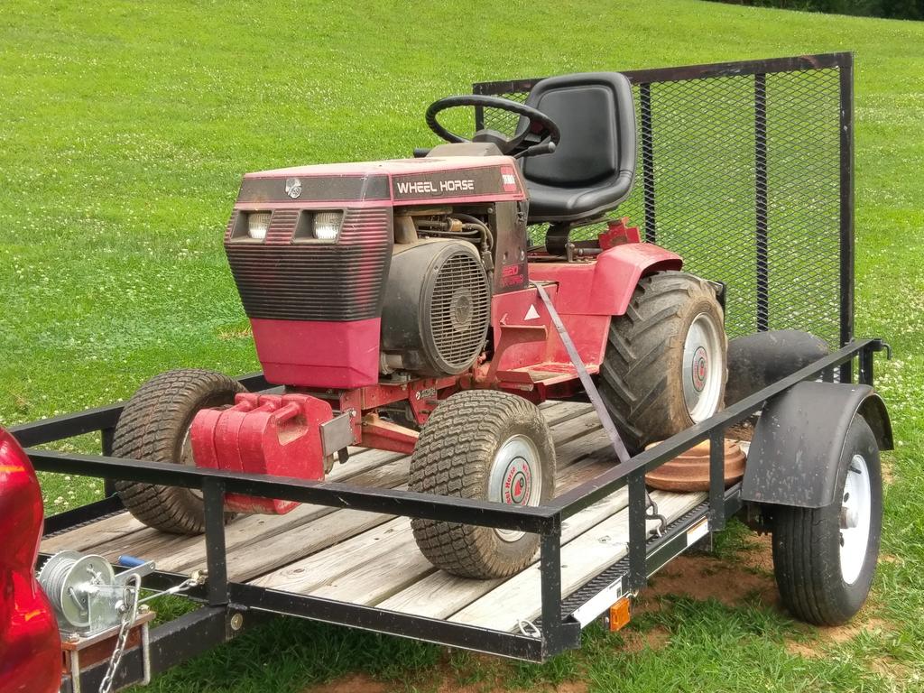

SPINJIM 1,997 #2 Posted April 24, 2018 My steel trailer has 3/4" marine plywood. It's about 12 years old, and the deck should still have another few years in it. Jim Share this post Link to post Share on other sites
Achto 32,857 #3 Posted April 24, 2018 31 minutes ago, SPINJIM said: My steel trailer has 3/4" marine plywood. It's about 12 years old, and the deck should still have another few years in it. Marine plywood would be excellent, only down side is that it is around $90 per sheet in my area & you would need two of them. I would go with the 5 quarter X 6 deck boards again. Maybe clean up your metal support rails & spray them with Flex Seal or a good under coat before laying the boards down on them. I usually treat the deck boards on my trailer with a sealer every other year. They are about 6yrs old & have rarely been under a roof. They seem to be holding up well. 3 Share this post Link to post Share on other sites

WVHillbilly520H 10,379 #13 Posted April 25, 2018 I vote for the 5/4" treated, try to find the driest ones you can, when I redone the deck on our home I bought extras and let them "dry" out over the summer before I got around to installing them over the expanded metal floor (which is not a heavy enough floor) on my TSC special, I left extra spacing between my boards so water/snow will drain faster(a tarp could be put down for mulch hauling) as well as added 8 "D" rings for extra tie down points, Jeff. 3 Share this post Link to post Share on other sites

MoreyToo 68 #16 Posted April 25, 2018 I went to a local sawmill and had him cut White Oak planks for my trailer. They are heavier and harder than treated pine boards but are very resistant to water, abrasion, rot and insects. I treated mine with used motor oil/fuel oil mixture. Most commercial flat bed trailers that have a wood deck are made of white oak. 4 Share this post Link to post Share on other sites
