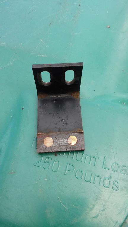

Cadmandu 67 #1 Posted April 24, 2018 Hi all Happy Spring Last year I posted about my tractor running off with me 40% of the time that I would go down my very steep hill in the back yard. Yesterday I changed my drive belt and found out that the 82" belt was a 1/2" wide instead of 5/8" and it had cracks in the side every 1/8" I'm sure that this was the problem. While removing the old belt I found a L shaped bracket above he pto with a break pad see below. I have a 89 312-8 can I buy one of these and what is it called? I have a new brake lining to install also what adhesive should I use? Thanks Share this post Link to post Share on other sites
WHX?? 57,496 #2 Posted April 24, 2018 That bracket is a 110665 (94-6652) and can be here https://www.repairclinic.com/PartDetail/Brake-Lining/946652/1850844 or here https://www.partstree.com/parts/toro/mowers-lawn-garden-tractor/31-12ke01-312-h-toro-312-h-garden-tractor-1990/pto-clutch-and-control/ This is just a brake pad to stop the PTO attachment quicker. Most just use silicone adhesive or gorilla type glue to hold the brake lining on clamp and allow to dry. Can use Goop or contact cement as well per @rmaynard 1 Share this post Link to post Share on other sites
Cadmandu 67 #3 Posted April 24, 2018 Thanks is it important that I replace the brake assembly on the PTO? I have the yellow foamy type of gorilla glue will that work. Thanks for the link do they sell blades for a 42" cut c120 deck 5-1011 Share this post Link to post Share on other sites
WHX?? 57,496 #4 Posted April 24, 2018 1 minute ago, Cadmandu said: replace the brake assembly on the PTO? Only if you want the blades to stop quickly. Here is some more info on your deck. You should be able to take your old blade(s) to any competent outdoor power center and they should be able to hook you up. Or Ebay the Toro part no and you will find all kinds of them Any quality glue will work. 1 Share this post Link to post Share on other sites

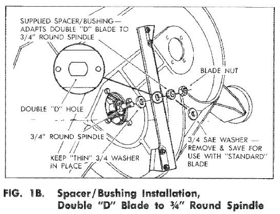

gwest_ca-(File Mod) 12,387 #9 Posted April 25, 2018 Check the blades you have for the size of center hole. If they are held on with a bolt and washer they should have a 5/8" x 3/4" double-D center hole. If they are retained by a large 1-1/8" wrench size nut they should have a 3/4" center hole. If the spindle assemblies have been replaced they likely got these later versions. Within the last year most suppliers have discontinued the double-D blades but you may find NOS (new old stock) at an established dealer. There was a bushing made to use a blade with 3/4" hole on a 5/8" x 3/4" shaft but Toro wanted more for the bushing than the blade. Will see if I can find the info on it. Garry Share this post Link to post Share on other sites
gwest_ca-(File Mod) 12,387 #10 Posted April 25, 2018 Guess I got it backwards but don't understand how you can place a bushing with a 5/8" wide hole on a 3/4" shaft. Bushing is part number 109916. Do the 3/4" shafts not have a 3/4" thread? Garry Share this post Link to post Share on other sites
