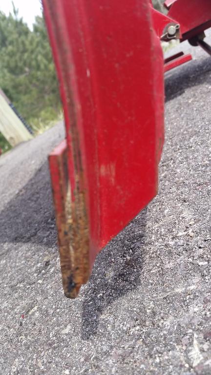

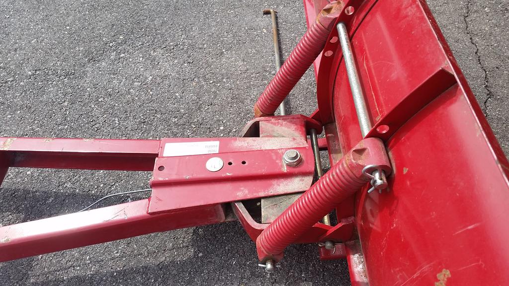

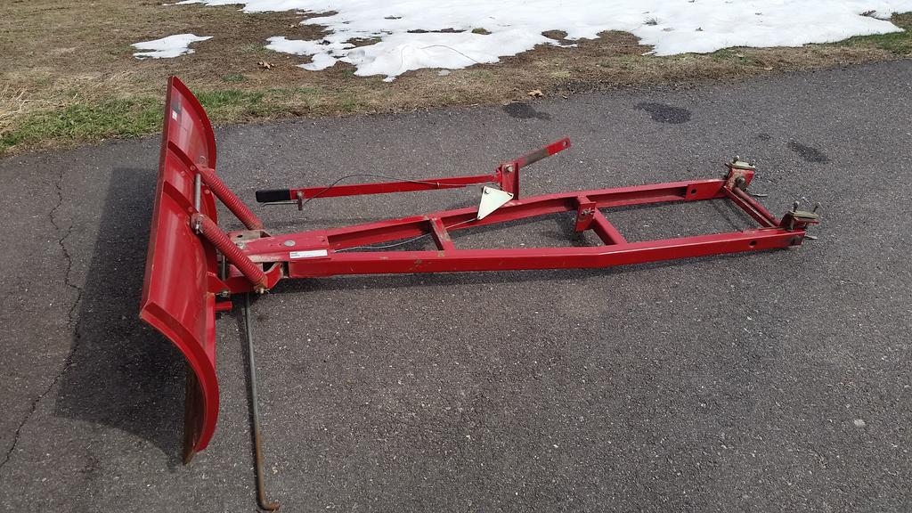

I really got to find me a blade, that is a nice one!!
WHX??
It is Randy, no rust at all on it so might mean it was never used to push snow. Wear bar isn't even broken in. Against my better judgement but this one will be going in classifieds. Be nice to have but will probably never use it.

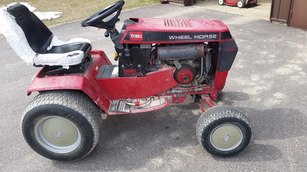

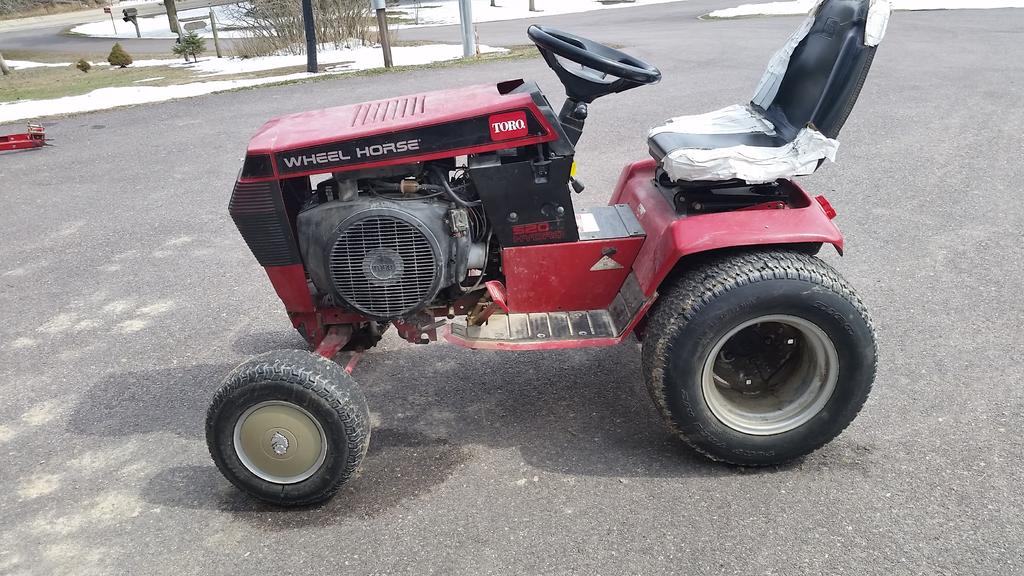

The good... 2k & some odd hours
7 hours ago, WHX17 said:
none of gauges work,
Not as bad as you had been saying, but the hour meter stopped at the same time as other gauges! However, if the key were left on the hour meter could have run?  Important thing is it runs well.
:text-coolphotos:        Should clean up well.

I'd like to see that blade mounted on the 500. I didn't think that style angle adjust lever would work on the 3,4,500 series. :)

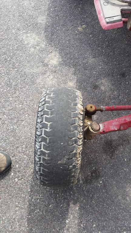

Nice tractor.Looks like everything wrong can be repaired.How the hell did the last owner wear those tires out? Did he run a 50 lap modified feature race on blacktop?Have fun with your new toy.
  • Thanks 1
  • Haha 2
cleat
Front tires likely wore out due to bad alignment which may also be causing your steering issues.
Every tractor I have brought home has been badly out of alignment.
I know these are not high speed machines but alignment is still important.
When you turn the wheel then let it go while driving it should pretty much return to center on it's own.
I give around 1/8" to 1/4" toe in.

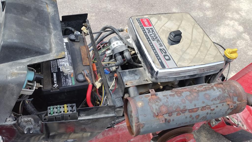

Hi Cleat...............Look for signs that it may have had an FEL on it at one time.
Most badly worn front tires I have seen on the 520's wore an FEL for awhile that added weight and caused the front tires to wear-out faster than usual.
Not to hijack the post but...........I'm not a fan of the Onans but those air cleaner covers are always bright and shiny. As a matter of fact, I've never seen one that didn't clean up! I've seen 520's that looked like they were bathed in a caustic solution all their lives but the chrome air cleaner covers would look new!
Just saying! :D

That one should clean up nice, looks like a 97. I'll look and see if I have the correct hoop for the pto. Tires probably out of alignement, I have also seen tires wear out with the use of a sweepster on the front.

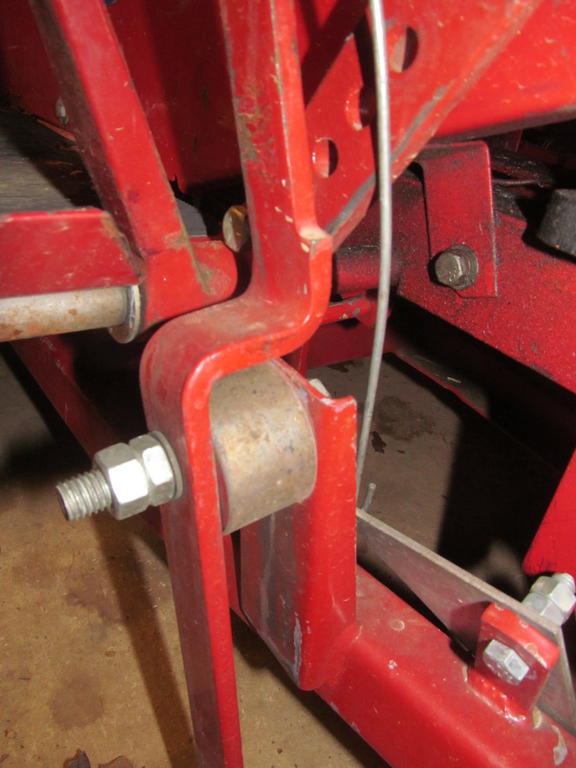

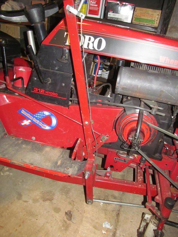

I think this is the arm I have on my 312.  I had to install a spacer to move the lever to the right.IMG_0066.JPG.dd9873b6219acafca3aaea9221d7a10e.JPGIMG_0067.JPG.6f4030c9e5ba404839240402b5ee43d5.JPG

Another nice 520 for your stable Jim!  It has its warts and wiggles but for a 21 year old machine that has been in service--not too bad.  Those attachments are really in good shape especially that blade!  Great acquisition!:handgestures-thumbupright:

missing the extension kit for the 520 on the plow, that's why you have the regular handle, lots of potential

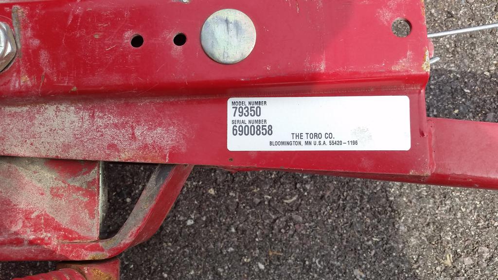

Yes correct Tom.....'97 No signs of an Fel ever being on it Boo. She looks like it was sitting next to a corn or flour grinder as it's covered in a fine white powder but should all clean off. Maybe was Scarface's tractor! :lol: Not much for grease/grime inthe engine area but steering gear a mess. My thoughts exactly on the high hour meter Richard..... key maybe left on? Battery was dead/toast. Tops of tires are canted in almost like the spindles  are bent. Plans are to eventually pull the whole front end off for inspection. Pull the factory tires off my go to 520 and a good excuse to get some V-61s for her.
Will have to be do some more checking on the fittment of the plow as  know nothng about them but willing to learn. Numbers on the plow.

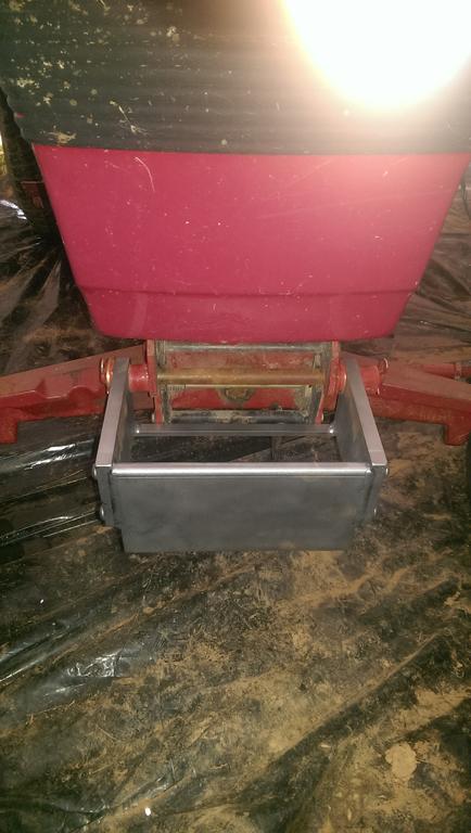

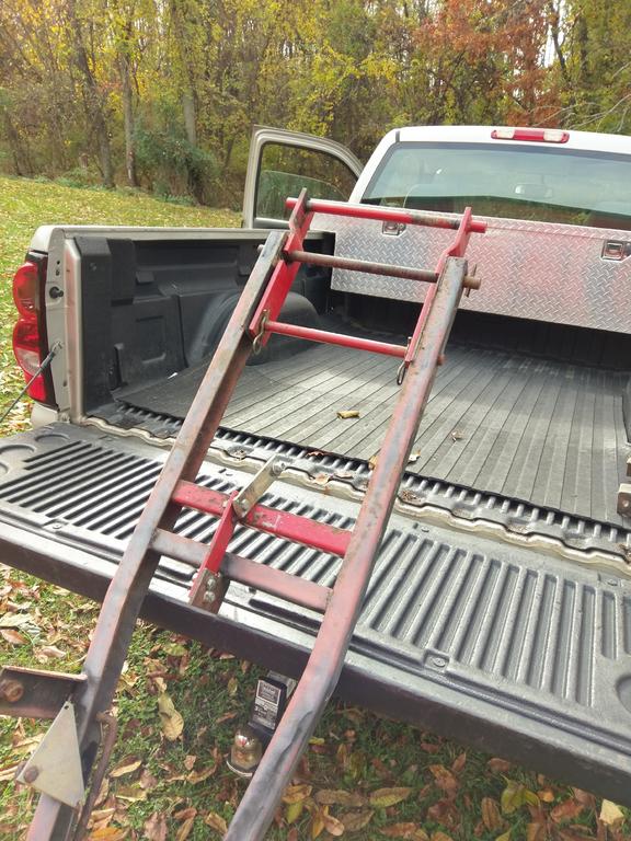

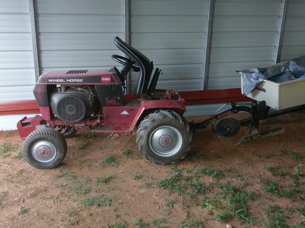

Here you go Jim...with this little kit it'll fit and be able to angle without hitting the front tires, or since you can't stay outta the furrows it could/should end up looking like this with some tri-ribs or a set of OTRs front AGs in 16x7.50 to match those 23x10.50 rears I know you got, plus I have an extra weight hanger available, Jeff.
Excellent. That gives me hope but the PTO on mine may interfere. I'll just have to give it a try. :)
