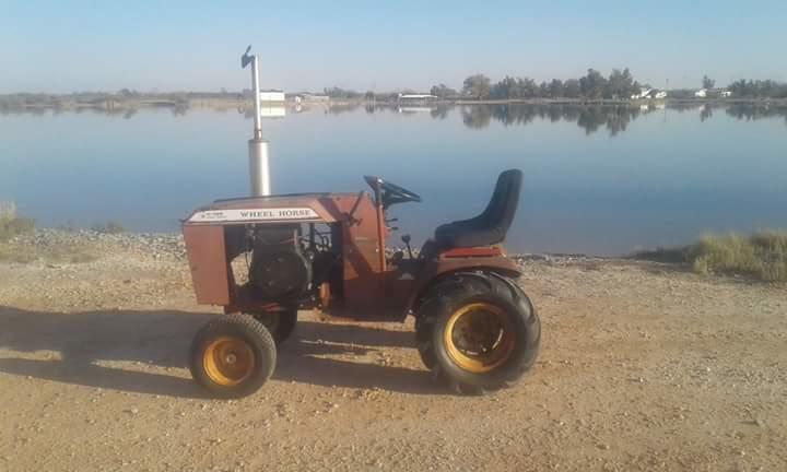

Skipper 1,792 #8 Posted April 17, 2018 (edited) It being for a yard business, raises the question: What will it eventually be used for? I mean, I second what has been said, but would like to add this: Hydro for mowing is sweet, and the hydraulic lift mid and rear is priceless. I would go for the biggest single cylinder for lowest maintenance cost, and I would not give a hut if its an early C or a 3-4-5 series. I would find one with an eaton 1100 rearend, and then I would strip all electronics and do a no nonsense wiring for reliability. Just my The big single will pull the 48" with ease, and till and what not without being strained. In my mind it is better to have power ENOUGH, than to have maybe adequately enough . I would suggest C-160, C-165, 414, 416 etc. Yes the 416 can be a single, albeit an 8 speed. (not saying twins are bad, just a potentially more expensive engine to service.) The above would make a rugged, plenty powerful, no nonsense, lowish cost/price gardening machine, that can last long and do most everything. Again, just my on this specific situation. Edited April 17, 2018 by Skipper 3 2 Share this post Link to post Share on other sites
