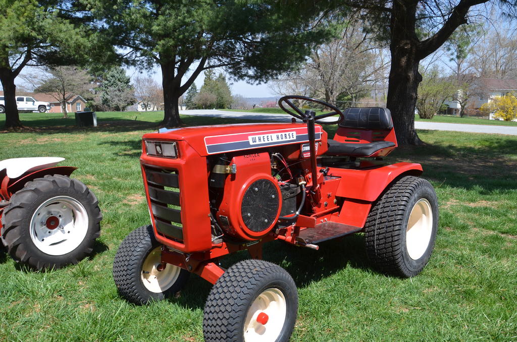

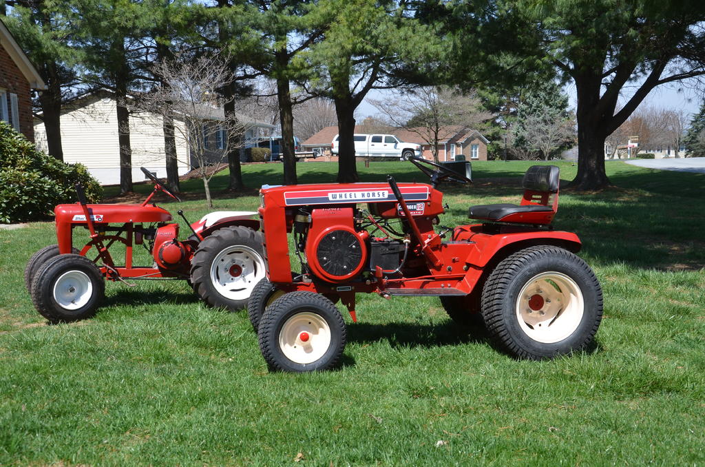

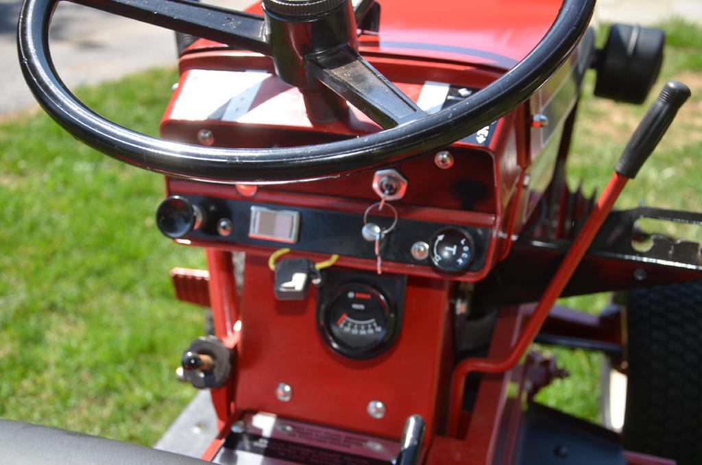

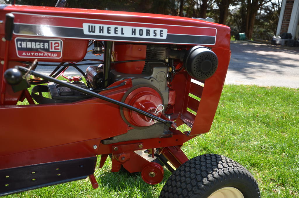

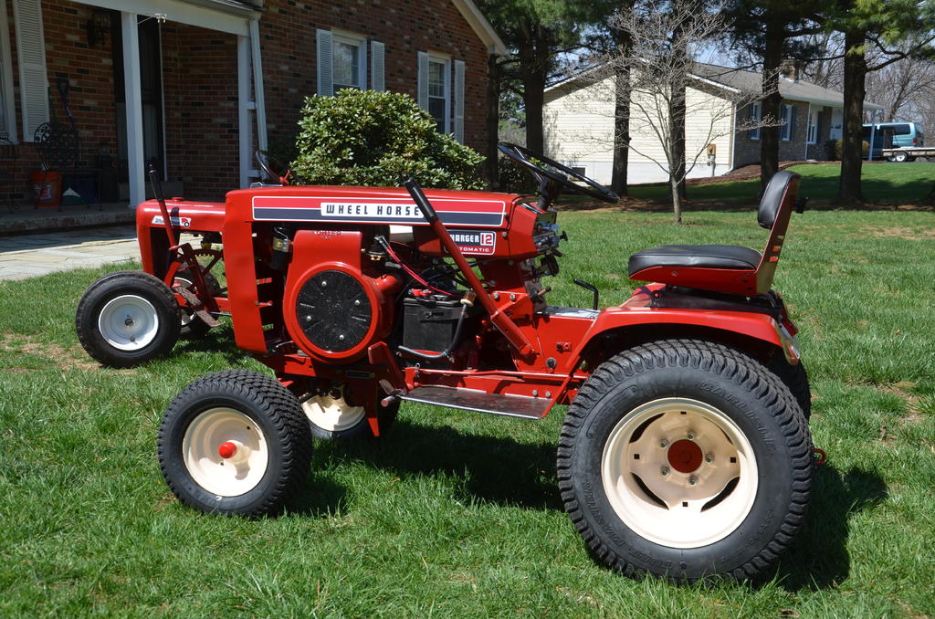

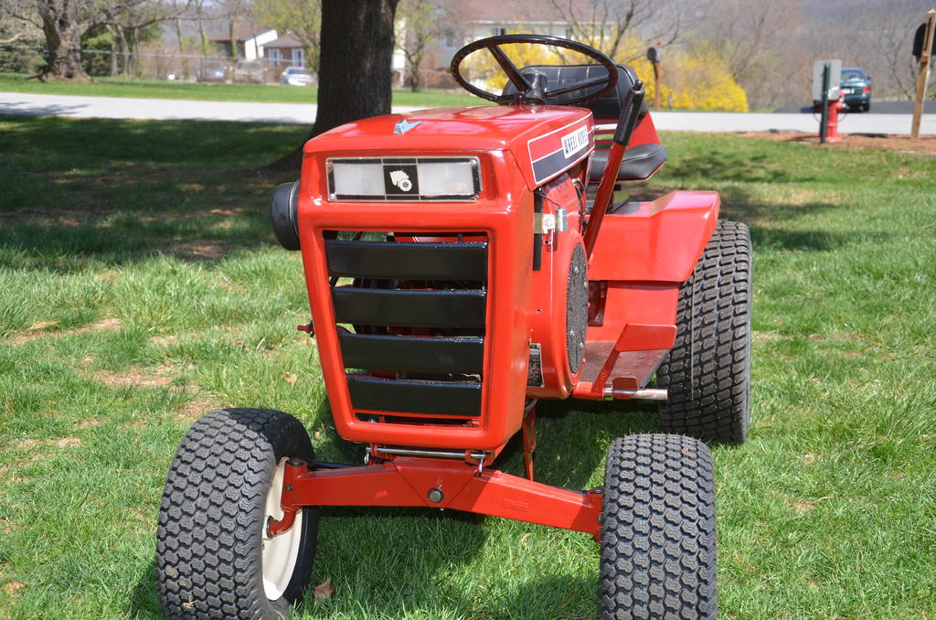

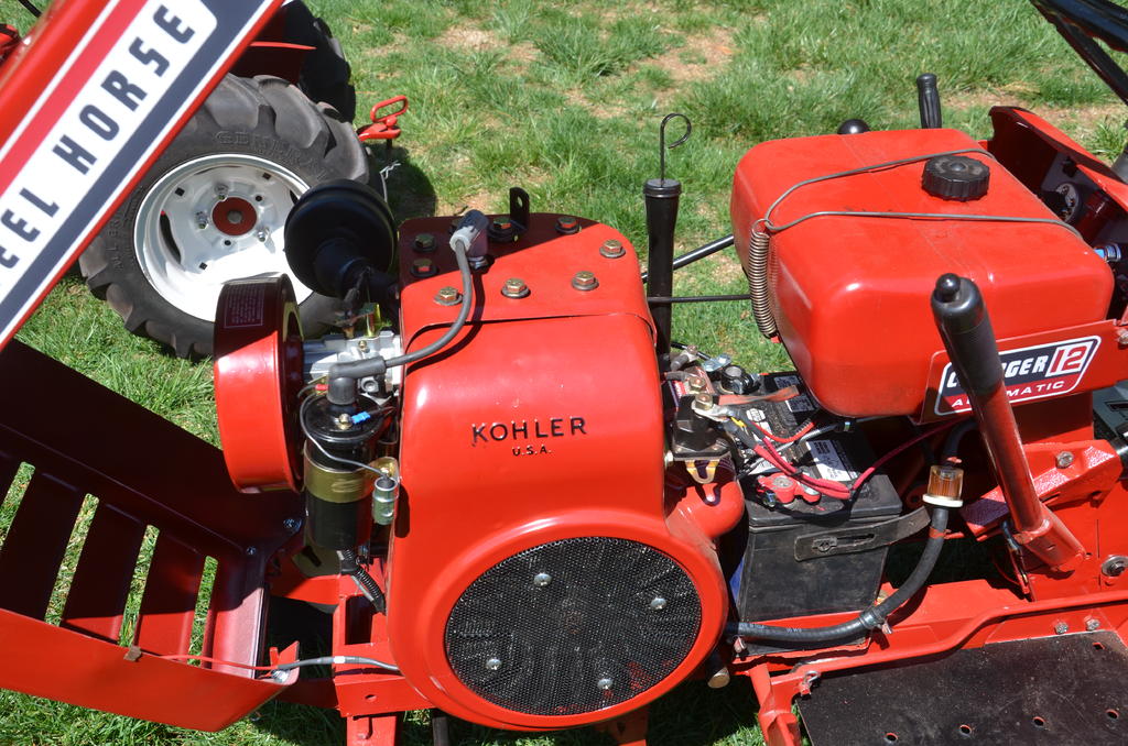

RJ Hamner
OK  You all wanted pictures.  Refill your glass and set back.  Here we go.   I SHOULD WARN YOU..THE LITTLE GUY IS A CAMERA HOG AND TRIES TO SNEEK INTO ANY PICTURES OF WHEEL HORSES
