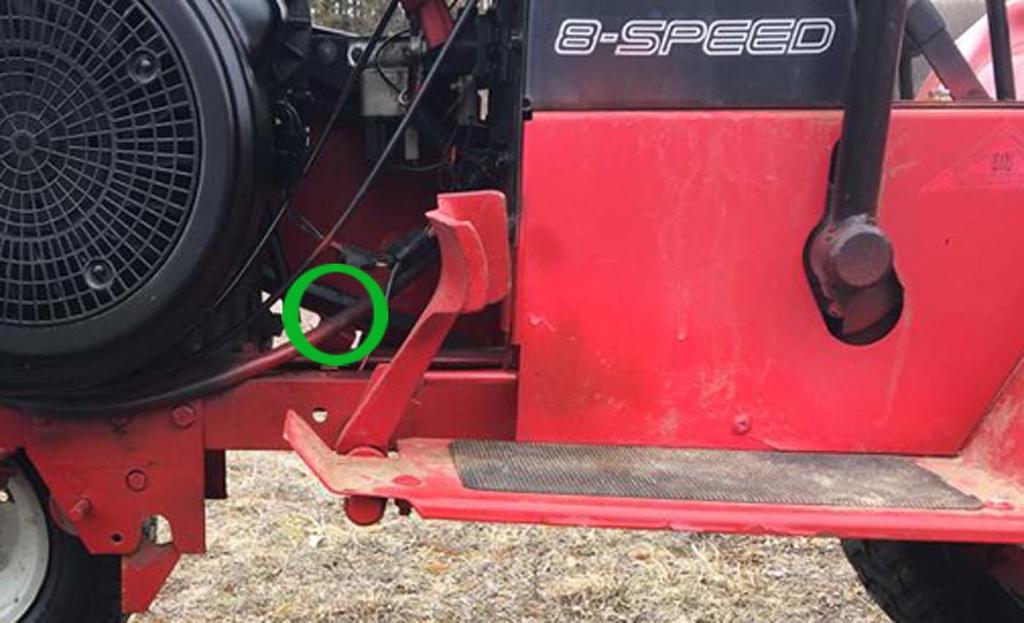

Jake0030 47 #1 Posted April 10, 2018 Thought I would ask for members opinions on a good inline fuel filter for my 312-8? Fresh out of rotator cuff surgery, so I'll explain why I switched out the gas tank another time(pain block just wore off, so typing hurts). The replacement fuel shut off valve I got did not come with the little metal screen, so I would like to add an inline fuel filter. I have installed many an inline fuel filter on other projects, but never a garden tractor. Would greatly appreciate feed back from other members on fuel filters they found worked well and where you put them? I'm planning on installing mine, or rather having a family member install it within the green circle in the photo below. Thanks in advance for feedback. 1 Share this post Link to post Share on other sites
953 nut 70,343 #2 Posted April 10, 2018 Hope your shoulder heals up rapidly. That looks like a great location, it can be seen so you know if it needs to be changed. I have always used the inexpensive clear plastic fuel filters and never had a problem. 5 1 Share this post Link to post Share on other sites
Jake0030 47 #3 Posted April 11, 2018 Thanks. I figured that would be a good spot just because of the downward direction of the line before traveling up to the carb. Hanging in there. 1 Share this post Link to post Share on other sites

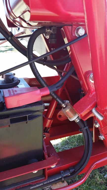

Anglo Traction 761 #15 Posted April 11, 2018 I use Kohler Fuel Filters (on my WH High mount Tanks)- The tapered upper end keeps down the risk of Airlocks. May be more difficult to avoid them with a lower tank position, but not impossible. 2 Share this post Link to post Share on other sites

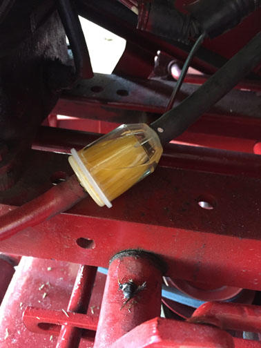

Jake0030 47 #17 Posted May 13, 2018 Need help. I think I mentioned I was at the mercy of a family member. This is what I ended up with. Said family member refused to fill filter before connecting and could not get the clamps on the line (although the filter is so snug in the line I doubt it will be a problem. The fuel filter never did fill up all the way and when I went to mow today, fuel filter completely emptied and engine died. Fuel filter is in correct direction in line. Fuel tank cap is vented. Any ideas? Thinking about trying to install the little red briggs and stratton filter when I can get a family member out here. Still have my arm in a sling and can't use both hands. Share this post Link to post Share on other sites
oldredrider 2,554 #18 Posted May 14, 2018 Try pressurizing the tank. Either blow into it or use a funnel and air nozzle on an air line from a compressor. 3 Share this post Link to post Share on other sites
formariz 12,381 #19 Posted May 14, 2018 Fuel filter does not have to be full in order for it to function properly. As long as there is some fuel in it (sometimes very little) it will work. Try @oldredrider recommendation but be careful if you use a compressor, i don't know how tight those lines are around that filter with no clamps. There may be some air in line due to cutting it for filter installation. I would pinch line with a needle nose vise-grips or something similar close to fuel pump connection, then remove it and then let fuel run into a container.Pinch it again while fuel is running and then put it back to fuel pump.Also fill the tank to top before starting it to help fuel pump. Under seat tank does not have gravity in its favor. Two hands will help to do all of that . 1 Share this post Link to post Share on other sites

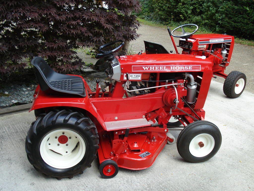

WHX?? 58,347 #20 Posted May 14, 2018 (edited) Small world here @Jake0030 but just had a wing clipped for said same rotator cuff. Doing good now thank you and hope the same. I would like to blame it on an old baseball injury but would be pulling yer leg. I use just the off the jungle site generics but change them yearly and put them as pictured. @Anglo Traction we may have seen that tractor before but me thinks we need to see it again! BTW whats with the petcock under the motor? Some sort of drain system? Edited May 14, 2018 by WHX17 1 Share this post Link to post Share on other sites
Jake0030 47 #21 Posted May 14, 2018 Thanks everyone. Well, I tinkered with the line. I could not budge the fuel filter from the line, can't use both hands. Trust me when I say, that thing is air tight connected. Disconnected line from carb and blew air through the line back to the tank. Could hear air venting out the gas cap. Tried blowing air into tank, again air vented out from the tank cap. Then sucked gas through the line, carb end. Yum, always wondered what gasoline tasted like. Got the fuel filter to fill mostly all the way, and got some mowing done with no engine kills. When finished, fuel filter was about 1/3 full. Haven't checked on it yet today. Still considering getting one of those little red brigs and stratton filters. Share this post Link to post Share on other sites

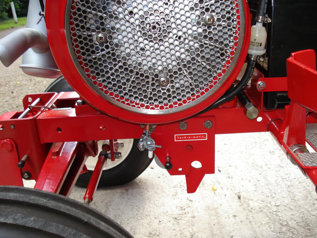

Anglo Traction 761 #24 Posted May 21, 2018 On 14/05/2018 at 4:14 AM, WHX17 said: @Anglo Traction we may have seen that tractor before but me thinks we need to see it again! BTW whats with the petcock under the motor? Some sort of drain system? Hi Jim, Apologies for delay in response to your question, only just seen it. The little Petcock is what I use to drain the Fuel system for overwintering. I also use it to re-prime the system in the Spring. By shutting the Tank Valve and pumping fresh fuel through the Petcock, it is sent to the Carb first. I then open the Tank Valve and pump fuel back up through the Filter into the Tank. As soon as it appears in the Tank, I shut the Valve(s) and fill at the Tank. Zero airlocks and ready primed system that prevents long cranking to start. The whole Fuel system is super clean, so no contaminates on the wrong side of the Filter. Here's a few images of the 74 WH after I fully rebuilt and fitted a 36" RD Deck....... sorry for deviating from the the Topic- Regards 1 1 Share this post Link to post Share on other sites
